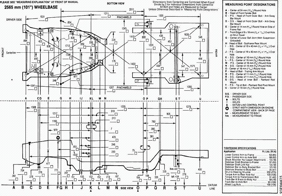

Hey guys (and gals), while I was under the car swapping my motor I noticed that a few joints didn't look quite right. I do not know the history of this car, because when I bought it the owner was a real retard. I think it may have been in an accident at one point because it has a different color nose. It has been repainted though.
My question is, how much of a hassle would it be to get the frame checked? I want my car to be as solid as possible before I get to far into fabricating anything. If it is off at all, it isn't much because I was able to have the steering aligned, and everything seems to still function OK. I have a rather solid body so i would like to know for sure.
Also, where would I go to do this? Thanks!

any good collision repair shop should be able to check it for you. not sure on price or anything else

go to a body shop and does frame repair....they should do it for free....all they do is check a few points on the frame with tram gauges

this might help

woot...I knew someone would post that picture! Thanks for the suggestions guys!
