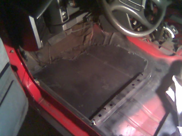

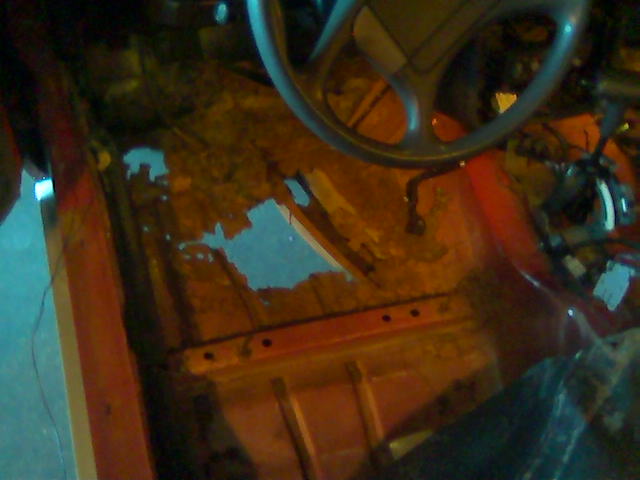

Things could be worse I guess, I thought that I had a small rust hole in my driver side floorpan until I pulled up the carpet. Yeah, it's terrible, but hopefully I'll get the new pan I made welded in within the next couple days. Anyway, sandblasting has worked best for me on rusted metal, but you do need to make sure and prime/paint the metals surface right away.

That looks like it rusted out from the inside. I would look for a water leak up top also. Is the frame rail intact? If you can get a replacement pan, it might work out best to cut it out and weld in a new one.

Yeah that's what I was guessing too because the passenger side pan was like new. The frame rail is fine, it just needs have all of the old floor pan chiseled off of it before I can put in a new one. Any ideas on where the leak would be that would cause this? It has t-tops, so would it be around there or around the door perhaps?

Yeah, it looks like a leak caused it. Floors that rot from wet shoes tend to be worse up by the pedals. This is more central in the pan, like it saturated the carpet and pooled up. It almost looks like it may have flowed from the kick panel side (upper left). Does the windshield look stock? Maybe its leaking.

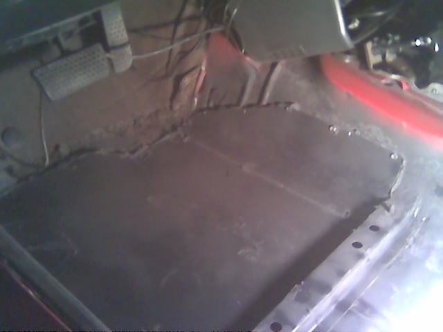

Ok, here they are, sorry about the quality...
Attached Thumbnails rust?????????-image002.jpg   rust?????????-image003.jpg   rust?????????-image005.jpg
Old Oct 30, 2007 | 10:12 PM
LIL BASTARD's Avatar
Joined: May 2007
Posts: 80
From: Vegas Baby
Car: 1985 Berli
Axle/Gears: stock Berli
Re: rust?????????
Very nice work. A floor pan doesn't have to be pretty, it can be a stop sign cut to fit, just get a sheet of steel and cut it to fit, bang it to shape, BFH's work very well. I've done alot of steel work, and it doesn't all ways look perfect, but once the finishing work is done it looks perfect. Doing the body steel is harder, but a floor is not something you'll see anyways. The hammer marks are covered by the carpet, and underneath by the undercoat. So you don't need to buy a replacement pan @ $400.00

I agree, good work on the patch - welding in new metal is the way to go.
