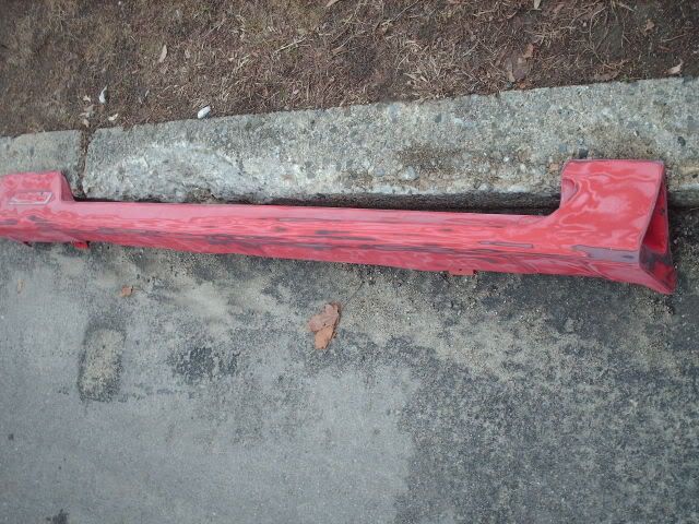

i have a complete 92 z28 ground effects kit i am looking to mount on my 86 base coupe. how do i mount the rocker ground effects on my car which never had any?
i have them all d.a.'d with 180 grit and ready to prime. please help!
there are the tabs on the bottom that i can screw into the floor, and on the fender edge i see that i can throw a screw in the side of it.

there is a bracket that is tack welded to the body from underneath that gives the main support of the rocker ground effects, you will need that for proper fit and finish of the kit, otherwise something custom could be made, just a little test fitting and modifying would probably have to be done to be made perfect. My suggestion in finding a correct one would be a junk yard. Ones around me move the cars around with a fork lift. Often screwing up the rocker ground effects, but not harming the mount that is tack welded to the body, and with the rocker ground effects broken from the forks, it makes getting to the bracket a lot easier.

what i did on my old sport coupe is i took i believe it was inch wide angle iron from like lowes and bolted it to the side of the car under the door. then i just drilled the quater panel hold and fender hole and adjusted the ground effect where it needed to go. Then i predrilled the holes and screwed them on. Worked great for me. Want some pics of how it turned out click the link.
If you have more ?s just ask me. Hope this helps -Matt
