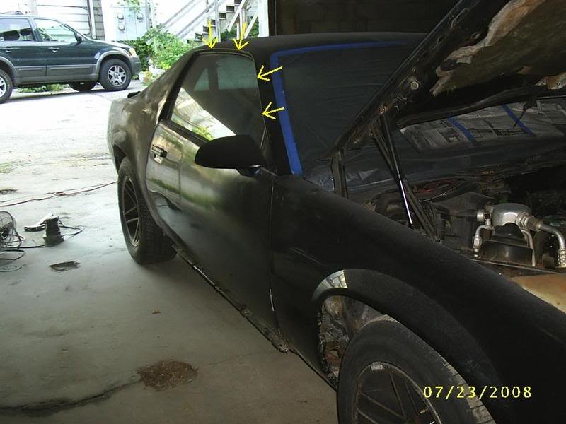

Im getting my Camaro ready for painting and I cant figure out how to remove the plastic peice that goes over the roof where the drip rail on most cars would be.
It feels like its screwed on but i dont see any screws. Anyone have a clue on how to remove them?

I dont think its a t-bar, its a thin piece of plastic that runs the roof line just above the door window.
Its not on the window but on the body just above the window
The piece in this picture

do a search for "drip rail removal". I think theres a few screws under the weather stripping but I may be wrong.

I just took mine off the other day and it was screwed on with the screws being under the weatherstripping. I destroy the weatherstripping in the process but it need replacing anyway.

I got it off, i think im gonna leave it off, looks alot better imop.
I tore the weatherstrip just a little bit, but i was looking to replace them anyways.
Thanks for the help.
