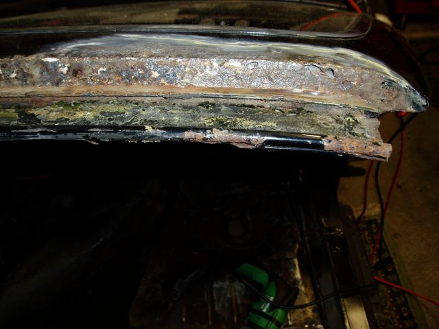

Yeah exactly. I had similar rust and I let it go. Here is what I'm fixing now.
