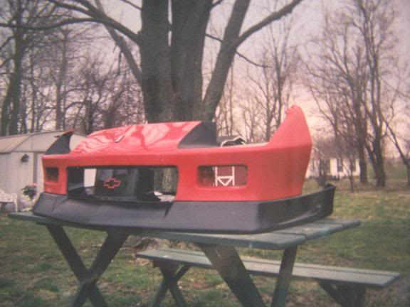

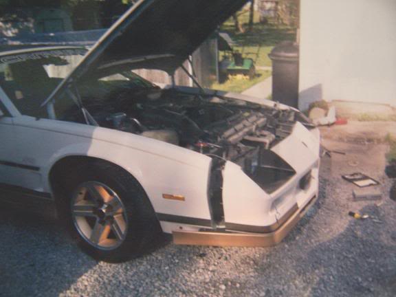

I did that to my first Z28, here are a few pictures:
Also, i had to cut a little of the front bumper absorber in order for the 85-92 bumper to fit perfectly.
