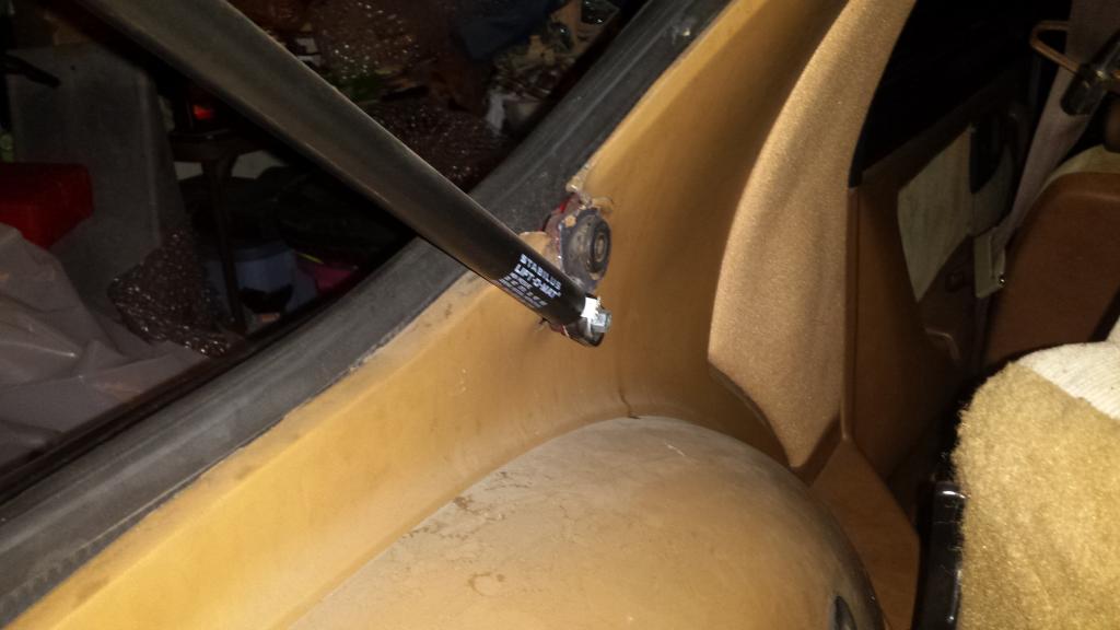

Notchbacks do use a different strut. The notchback strut is longer and the ends are different. Good luck trying to find them.
I use a standard firebird strut mounted upside down, with some Ace Hardware shoulder bolts. It might not be factory perfect, but I like spending $30 instead of $80 per strut.
Did you bolt the shoulder bolts into the fiberglass hatch, and remove the old mounting points on the hatch?
All the mounting hardware was already removed by the PO. 75% of ALL interior hardware was removed by the PO.
