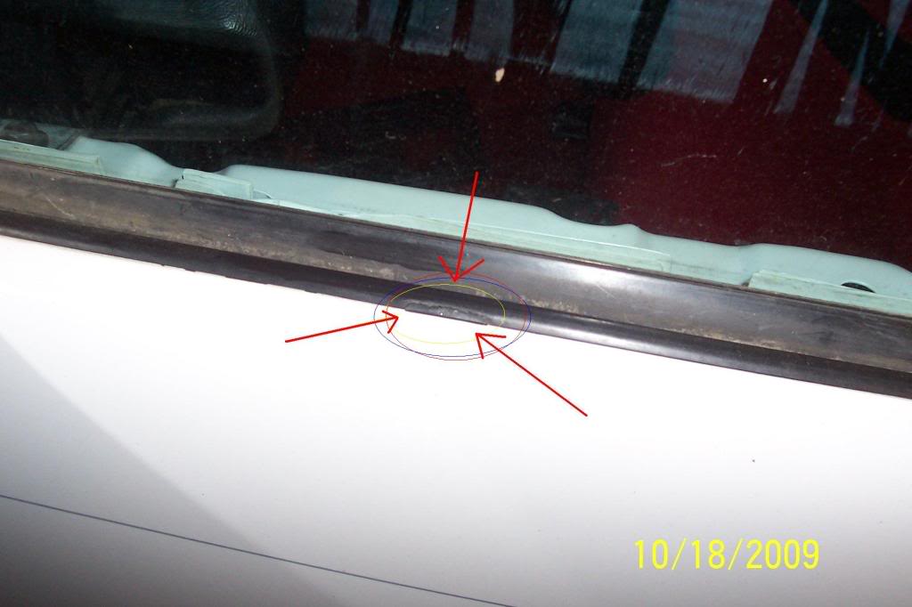

picked up a factry GM outer window sweep.(from GM $48) my sweep has a small nick in it..(it's a car show thing) you can see it ..but i know it's there..
any way, do you have to remove the glass to install it..
(yes door panle, and every thing is off) would have to go out in the shop to take a look. but will just ask the guys who have done them ON THIS SITE, (forgive the 8 years of dust from sitting in a box)

you did it? with glass in or out?
as you can see i have the door Panle off (to press flat) it had a small winkle.. looks like ne now.
and i left it off so i could install the new window sweep..
so what did you do? was it a PAIN! or what.. every thing go in and out like it should?
