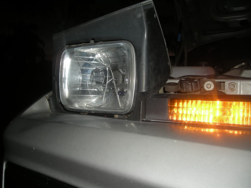

My 83 Has some sort of HID headlight system on it that the P.O. installed. My passenger side headlight is cracked and skews the light making it pretty useless. I am not sure of any brand or anything but they look like your common eBay HID set..
They have balasts and the lenses are glass. I am not sure what kind of bulbs they have or anything like that, but they put off a White/bluish hue when lit, that I like.
So, what I imagine is that I can replace just the headlight housings and keep the balasts/bulbs the way they are and I will be fine. I know nothing about these newer style headlights otherwise I would have them fixed by now.. lol
The sizes I see on ebay read: 4"x6" which is the camaro headlight size, and 7"x6" which sounds better but when I measured the ones on my car they were closer to 7.5"-8"x5".. Are they labeled 7"x6" just for simplicity, when they actually mean a size closer to what I measured?
Here are some pics of my headlights:
This one is cracked:
As you can see this one isn't cracked but it has condensation built up in it which I cant stand.
Lit up and picture taken with my camera flash on:
Rear of the headlight with the headlights off and closed:
Pic taken from under the car with the headlight on (Theres a random red wire just hanging there?):
Judging by these pics, can we determine whether or not either of these headlight housings will work? They look like the same headlights just sold with differently..

7x6 is the stock size for the birds. You can pick up a set of sealed beam halogens from any parts store for not a whole lot of $. Youre probably gonna hafta get stock headlight sockets though.

Looks like a cheap set of wanna be HIDs. youd be better off going to silverstar sealed beams. much better light.
Those arent even HID bulbs, just standard halogen ones looks like.

Silverstars burn at 3400K they look like "OEM" HIDs. OEM HIDs are normally 3400K unless you have a BMW or something, those are normally 6000K (more white). I use ICPW headlight conversion housings particularly CWC-7005. They are "plain" style they look like OEM sealed beams and they are DOT approved. Here's a link to the housings.

Typical OEM HID systems are more like 4300k, 3400k is very yellow in an HID light & 6k will give a fair amount of blue..Silverstar ULTRA are rated close to 4100k, standard silverstar k rating is a little lower.
Silverstars are very good for a halogen light.I would say its the closet you can get to HID light w/out converting.No yellow, just white, but its a warm white as opposed to a cool white color.However, silverstars dont last as long.In general the brighter the bulb, the shorter the life.Thats just the way it is.
Question: If your lights are not HID, why do have a ballast/s?

I said they were HID's, and I said that because they do have ballasts. I know very little about headlights, and travis said they looked like wanna-be HID's, so I don't know.

they look like standard halogen bulbs to me, but it could just be the pic....could have HIDs afterall
