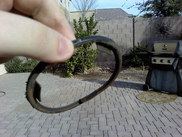

Crusty, possibly original, ring I pulled. Has the rubber cast around a metal ring with some metal retaining tabs.
