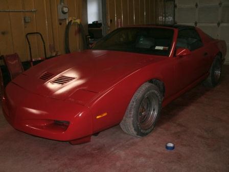

I stripped mine down to metal with a wire wheel because it had several layers of paint on it. I used the cheap purple gun from Harbor Freight. I used $29/gallon tractor paint from Tractor Supply that was sprayed in the gravel driveway of my old house. Basically, I did all of the "don't do thats" and ended up with this:
Perfectly smooth paint with absolutely zero orange peel. Are results typical? If you take your time and don't rush it you could have close to the same results. But, this was my second paint job. The first one produced similar results but the paint was poor quality (rustoleum) and faded rather quickly. There was a great deal of prep work that went into this before I ever laid the paint though, many hours with a long board to get the panels this smooth.
This is just to show what kind of results you can get with a "budget" paint job.
Paint material costs:
1 gallon Valspar Massey Ferguson Red - $29.99
1 gallon Naptha ---------------------- $13.99
2 8oz cans of hardener--------------- $12.99 (X2)
Total cost for just paint supplies-------$69.96
Sand paper---------------------------$50.00+/-
Purple gun----------------------------$15.00
Harbor Freight high speed buffer-------$30.00
Buffing pads--------------------------$20.00
3M polishing compound----------------$15.00
Masking tape--------------------------$5.00
Total cost of other supplies----------$135.00
My total cost for this paint job--------$204.96
I will be using the same paint and process on my convertible this spring. The only difference will be that I have a garage to paint in now.
