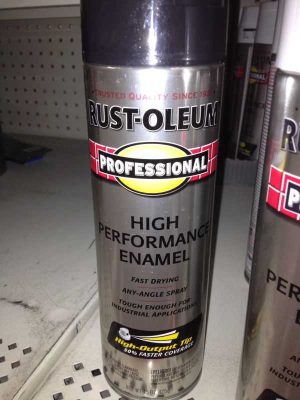

I'd like to get it painted unless you guys think it'll be okay left as is. It's not gonna be a show car, but I want it to remain structurally sound.
I have to choose primer & paint too. Prefer a spray type, but welcome opinions.

Please leave that garbage (Rustoleum) on the shelf, instead go with this:
Too small (at least for me) to read the make. What is it?

Re: How do I remove grease from rusty rear end & prep to paint?
Lacquer thinner
Eastwood Rust Encapsulator
Eastwood Extreme Chassis Black
