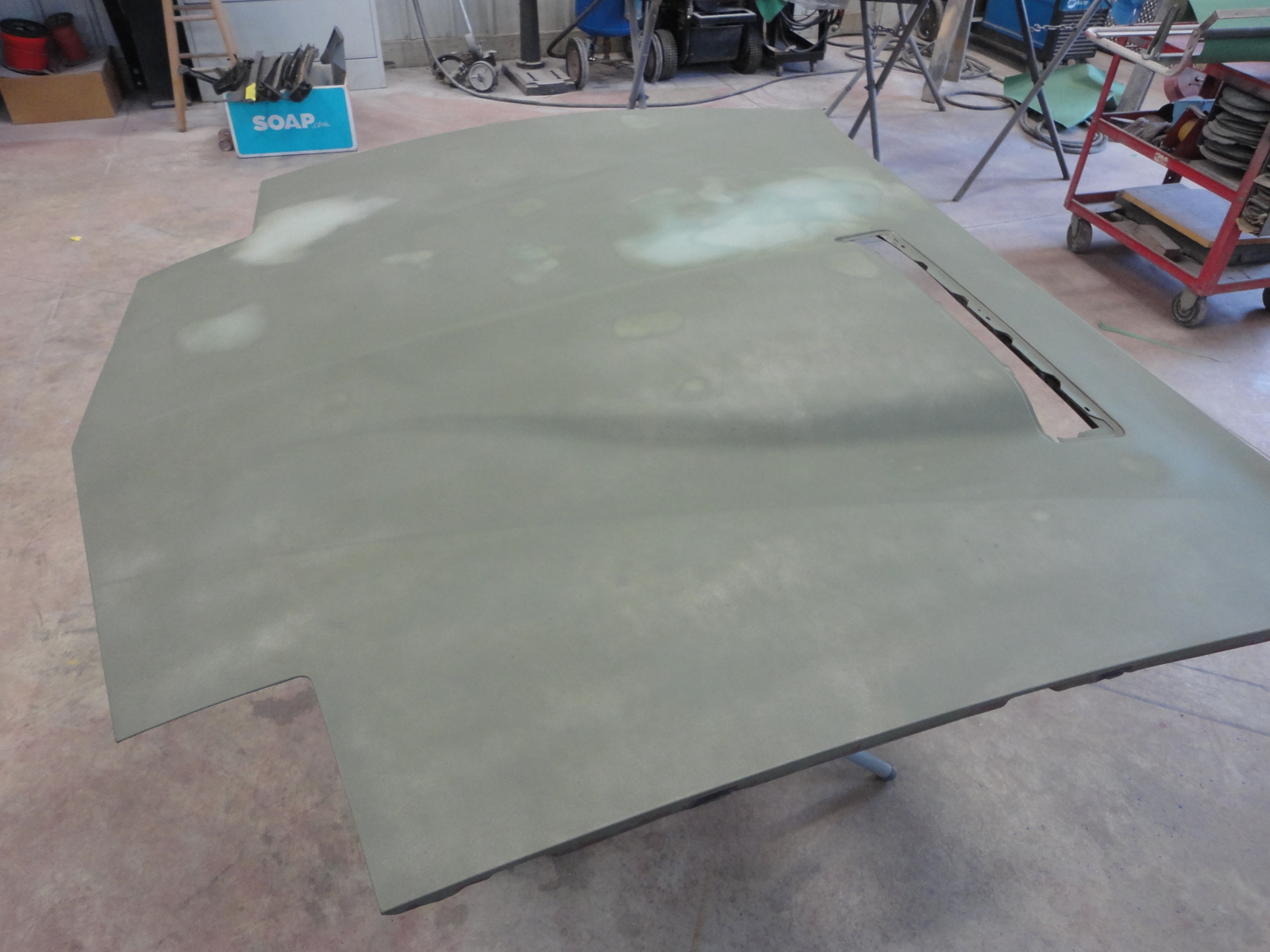

My semi-retired body guy used both.
Some spots where dings were excessive. Closed original holes on deck lid for newer '97 wing, and used etching there.
Chemical stripped the hood completely and etched, too
Attached Thumbnails Using etching primer question for experts-dsc00384.jpg   Using etching primer question for experts-dsc00386.jpg   Using etching primer question for experts-dsc00387.jpg

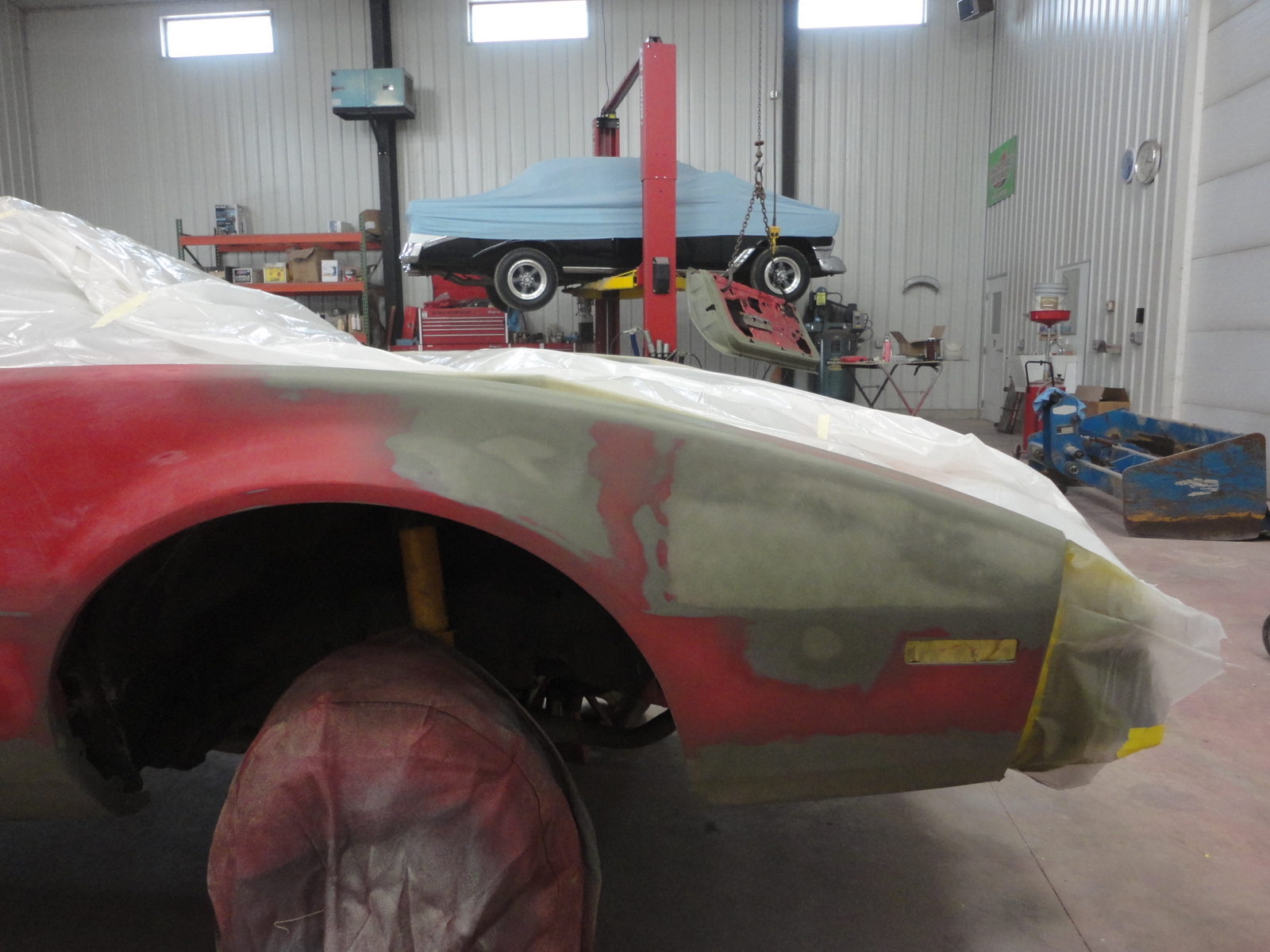

Re: Using etching primer question for experts
Paint should be on before Christmas!
Brian
Attached Thumbnails Using etching primer question for experts-dsc00380.jpg   Using etching primer question for experts-dsc00398.jpg   Using etching primer question for experts-dsc00473.jpg
