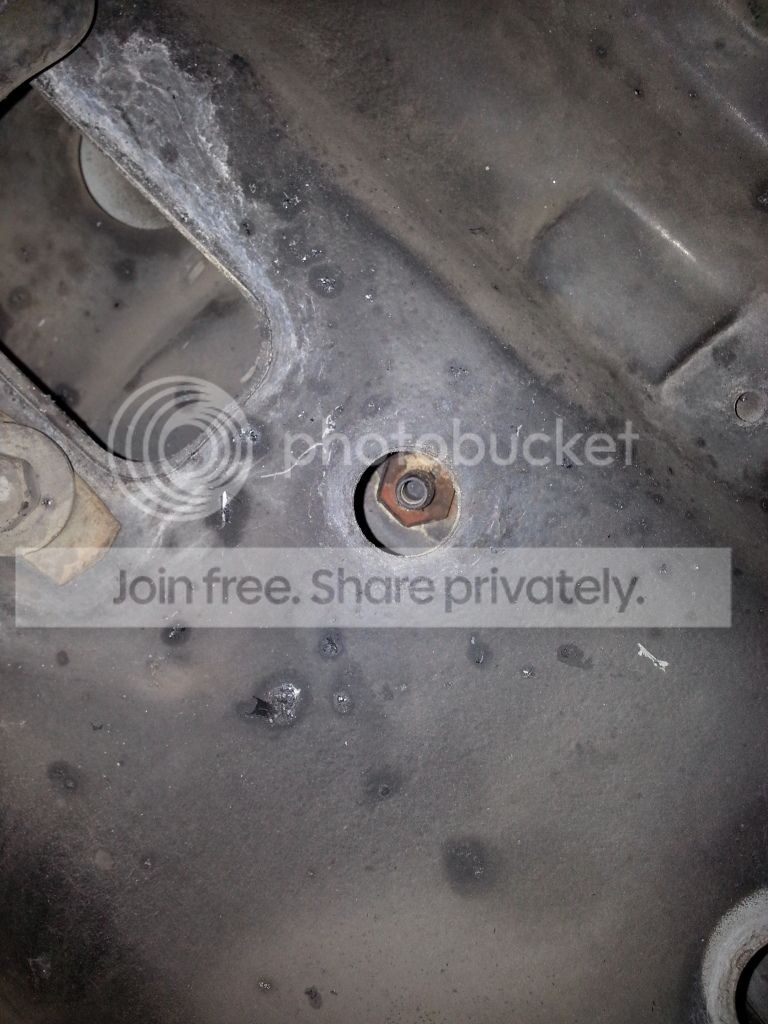

Need help removing the "hood grills" at the front of the hood.
I have removed these 2 nuts with a 5/8 deep well socket that are on the bottom side of the grills.
I need to get at the other two but the hole is to small for the socket can some share how you removed these?
I took a smaller, cheap socket and ground the OUTSIDE of the socket down so it fit INSIDE the speed nut.
Worked like a charm.
Thanks
