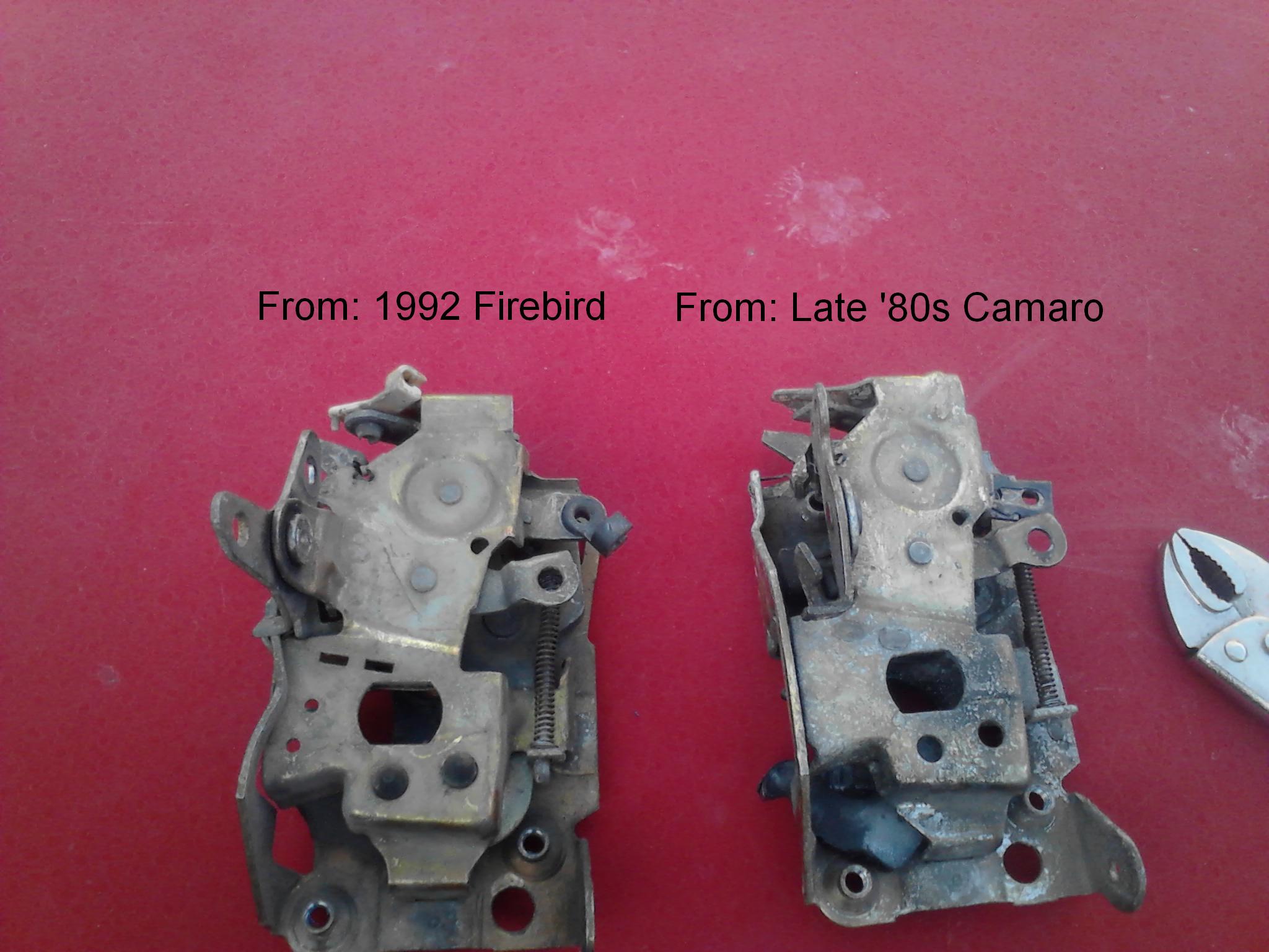

So my hinges were completey SHOT on my driver side door when I bought the car, and it sagged really bad. As a result the latch on my '92 'Bird is toast. Recently I repaired my hinges and stopped by the salvage yard to get a new latch. Looked like I wasnt the only one with that problem, as I took the last driver side latch from the 6 3rd gens there. Searching the forums I havn't been able to find a definite answer on whether or not all the latches are interchangable, so I took a chance and bought this latch from an '88 (or '87, don't remember) Camaro. There is slight difference, but it is more than possible for it to work.
For starters, here are the two side by side:

The rod that comes from the outside handle doesn't have a clip because the way its designed won't allow it to fall out.
I installed the older latch in my newer car and she opens and closes no problem and locks and unlocks without issue. Just making a straight forward thread with no speculation on this issue as I couldn't find a definative answer on it.
