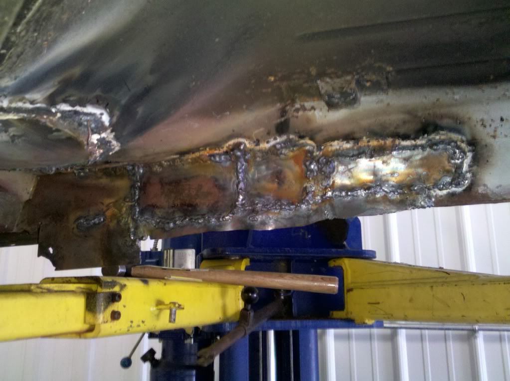

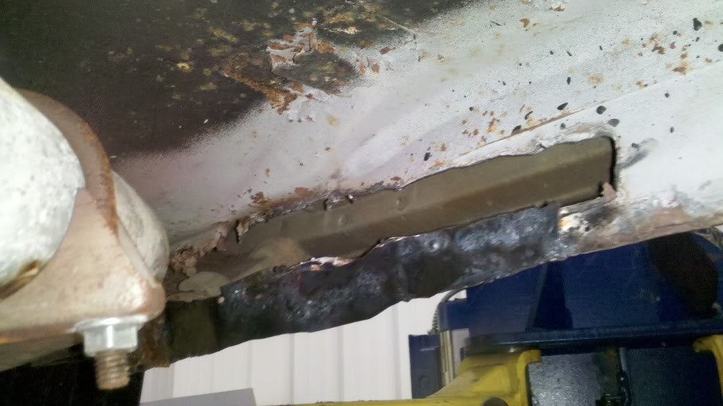

Unfortunately I don't have a finished picture. After the 3rd I ground, shaped and painted the repair but here is what I did. Also don't mind my really bad welding.

So you essentially cut out the damage and welded in plate to try and rebuild that area?
I may do something similar. I am neck deep in engine bay mods (firewall, wheel wells, etc...) Once that is done, this is the next thing on the list. Just wanted to get a thread rolling so that when I get to that step I can see what some other people have done.
Thanks.
Yup exactly. Took a bit of effort to get right thanks to the jack that crushed the section.
