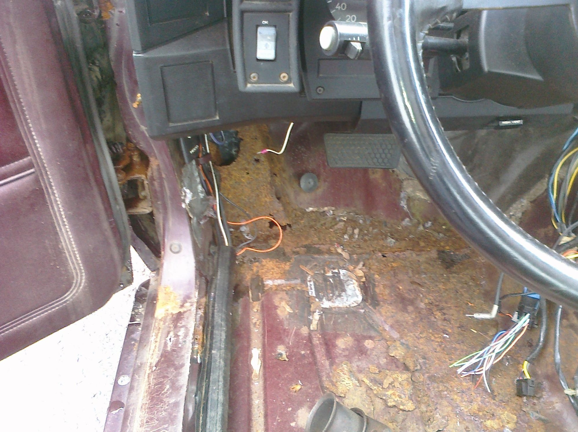

It's amazing how these cars always rust in the same pattern. I'll bet the water is coming in from the front wheel well in the photo above.

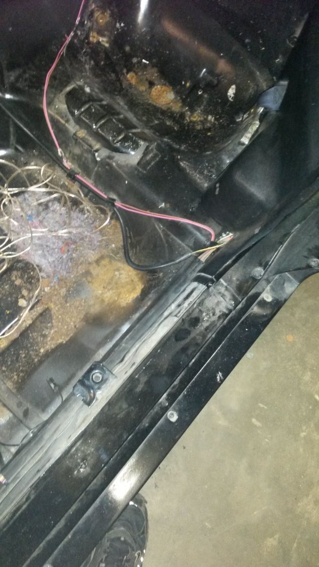

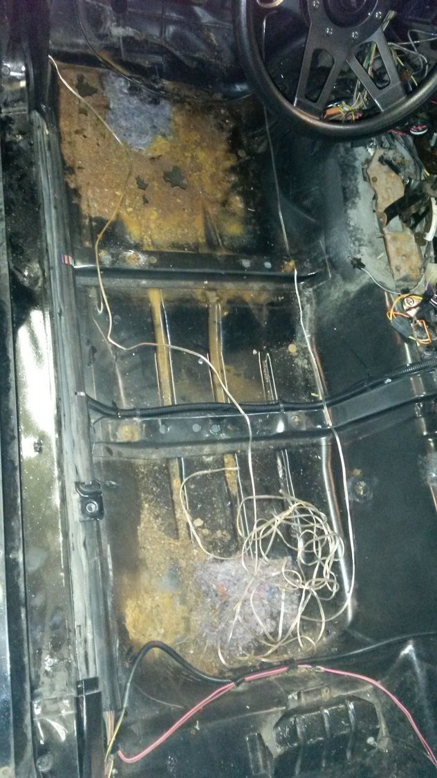

So for the lca mounts do they just kinda mold / get welded into the floors pan? Im kinda worried about that area and how far up the rust goes under that rubber mat thing in the front

The floorpan is a separate piece from the LCA boxes, which are just spot welded in a few places to the thicker gauge steel the LCA mounts are in.
Don't worry, try to salvage as much as you can from what you have, because yours doesn't look like it's unusable.
