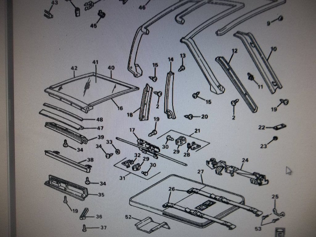

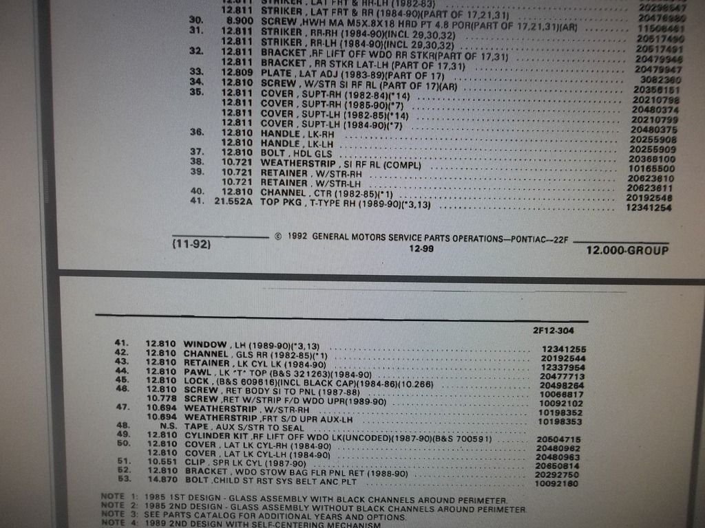

Re: T-Top Question
It appears that you have the 1st design,it shows P/Ns but I doubt you will find any new parts for that app.

Re: T-Top Question
HUGE help Mantaguy!
I like how the superseded version was just to remove the channel altogether...lol
NOTE: 1st design: black channel around perimeter.
NOTE: 2nd design: No black channel around perimeter.
LOL
At least now I know what to do! Nice clean glass without that channel on a nice set of brand new rubber seals for the t-tops should work good! Thanks for your help!
