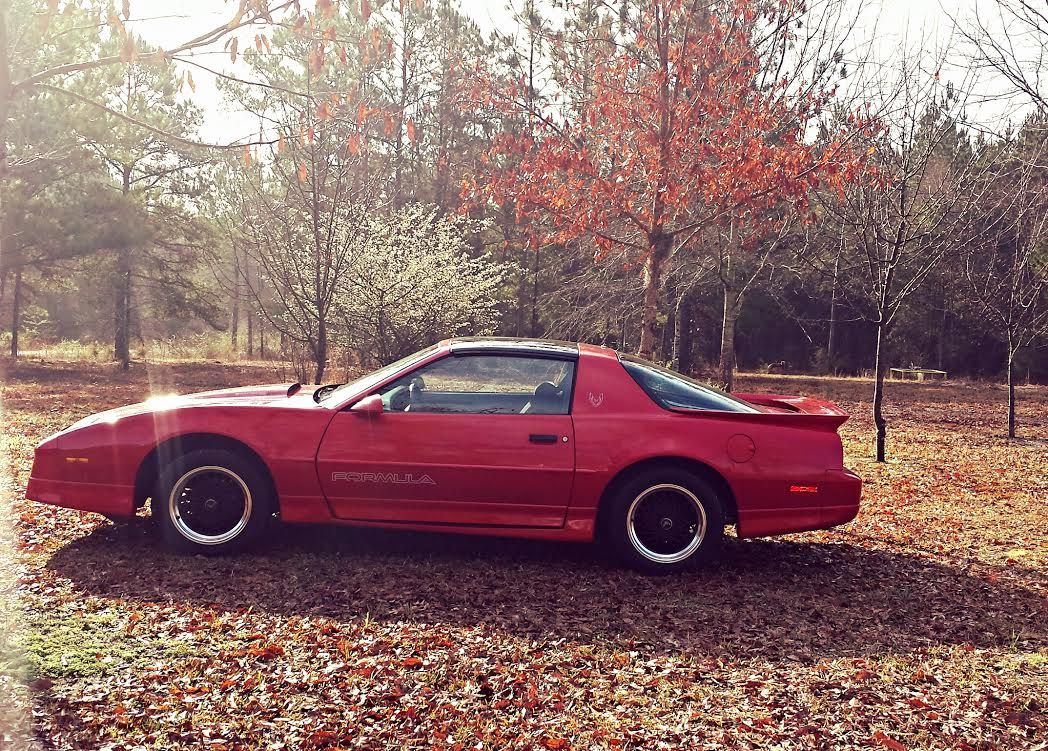

Re: trans am ground effects on a firebird
Luckily the previous owner made the swap before I bought the car. I heard it was a tedious chore but it sure makes a Formula look better
I like them better w/o ground effects, but I have to admit, this looks great. Very nicely done! I'd drive it proudly!
