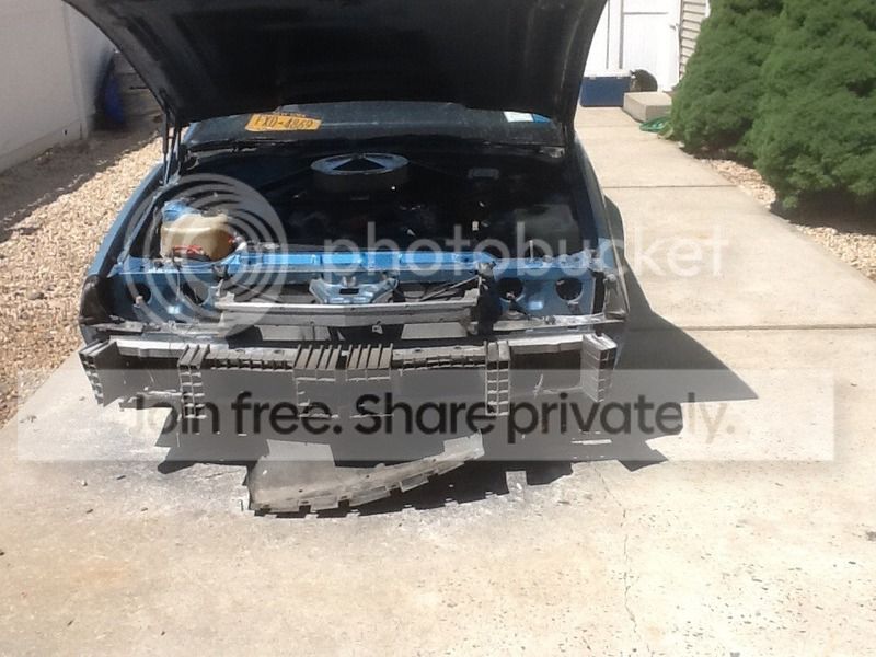

Spend the most of the week disassembling the car then sanding with 220 and read leading the small scratches. Tomorrow I will start blocking with 400and finishing with 600
Also got my 3M pps started system for paint disposable paint cups, got both adapters for my sata jet and devilbiss guns

Properly blocked with 400 and 600, took a lot of high spots down from original paint
Red leaded spots around the car, next is to prime with a rattle can
