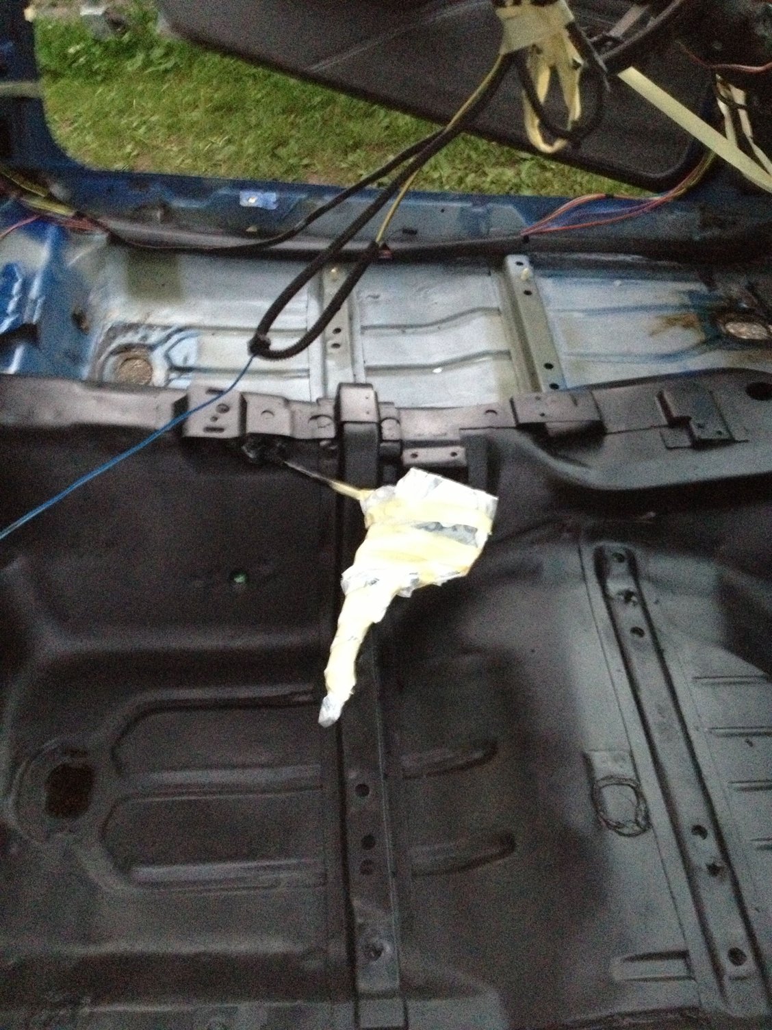

I just finished my floor pans! I welded in patches and seam sealed then rust primer then bedlined it I used duplicolour from the can I bought it like 4 years ago for like 20$ dumped in a can lacquer thinner to thin it out rolled it on did 2 coats i used the aerosol for hard to reach areas.
Before and after
Front
