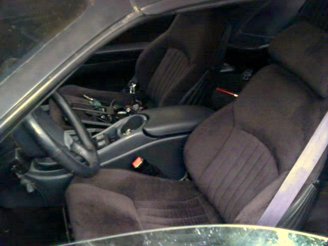

Old Dec 24, 2001 | 02:22 PM
Tonyrodz's Avatar
Joined: Mar 2000
Posts: 1,611
From: NJ
Transmission: auto
Here you go!
My 86 w/a 92 style console.
Attached Thumbnails Center console-4th-gen-console-2
