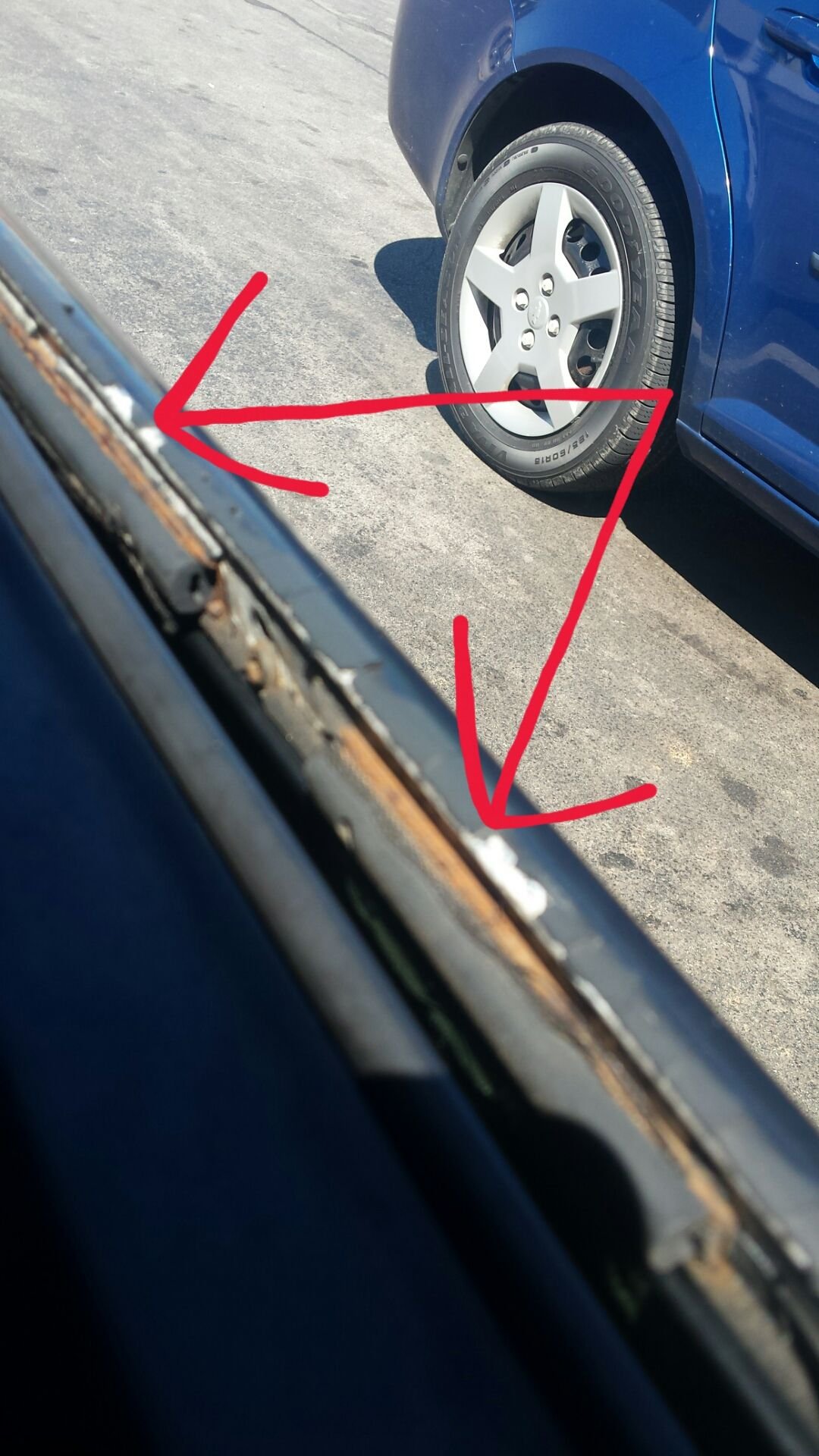

Hi my 84 Z28 has 3 or 4 of these rubber guides or something along the outside of the window. Does anyone know what they are called, where to get them, or how to fix it? Mods please move if I'm in the wrong forum.

Re: Outside of window getting scratched by these. Where do I find them?
http://www.1aauto.com/1982-92-chevy-...=309242&y=1986
looks like you need inside also
http://www.1aauto.com/1982-92-chevy-...=329665&y=1986
or
http://www.1aauto.com/1982-92-chevy-...=476084&y=1986
Are you talking about the window guides?If so IIRC they may be part of it I'm not 100% certain, if not they are available
http://www.1aauto.com/window-guide-p...=261199&y=1986
Those are not rubber, they are felts
you need a better pic of your door,it seems that theses are missing also

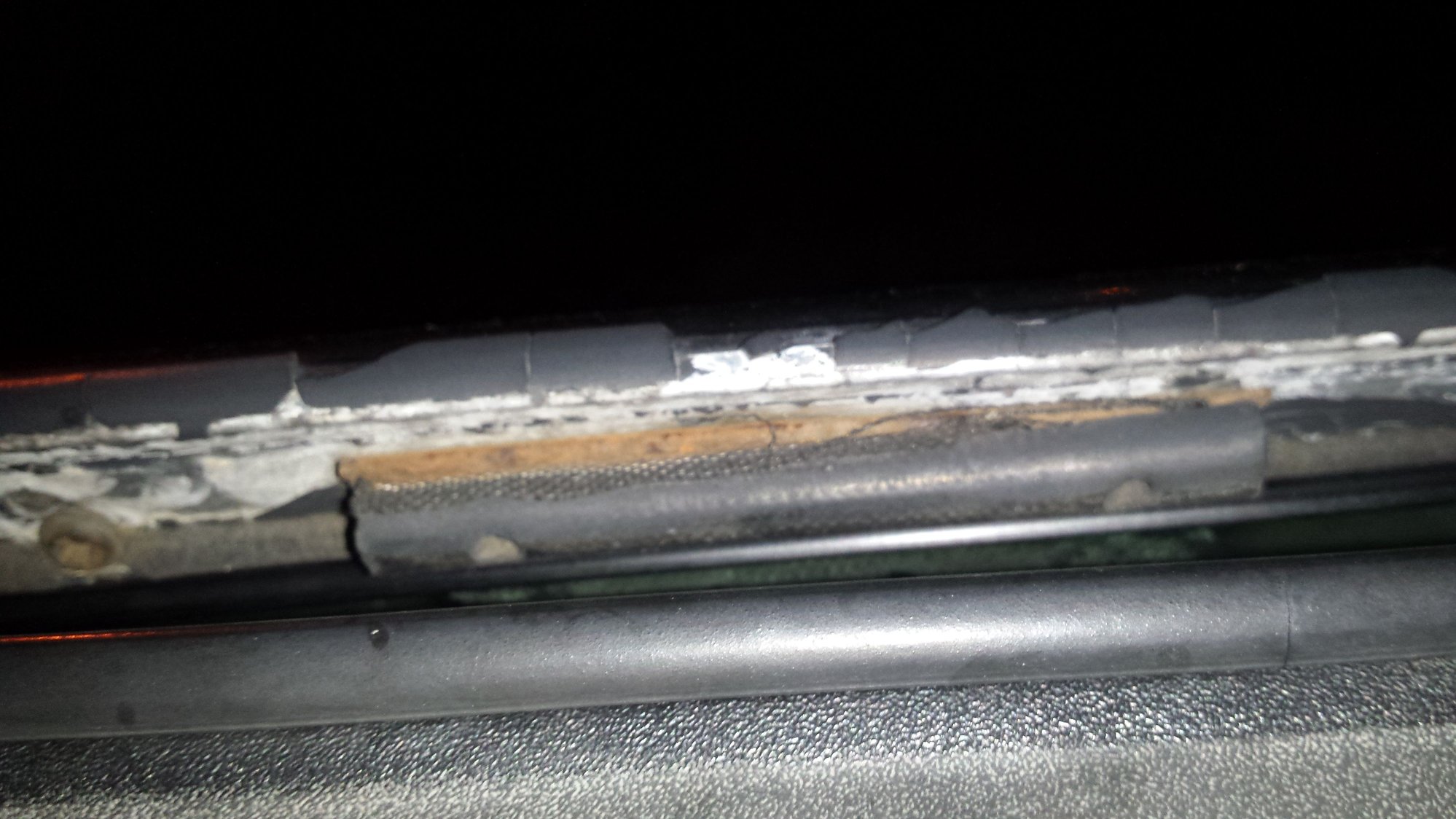

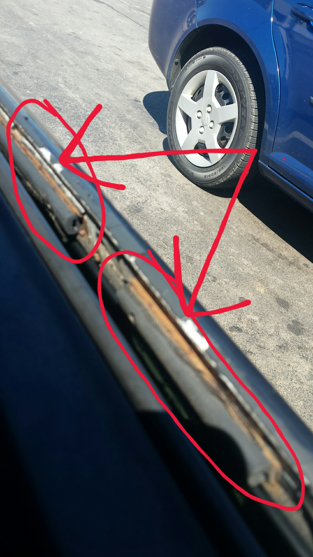

It's the rubber/plastic pieces circled on the outside of the window. I have the felt window guides on the inside of the window. I'll try to get a better pic when I get a chance
I've Never Seen Those On A Third Gen.
I've never seen them before,I thought you were talking about the outer window sweeps, That's a CHEAP FIX that didn't work.do yourself a favor and do it right
I don't know. It looks like it's supposed to be there. The very front one still has some felt left. There are 3 on the driver side outside of the window.
Edit: it's probably the window guides you already posted. I was thinking you posted the ones for the inside.
While we are on the subject, does anyone know where to get the triangle filler pieces and what they are actually called?
Same place you get the window sweeps
http://www.1aauto.com/1982-92-chevy-...=260240&y=1986
Don't count out the inner guides (#18 in diagram) if you haven't pulled them for inspection. They tend to wear unevenly and are the most common cause because the windows weight and also adjustment causes a good amount of pressure on them. Another way to tell is if the edges of the inner pads match up with the scratches of the window.

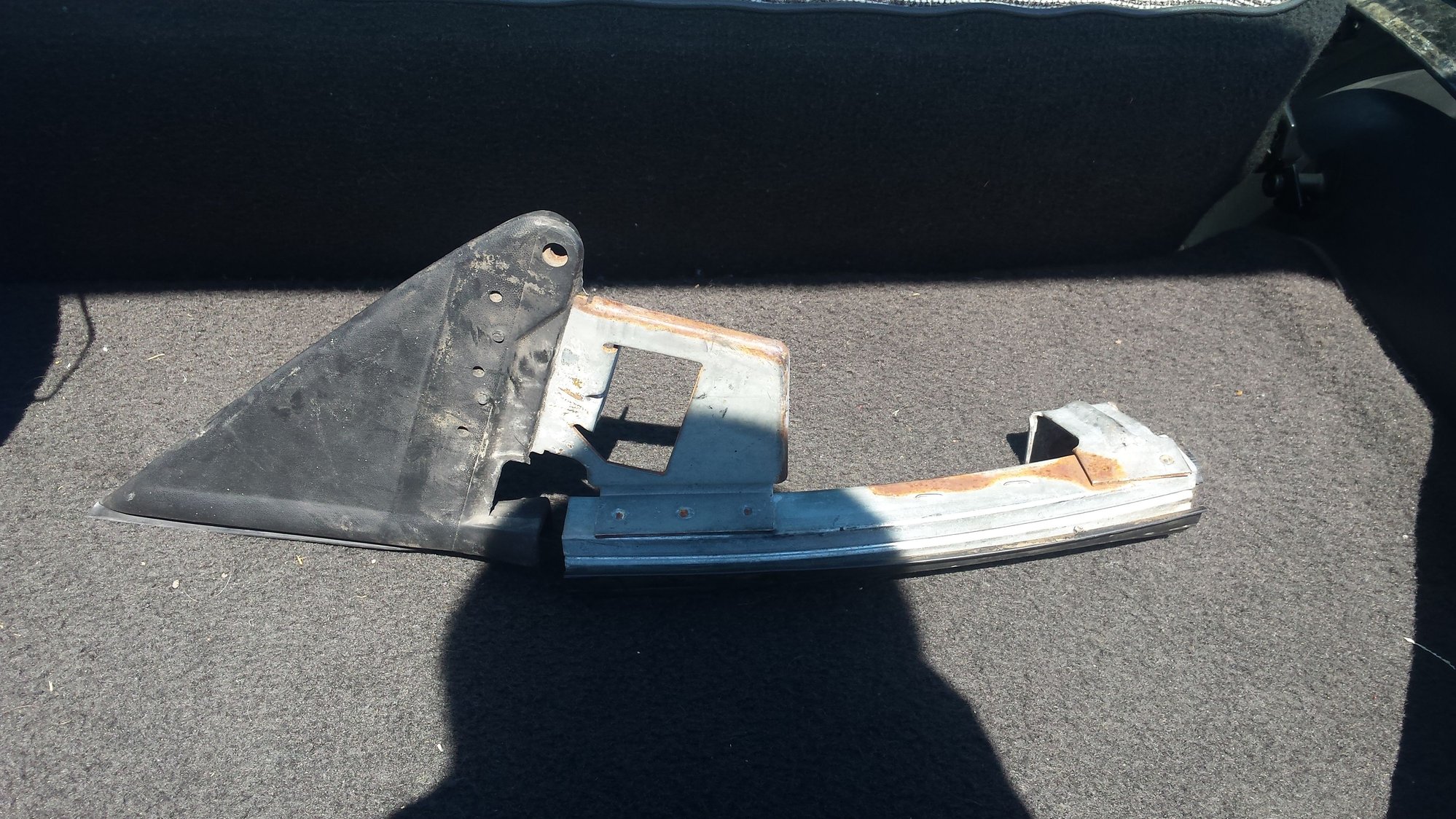

I believe I'm needing the piece those attach to. This is a pic of one. Actually I believe it's #92.
