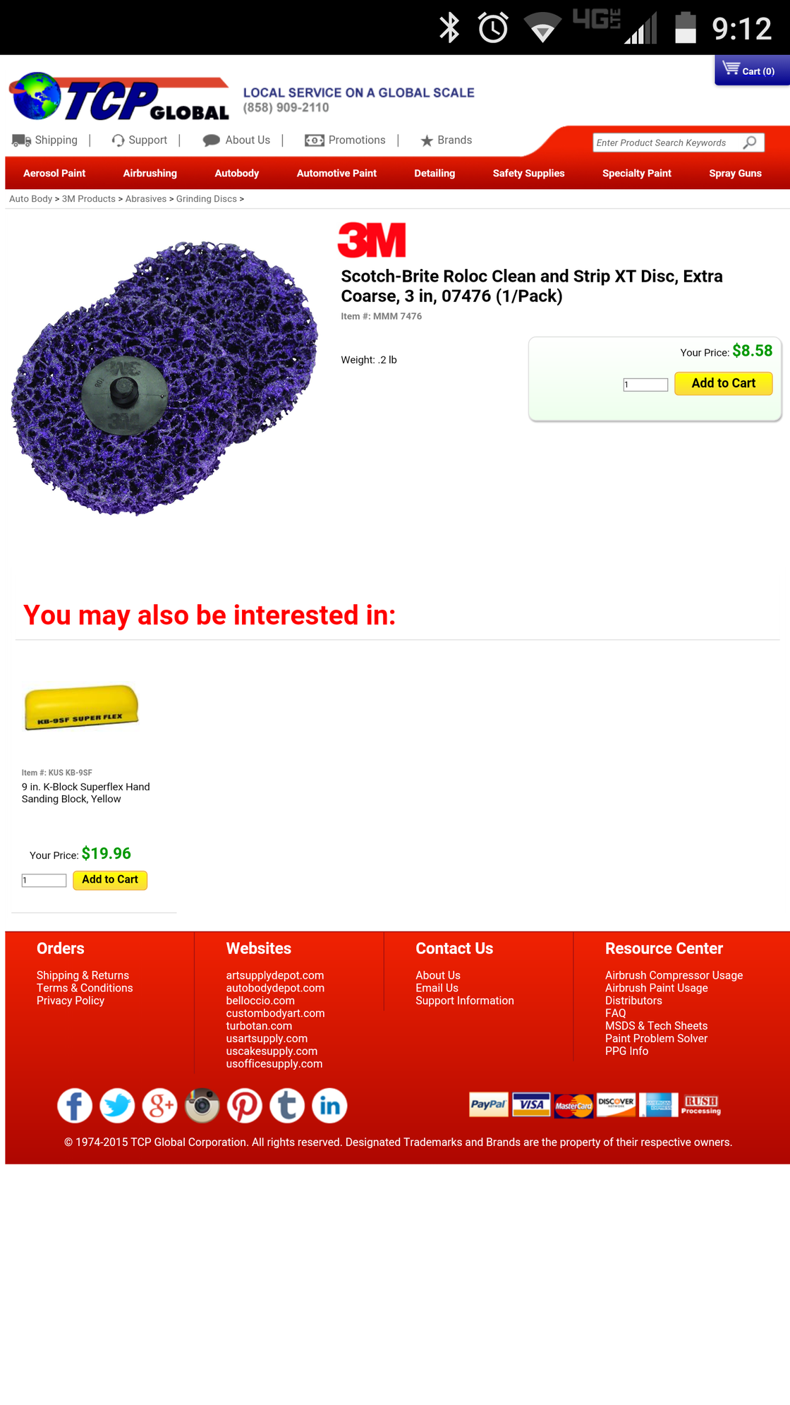

3m makes a fiber disc that is purple and that strips seam sealer pretty well. Once you get the sealer off you can sandblast it and then etch prime it, seam seal it and paint it again.

What can I use to seal it, and do you have any more information on the 3m part? Another thing. I don't have sandblaster, so I guess I would just sand it down and use a dremel to get it down to bare metal. Thanks for the reply
