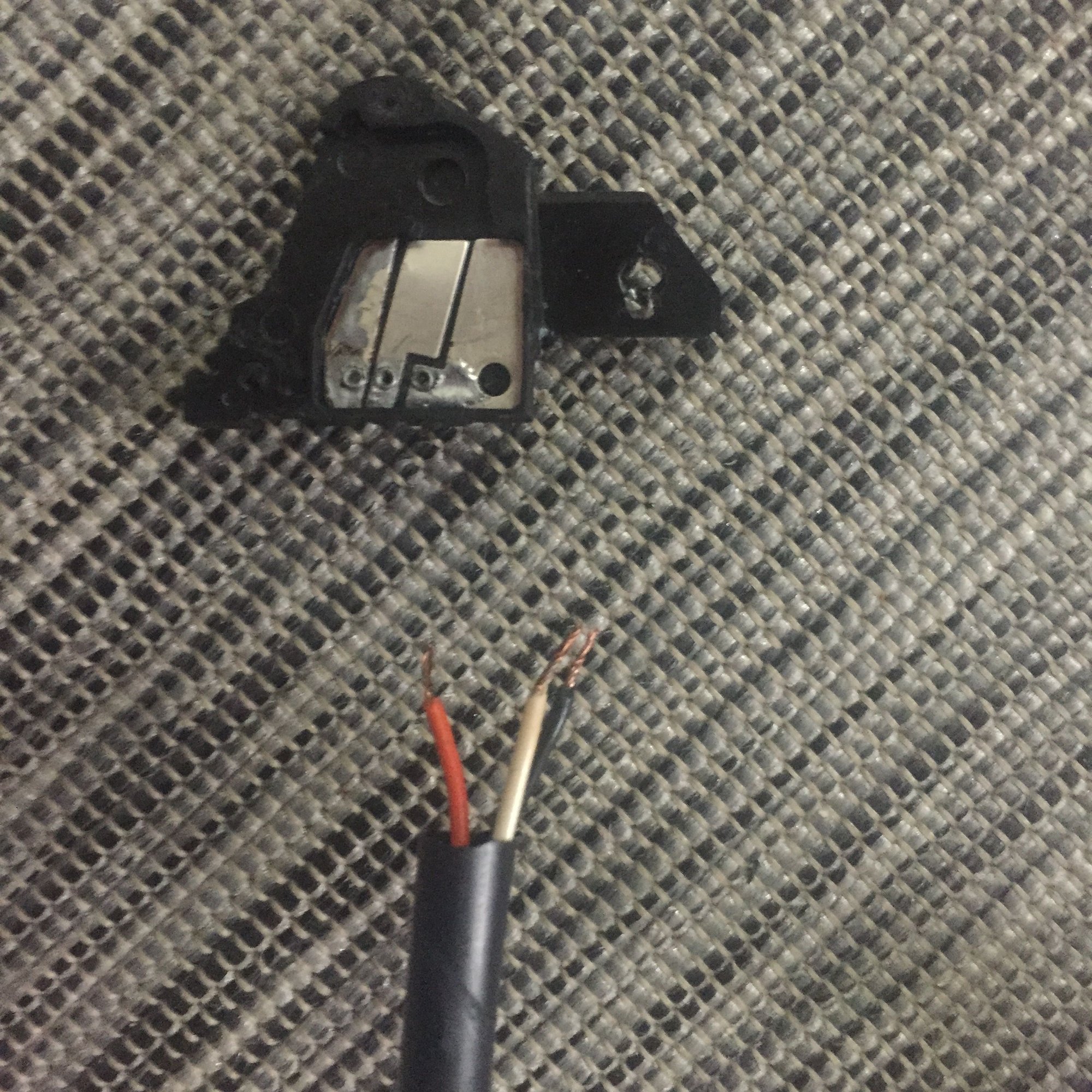

Help with trunk latch
I am in the process of rebuilding the trunk release mechanism, I ordered new guides from hawks and have it all ready to go. My problem is while taking it apart the wires came out on the striker sensing switch, its 3 wires black,white and orange and I want to solder them back on. I just don't know what wire goes where. Its the piece on the top left- http://www.top-downsolutions.com/rec...h-pull-down-un - Can someone provide me with a picture of the wires going into the switch. Much appreciated

I tried searching diagrams online and couldn't find what I was looking for. Can someone tell me left to right what wires go where.

Nobody has one laying around they can snap a picture of?

use an ebay pic of a the trunk motor assembly. last pic, zoom in http://www.ebay.com/itm/90-Camaro-Fi...pXPmFf&vxp=mtr

Perfect. Thank you very much!
