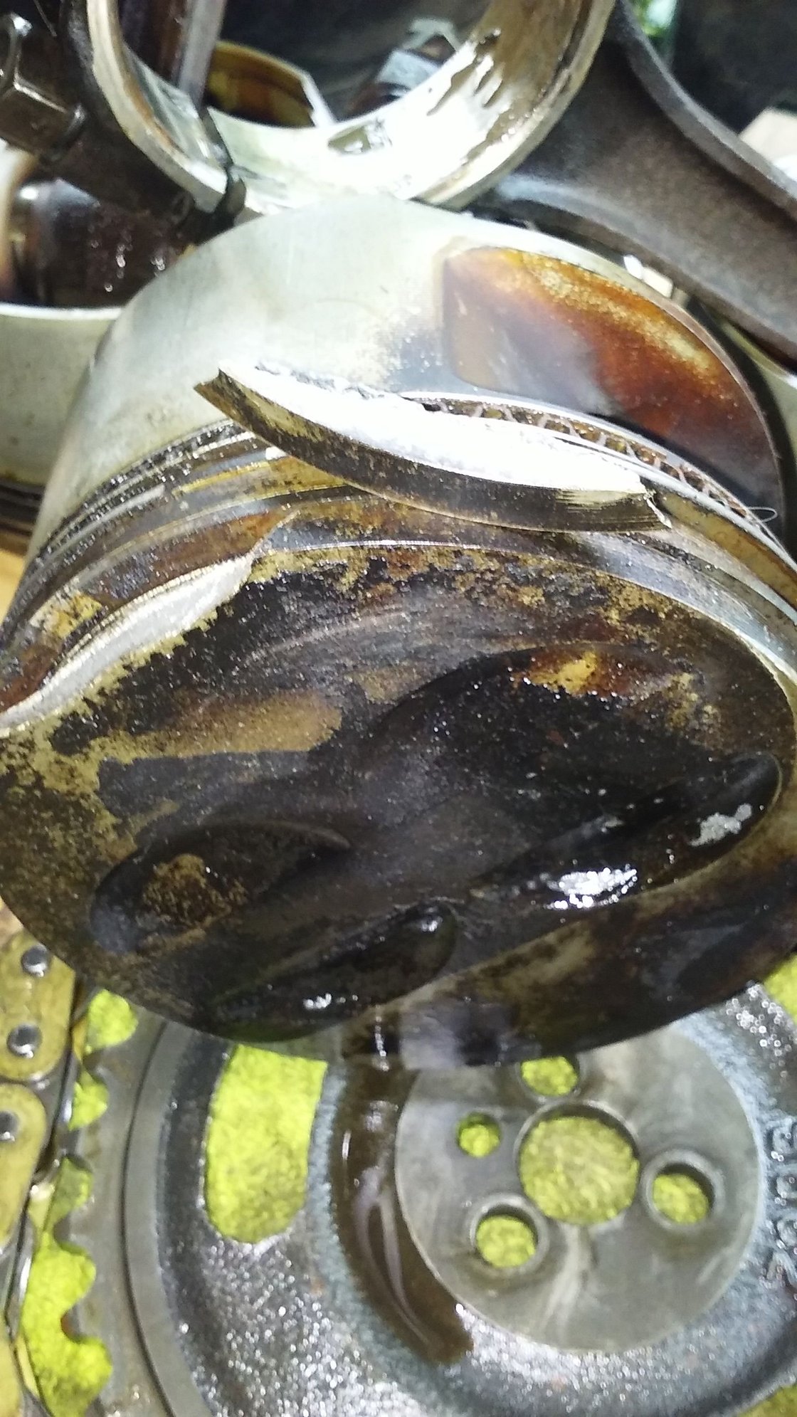

So, due to tight funds, I'm wondering if I could dodge the full rebuild with machine work, cleaning, etc.
I know my crankshaft is **** atm.
Would it be safe to just buy a rebuild kit and put it in under certain circumstances of the blocks's condition?
So far, I tore the block down to base block and plugs. One piston was broken to an edge. once that piece came free, the rings just fell right off. The cylinder walls have "some" wear to them, but nothing that looks like something went carving through it.
The rings fell off shortly after this was taken lol.
All bearings are ****. Good thing a rebuild kit includes a new set ehh. lol.
The rust in the cooling lines throughout the block, I know can be flushed out with some sort of solvent.
Or would it be best I just give out a arm and a leg to get the machining work done?

That engine needs a "full" rebuild' By whatever definition you assign to "full".
It needs the cylinders bored, the decks resurfaced, the crank tunnel checked for straightness and concentricity, the crank reground, the rods checked carefully for out-of-round in the big end and replaced if not right. It needs new pistons and rings to fit the new bore, new bearings of course, new timing set. And of course clean-up, paint, etc.
The heads need the seats and valves ground, the guides checked for wear and bronze sleeves installed if they're worn, new springs, and proper setup for whatever cam you decide to go back with. Now would be the time for some MILD hand-porting, especially cleaning up all the weird steps and ridges and angles in the bowl right behind the seats where the factory just jammed their cutters down into the casting.
I think you just found out why you only paid $150 for it. Which is about right for a desirable core (rebuildable wore-out) engine, which an actual L98 core would be considered "desirable". Not a bad price really.
"Tight funds" is irrelevant. The parts aren't listening, and won't un-wear themselves out or un-destroy themselves, just because you P&M a bunch. It costs what it costs to make it right. If you don't make it right, you'll have an end product that will make you sick with regret every time you turn the key. It is POINTLESS to get on here and P&M at us about "funds". In the end, the lowest-cost way to handle rebuilding a motor, is NOT to use cheeeeeeeeeep parts and services, skimp on the whole deal, attempt to re-use stuff that isn't re-useable, and so forth: that only leads to a pile of garbage. Try that, you'll find yourself going back and doing it AGAIN. It's NEVER "cheeeeeeper" to do something half-a$$ed once, have it not work out, then go back a SECOND time and THIS TIME do it right. Shortest, most direct, lowest cost, least disappointment route, is to do it RIGHT the FIRST TIME, so you only have to do it ONCE.
There's going to be ALOT more than just the engine involved in this swap. You'll need accessories, exhaust, a transmission, wiring, and so on. It'd be a GREAT idea to put the whole "tight funds" crap out of your vocabulary RIGHT NOW and instead concentrate on learning what results in success and what leads to failure, and go to work on assuring the former.

Yes SOFA has the correct advice. If your looking for information that will rebuild your chevy 350 for nearly free will be waiting for ever. Fact is the sbc is the most economical engine to buy and rebuild in the world. A brand new 260hp GM Goodwrench 350 motor is only $1,500. And u can buy generic 350 rebuilds from the auto parts stores closer to $1,000 but it will have a warranty. More horsepower is gonna cost more. Blue Print motors and ATK motors have hi-po motors in the $3,000 range. Its really hard to beat those prices and u will save maybe 20% on the same build doing it yourself - if your lucky. Most that home build a motor themselves do so to get the specific build using expensive parts they want rather than the savings from their own labor.
What im saying is your motor w/broken piston is beyond a simple re-ring and re-bearing overhaul. And if a 350" sbc is to expensive for u to rebuild then u should consider geting rid of that 350 and drive the V6 into the ground. Then when that expires buy another V6 camaro for simple transportation. Rebuilding a motor does take several skills and though everyone needs to start and learn somewhere failure is more likely on your first try and your new investment in parts can easily become junk. Reading here and on other forums that engine rebuilding is simple is very misleading for the new enthusiast. Most beginners cannot even adj the vlvs let alone select and measure bearing shells for clearance, verify ring gaps, check crank end play and rod clearances, install the timing set let alone degree a camshaft. How many owners know where all the block galley plugs are to remove and replace? Im afraid to hear it.
"Tight funds"? If u dont have at least $2,000 available for a basic rebuild and closer to $3,000 for performance build then get out of it.
