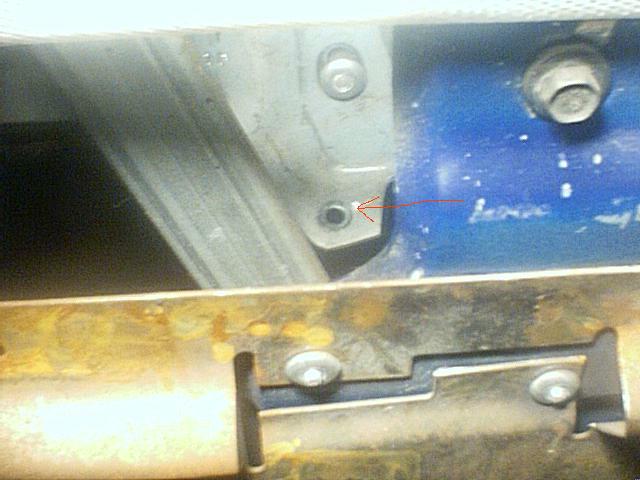

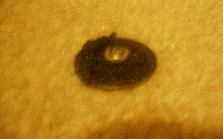

Come on guys. Surely somebody has fixed or tried to fix this before. Would it help if I added pictures of where the piece goes and what is left of the piece?
[img] http://oconnor.cz28.com/images/door.jpg [/img]
[img] http://oconnor.cz28.com/images/door2.jpg [/img]
Hopefully the pictures work, if not I apologize. If the links do not work please copy and paste them.

the piece's you're asking about is still available through the dealer. I just picked some up a couple week's ago. For my 90 and they are all the same from 82-92. The part number is 4767527. the only thing is they don't come with the rivet's to put them back as they came off, I used 3/16 screw's and nut's. And that should take care of your window's.
Old Dec 30, 2001 | 10:58 AM
KS91Z28's Avatar
Joined: Oct 2000
Posts: 686
From: Gardner, KS
87 IROC 350 TPI Thank you! Thank you! Thank you! That's exactly what I needed. I'm gonna pick some up first thing Monday morning! I have a pop rivit gun and lots of rivits so that won't be a problem. BTW, how much did they cost? Again, Thank you! Thank you! Thank you!
