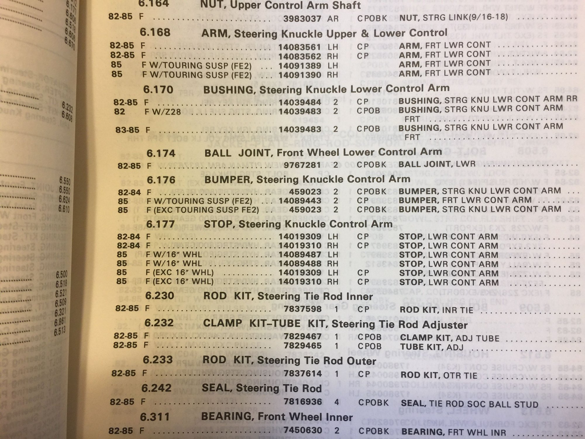

I got my hands on an 82-85 parts catalog. The only difference I can see are the Stops. The catalog lists different part numbers (LH & RH) for the 16 inch wheel vs all others. But this part is not included in the illustration. Where exactly is it? The catalog lists a Bumper and a Stop as separate parts. The Bumper is the same part for all cars, and is mounted to the control arm. It's number 26 in the illustration. The Stop is only in the alphabetical listing section of the catalog with different part numbers.

But this is my confusion. The Bump Stop in the parts catalog is listed as just the Bumper (#26), part no. 459023. It's the same for all cars. Another part listed as just the Stop (which is not pictured) is part no. 14019309 (LH) and 14019310 (RH) for the 16" wheels and 14089487 (LH) and 14089488 (RH) for all others.
Here's a shot of the alphabetical listing. 6.176 corresponds to #26 in the illustration, but 6.177 is not listed.

Plug those numbers into a search engine. You will get all sorts of hits. Like THIS that shows what the STOP is.

Thanks! Now I see it. That part is on the rear facing side of the control arm and is riveted to it. The bumper is on the front and is for bottoming out (makes contact with the frame).
