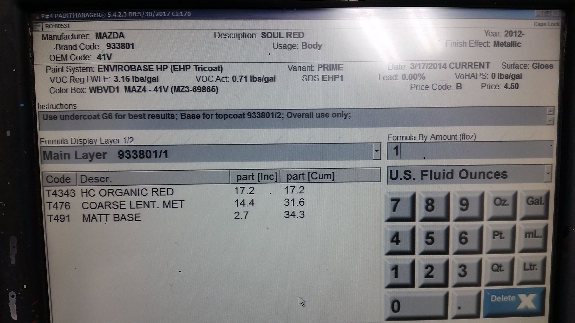

41v tinted layer
41v main layer
46v is the newer color

46v says 2017 and up. I'm assuming later 2017 for the 2018 model year
