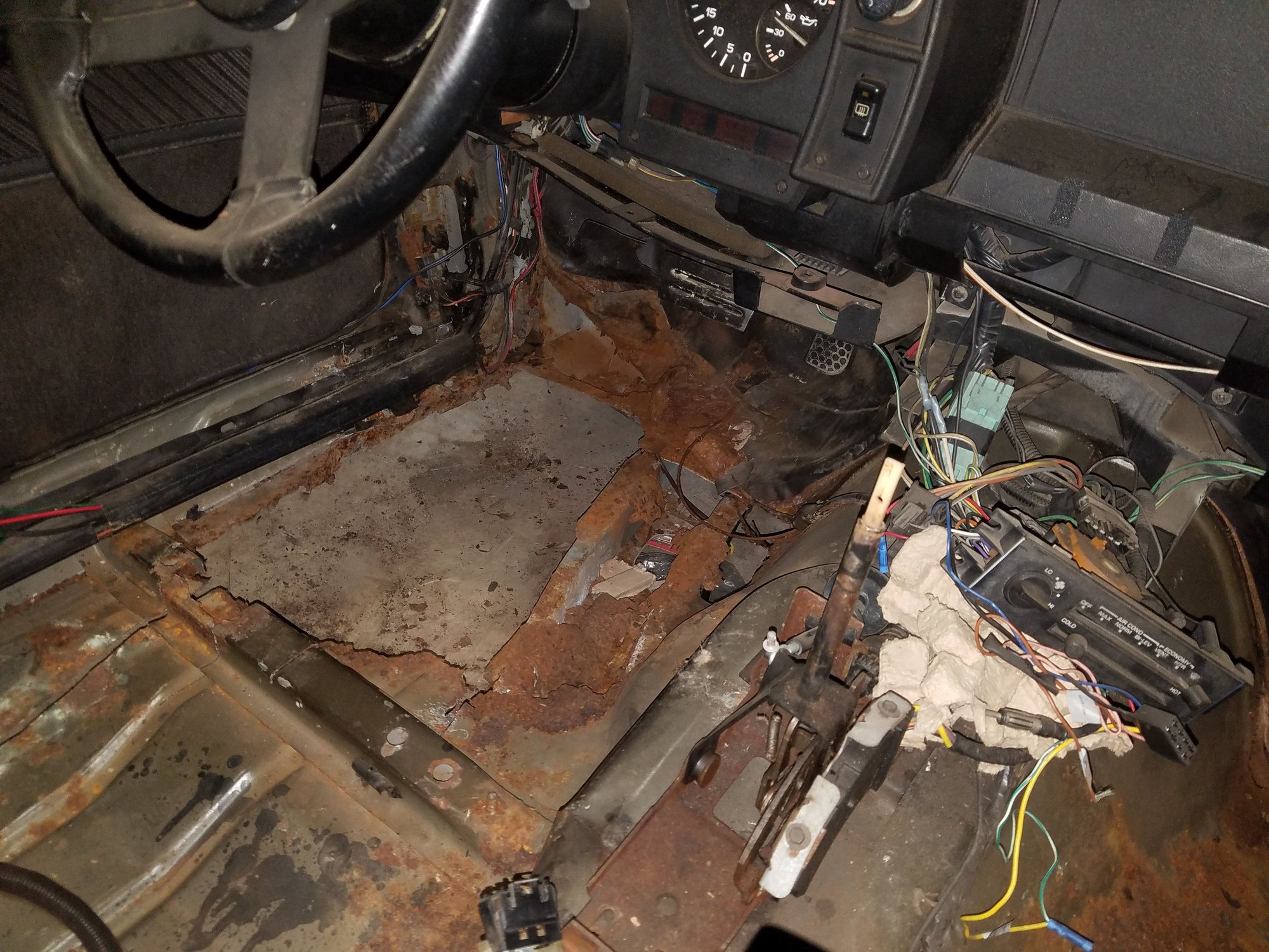

Hello All, So a little back story… I bought this 84 Camaro 7 or 8 yrs ago as a project 800 to 1000$ (20 yrs old at the time) Needed new floor pans other then that not a bad looking car, put it in my garage where it sits still today. Guy quoted me 2200$ to cut the old out and weld in new ones about 7 yrs ago. Passed on the option because I was broke at the time. Flash forward to today have some money to start working on it and bought the floor pans for it a few months back. Started to cut out the old floors last night and it is worse then I remember it. Subframe/unibody seems pretty solid still, but no idea where to go now, save it, junk it, part out I love this car but not sure where to go. A few pics attached of the floors or lack there of.
Driverside door area
Driverside Full
Passenger Side Full
Center/Tran Tun
Driver side Full sideshot
Drivers Side Front

Nothing is too far gone if your willing to put the time in. With that being said, that is a pretty heavy repair job. How straight is the body? Are they full pans with bracing and all? Hows the rear quarters and paint in general? might be better off moving on.

The paint is 7/10 i'm fine with how it looks on the outside . One 3in rust bubble on the door thats about it. Body is straight .The floor fans are Full floorpans from summit or rockauto made by Sherman i have both driver and passenger side and i also have seat mounts/floor braces from cali i bought a few yrs back also,

There are guys that have fixed worse and most will say don't bother,I say at least try to repair.I love third gens and if you can afford the time and money to repair this I think you will be happy.
Are going to repair this yourself and how far does the new floor pans extend up to the body because the drivers may need more repair panels.

there is enough good metal where the trans is I think i can cheat them closer to the body/door area if needed.Ill be doing the welding myself and some fabrication. My new concern is this hole where the floor pan stops, not sure if its structural or not so not sure if it can be cut out and refabed or not.

Do you have any pics from the outside of the hole?
One thing about it it does not look to be supporting anything now,so if you cut out just enough to repair the hole and and replace the metal I think it would be fine.That might be easier said than done,but when you finish this and it is all repaired you will be proud and will have gained much valuable knowledge.
I would suggest subframe connectors after the repair to help with structural support.

By far the #1 issue is the extent of the rot. Floor pans and most of the external sheetmetal are offered as repros and patch panels. But when you get into it, the rust isn't isolated to just the floor pans. Gay-ron-tee the rust extends over the lap joints where panels meet. Probably find the rust follows and flows between the lapped joints. Meaning you need the floor pans plus sections of the panels that meet up to the floor pans. You'll need to repair or replace panels that aren't reproduced, and rust free donors don't populate the junkyard, all thirdgens rust in the same places.
Just in that Driver's front corner, you've got the floor pan, the toe board, the inner rocker, and inner door jamb. To fix it right, you've got to separate the panels, cut away all the rust, and weld in new metal or at least good metal. It's a pain in the ***. I've been working at rust in that same area of my project car, but on a much smaller scale. https://www.thirdgen.org/forums/memb...ml#post6269164
Once you start stripping away the rust to try to find clean metal, you'll probably discover the rust is worse than you think. Sure you can probably fix it. It's probably just not worth fixing. I'd suggest starting small, dip a toe into the project and decide if you really want to be married to a project of that magnitude. My guess is you'll find that when the rust is completely cut away, there probably isn't enough left to really work with.

Thats what i'm noticing already.when putting it on the wheel dolly's i noticed the jackpoint/pinch welds are rusted pretty bad but still usable(i tried them out diden't sound pretty).that and iv noticed there is no real places to weld the floor pans of the side by the doors Thats where im at a loss is the non reproduced parts and finding the metal rocker panels and the junk yards around me are all rusted because of salt from the winters up here. I'd hate to chalk this up as a loss but ill find out more this weekend when i get rest the dash and everything out.
