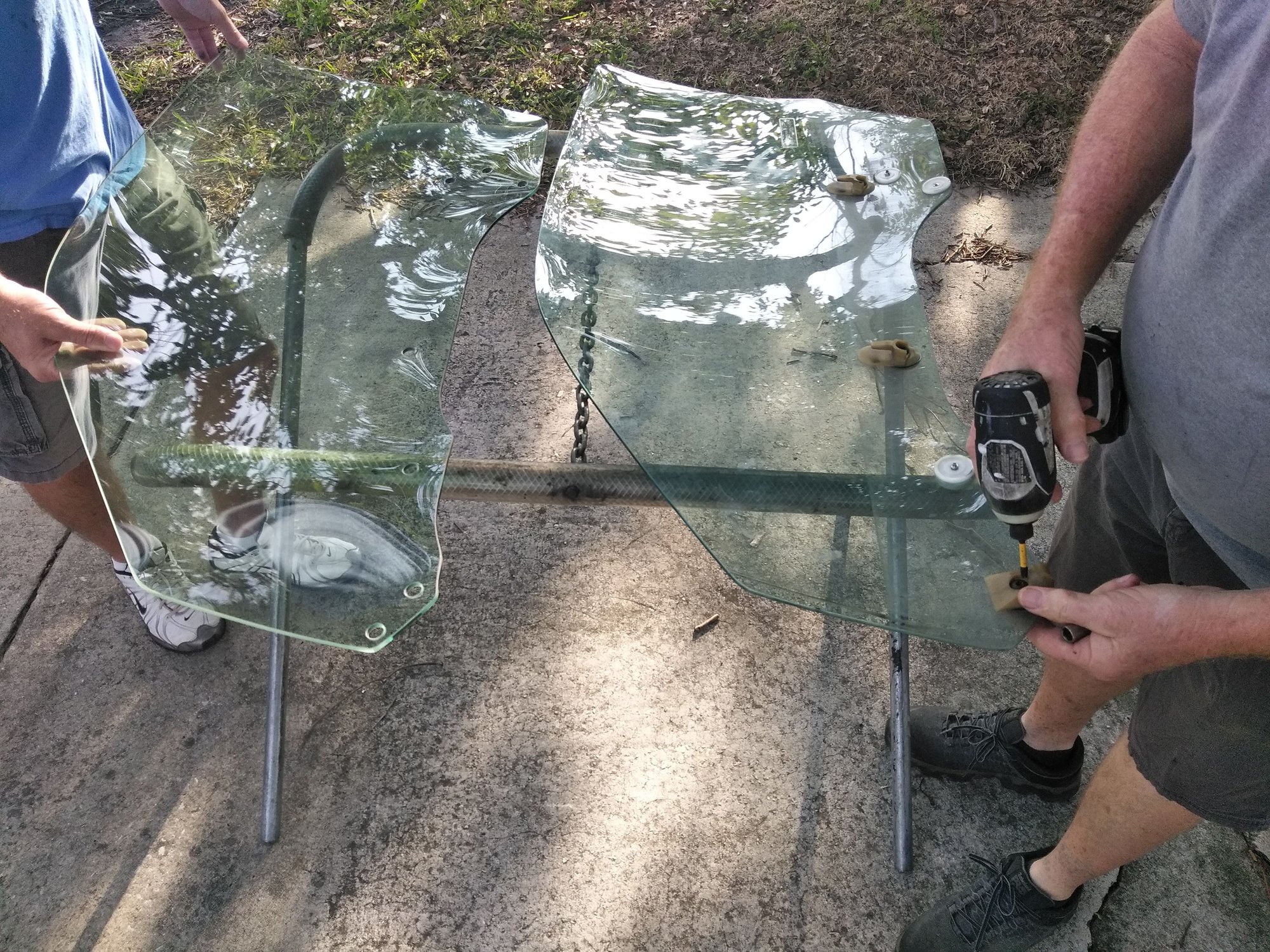

The glass from my 91 is on the right side. The new glass for an 82 to 89 or 90 is on the left. The only difference we could see was that the new glass had two holes instead of one, near the front bottom corner of glass. Where he is removing the bracket from the old 91, one hole, on the other one, they are two holes.
Not sure what goes there for the older cars, I thought the window bumper mounted to the window, but I guess it mounts to something inside the door.

Re: New Glass... Where to buy ???
the window regulator , the part that makes it go up and down , is different so the attachments are a bit different
either window should work
