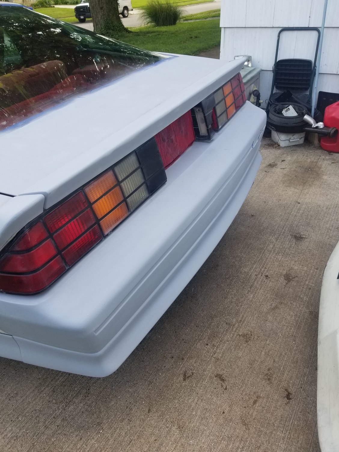

I just did this Caddys plastic parts:
Old Jun 10, 2019 | 10:49 AM
sonjaab's Avatar
On Probation
Joined: Apr 2007
Posts: 1,592
Likes: 18
From: Syracuse NY
Car: 84 Z-28
Engine: 305 HO
Transmission: r-700
Axle/Gears: 3:73
Re: Economical DIY Basic Paint Job
FINISHED:
MATERIALS:
This was my materials. Paint match was excellent.
Pint of paint $50 online
Primer spray bombs $5
Laq. Thinner $19.
Both from wallyworld
Hardner free from a body tech bud.

WARNING: THIS WAS A TEST - Used 80 grit by hand, to course? Put 120G pad on and...
I'll remove the tail lights so I can get up there but how do I get that strip where the bumper emblem goes? A smaller sander? By hand?

That was the worst part on the whole car, that damn indentation. I used sandpaper by hand, it took for ever and I had horrible blisters after. I think I used a putty knife at some point wrapped in sandpaper to get the corners.

Ok, I got a bit carried away. Went beyond the test and started sanding my way around all rear trim pieces first. Tomorrow I'll finish up back there and move onto the gfx and and front trim pieces *IF* I have the energy, this little bit was draining.

Put down the 60 grit, its waaaay too coarse and you're going to make even more work for yourself. 10 years in a body shop and I've never seen anyone use that. I'm not sure if you're planning to prime the whole car and sand it down before painting it, or just to seal and paint it. If you're priming and sanding you can get away with 180 - 240 grit and if you're sealing right over it 400 - 600 grit (check the tech sheets on the primer and sealer to see what they recommend). Bare metal can get away with coarser grit than plastic can. It'll be very hard to get the 60 grit scratches out. Step up the grit from like 60 to 120 to 180 to 240. You could even just scuff the whole and and shoot over all the damage. You'd see everything underneath but it would take the least time and at least all be white.
Is primer only required when going to bare metal / fiberglass?
- You can just scuff it and seal it if you're ok with the imperfections. But priming and blocking will help level out the bodywork if you do it to the whole car.
How many hours, of continuous sanding did it take you to get a decent surface?
-Again I don't know how far you want to go with this. If I wasn't going to fix ANYTHING and just buzzed it down and scuffed for a quickie paint job I could have it sanded in an afternoon. The sky is the limit on how long you want to spend making the bodywork and cracked paint right.
-By hand. Have fun.

60 grit way too course for that plastic. The only time you’d need something like that is if you’re stripping paint to bare metal. Notice I said metal.
youre also never gonna fill any of those scratches with that that rattle can primer. You definitely jumped in without doing any research, and info is definitely out there.
To keep it it simple since you have no experience and you’re being cheap(which I understand) I think you should have just bought a pack of red scotchbrites and scuffed everything up and then just sprayed your paint.

Just a bit of progress, every panel sanded got some primer. Some spots heavier than others but I'm a noob and i'm sure I can hand sand it down.
No Flaming, I tried and WILL keep trying.

You didn’t even tape it off?

Didn't tape off as good as I thought, mineral spirits wipe off in order for the tail lights. Edit: Wiped off the tail lights w/ mineral spirits. Doesn't look all that bad now. Updated pic...

The tail lights literally take 5 minutes to remove. I have never understood the point of doing a DIY paint job and not taking proper disassembly.
If you are going to skimp on a professional and save some money, save yourself some time and at least attempt to do it right in the first place. You end up making more work for yourself after.
I have taken my car down twice in order to respray it. It only takes a 10mm and a little time to disassemble one of these cars.
