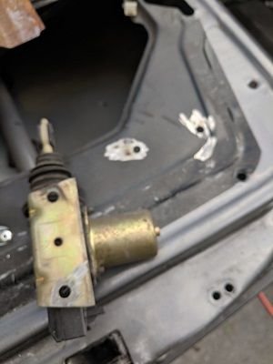

Ground down the rivets to replace the door lock actuator. The bolts are SAE, but too hard to reach. I have the new one ready.

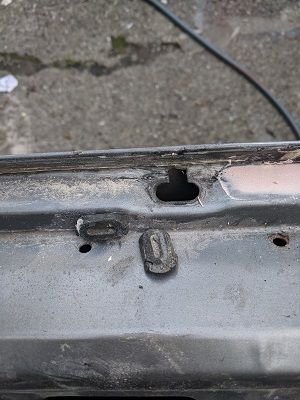

Thanks Beth. My passenger door is in solid shape. the rubber parts shown are on the bottom of each door. they look like drain plugs.
Plus I need those round plastic mounts for the front turn signals. As shown above, mine are all broken. Not sure what they are called.

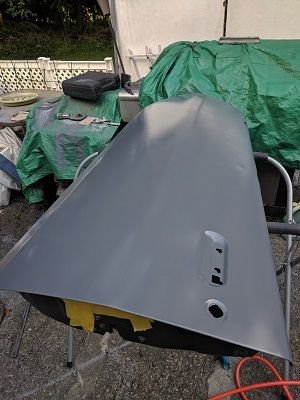

Some more pics!
Look! NO DOORS!!
very helpful tool to support doors on and off
Passenger door now off. Much better shape than my driver door
had to reshoot the first epoxy primer on the bare metal. Just filled in some small dings. Sand, re-prime, high build, sand, seal prime and PAINT!!

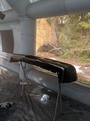

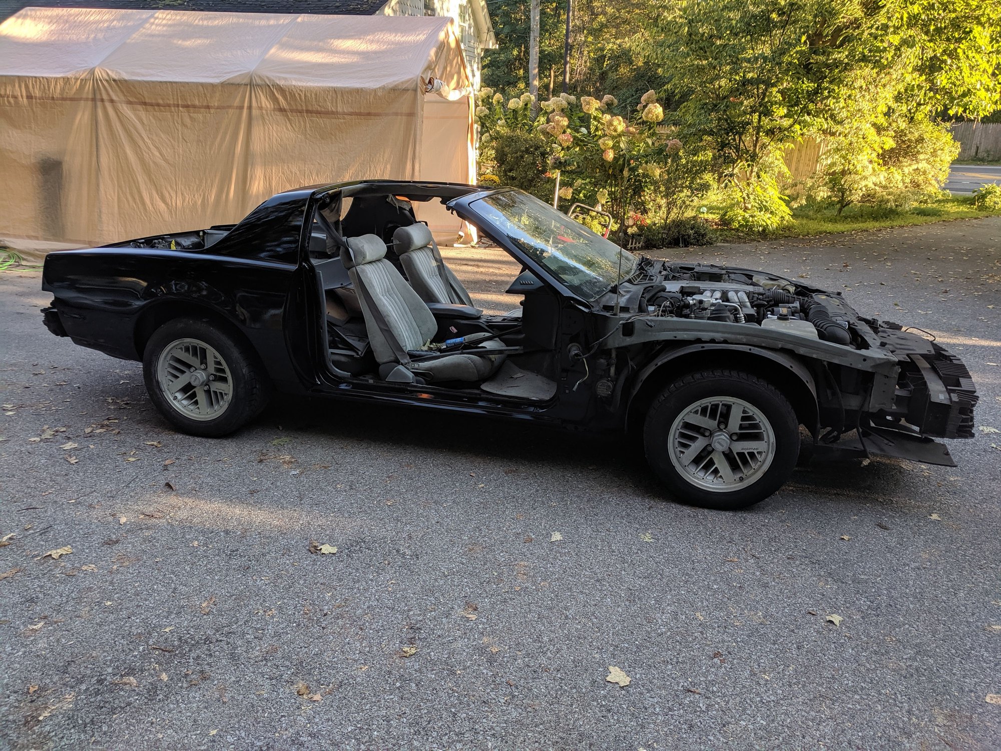

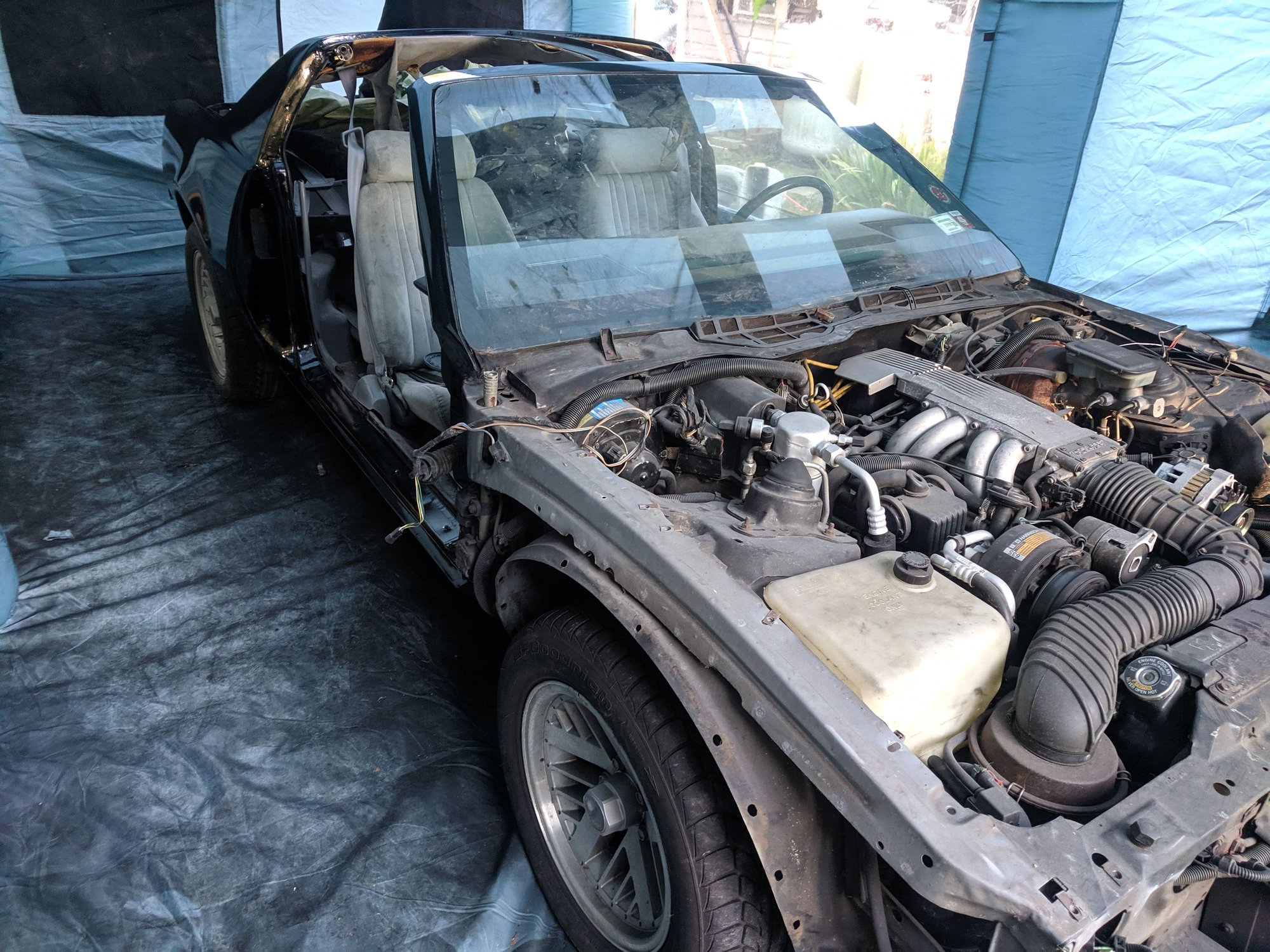

OK Finally, some BLACK PAINT!!!
so here is that tent I bought back in May. Just unpacked it this morning and blew it up. Bit of a scare, haha. There are 2 relief zippers that were open, I thought it had a leak. But it works AWESOME!
so here is the deck and some small parts
Fenders. I got some dripping on one of them I will have to sand out. But Happy over all.
AHHH the font BUMPER!! Been 26 years since it was black!
Overall I am very happy. Its a bit bitter sweet too. I love this car and to see it being painted black again brings back many good memories over all, but some sad. Eastwood makes some great products!

Sorry its a blow up paint booth I bought on ebay back in the spring. it works AWESOME!

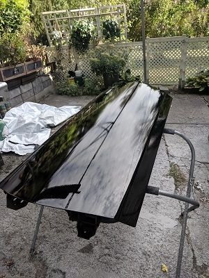

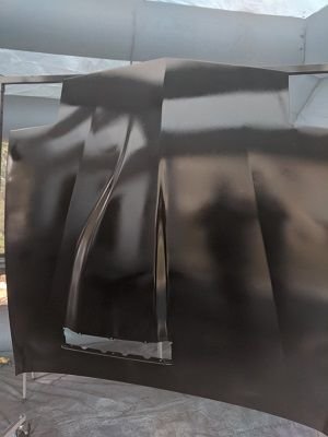

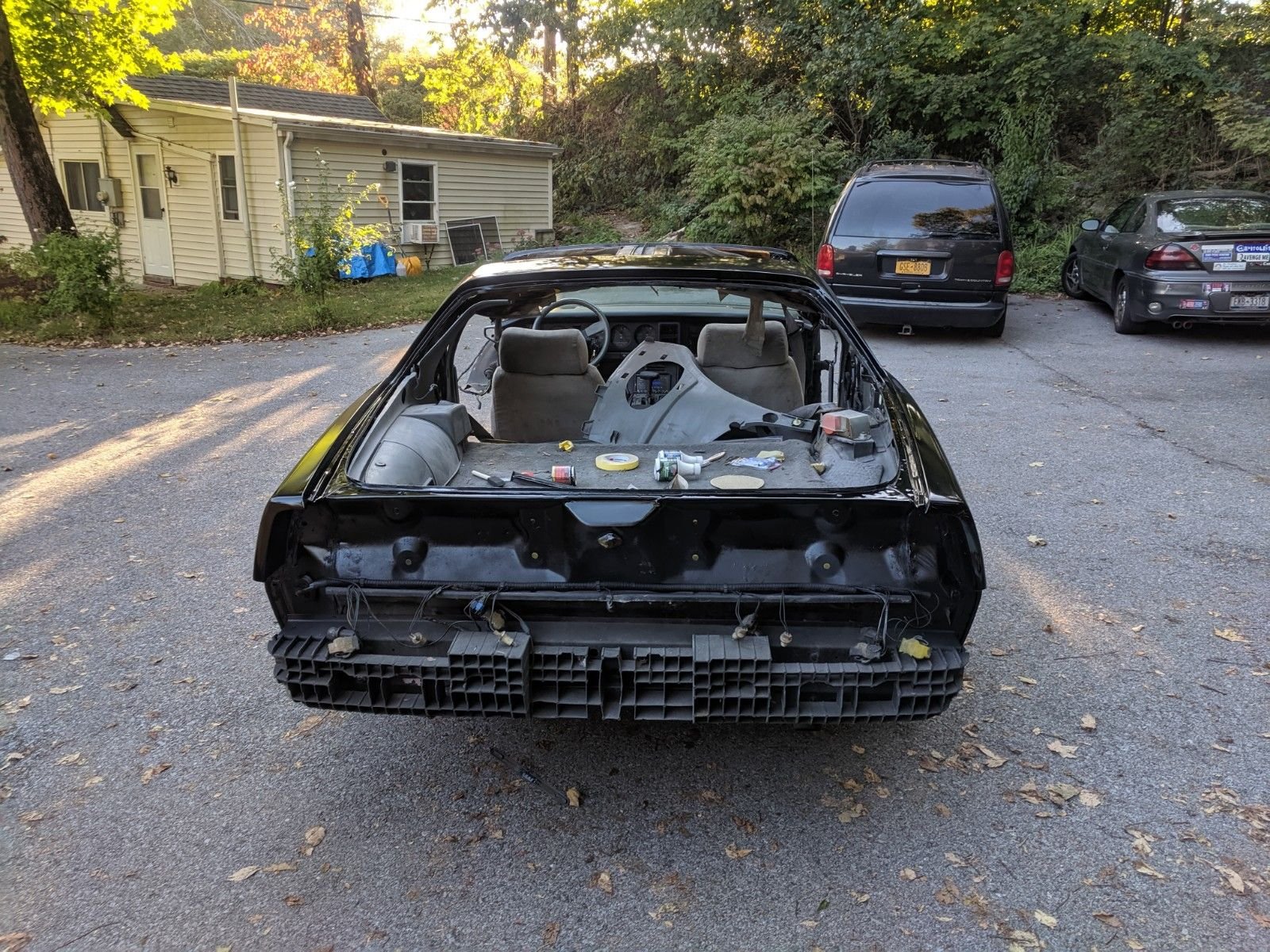

Sorry for the delays in updates, been very busy. Summer is done and I go to get this paint job completed! So the only thing left to sand and paint is the rest of the car, rear panels.etc. I started removing the T-Top seals and the rear windshield will come off this weekend. I started wet sanding one of the doors and ordered the ICE buff package from Eastwood. shooting for 2 weeks to get this done but weather, rain, etc. sets me back. Ordered my rims too! See below!
driver door
pass door
hood
hood again
rear bumper

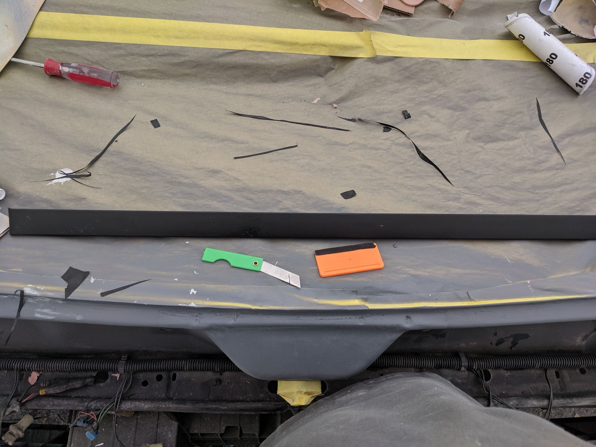

This is the T-Top bar, looks like its not paint on this part, almost a peel an stick finish. What would I recover this with?

i Think for the t top bar it’s going to have to be roughed up for paint to stick. Is it aluminum? It’s been a while since I’ve looked at mine.
Yeah looks that way. All good. I am wet sanding some of the parts, have some minor sand through, ARRGGH. Fortunately I am using 3 and 1 paint, has the clear in with it. Going to partially re shoot the sand through and wet sand again.

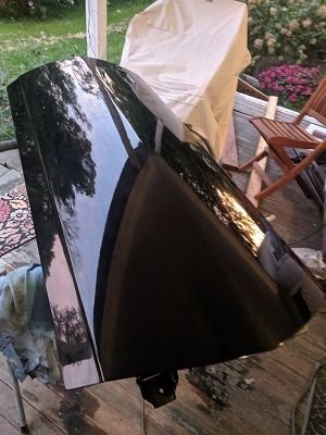

ok some more pics!
Passenger door, wet sanded with 1500, then 3000 then cut with 2 pads and then polished. I am so STOKED!!
another pic
MY RIMS CAME IN!

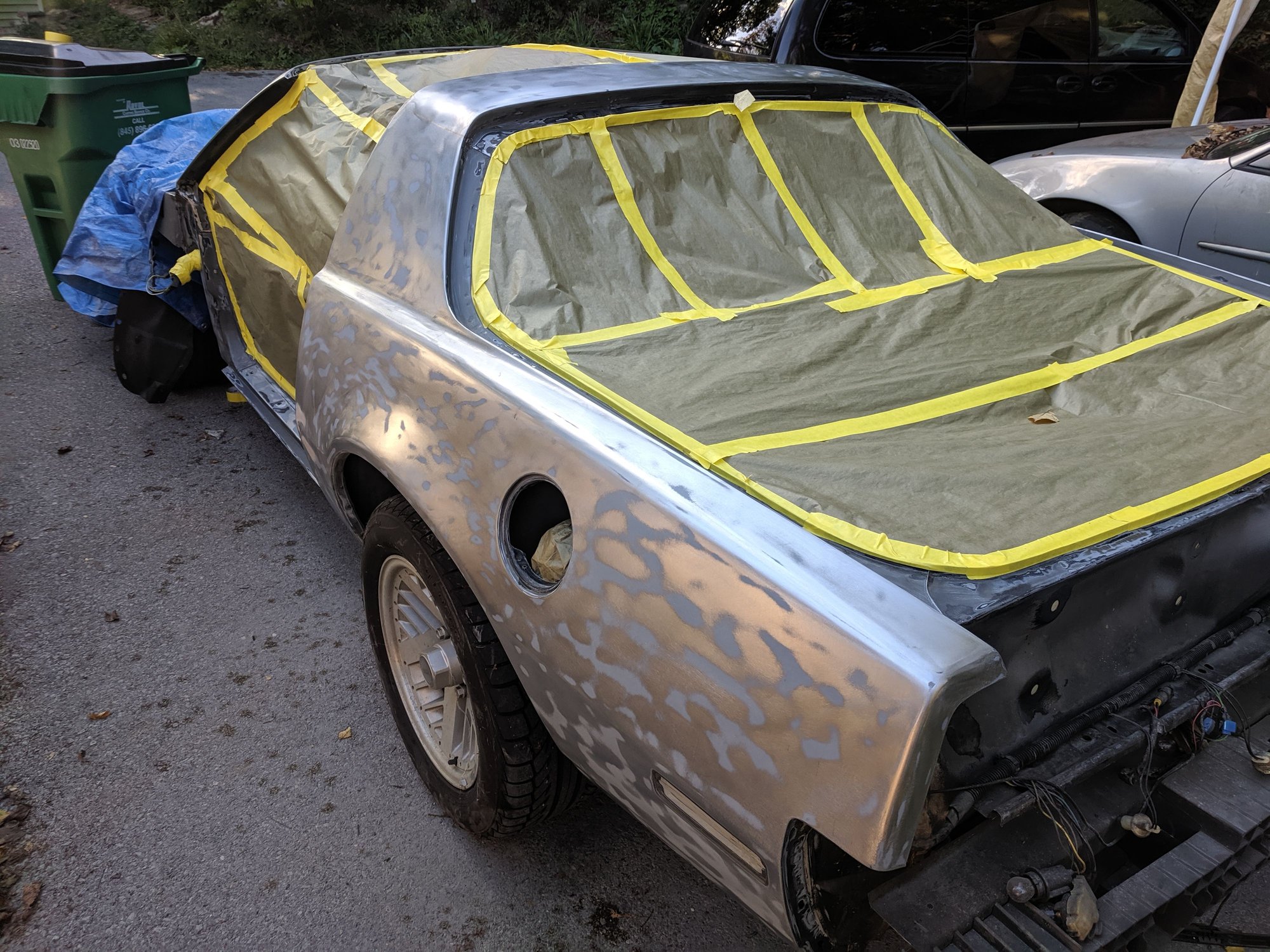

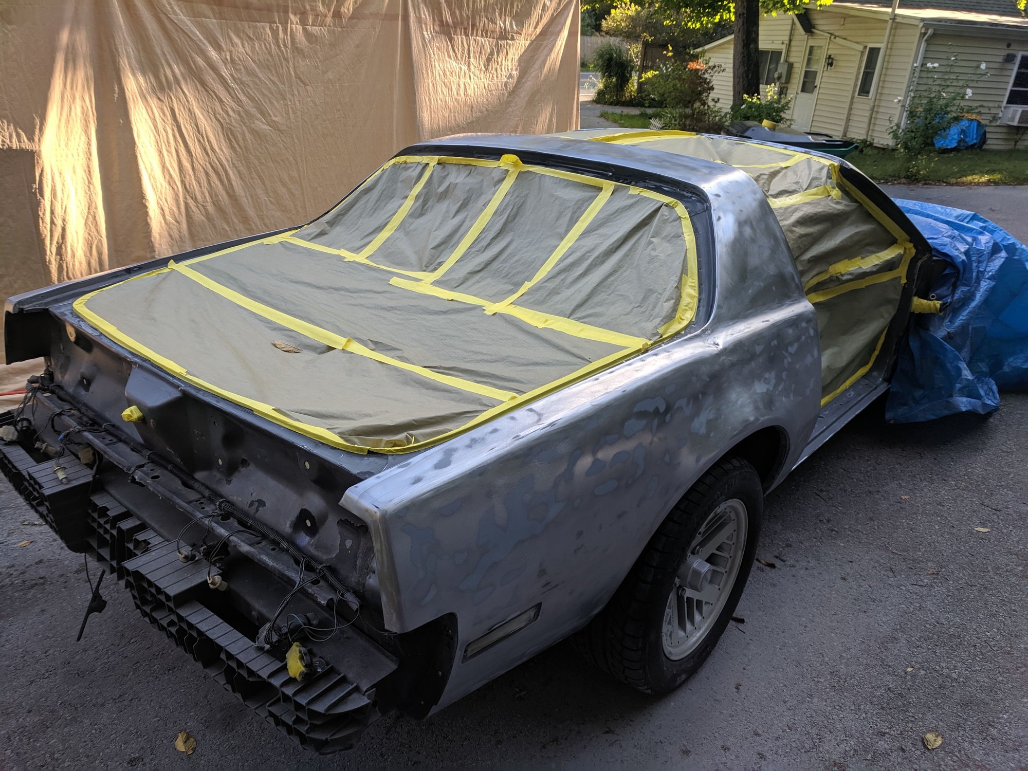

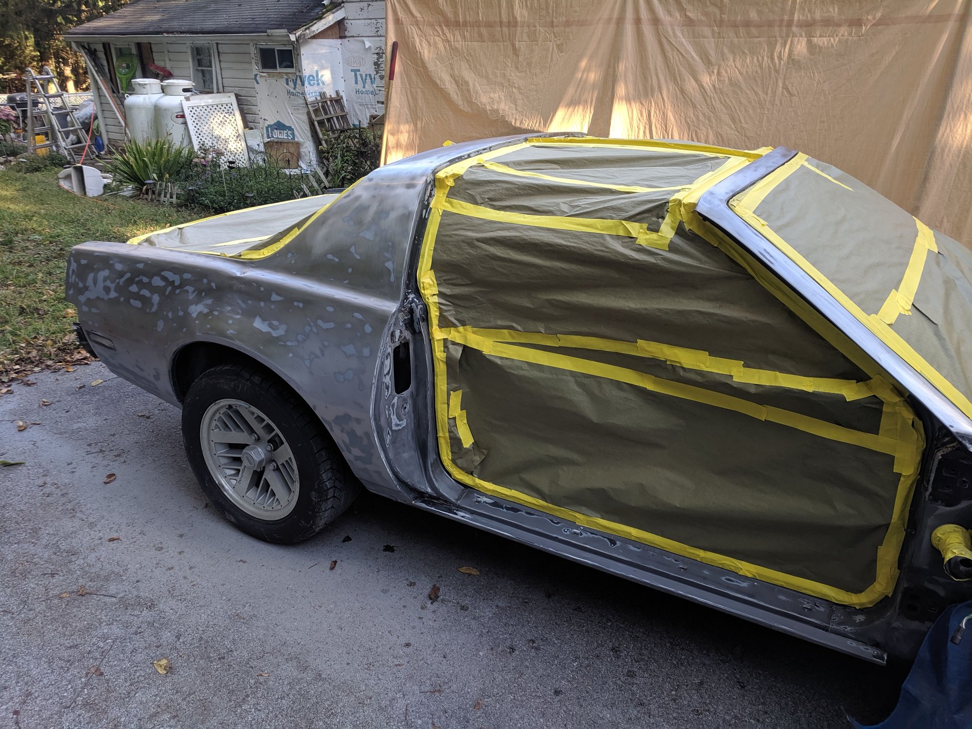

This weekend, going to sand down the whole back end of the car and start the paint process. And do some wet sanding!!!

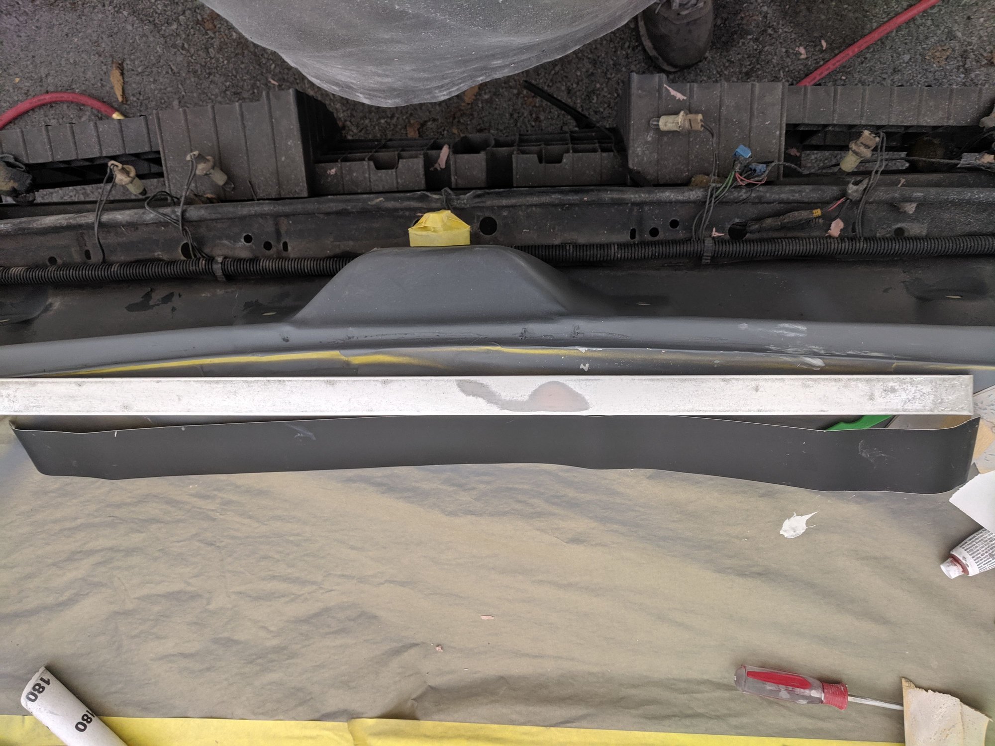

More work!
Need this part, it covers the bolts for the rear glass window hinge.
seen better days.....
So I got all the t-top seals off and started to clean things up. Not terrible shape for 30 years.
Started cleaning the passenger side.
Nasty!!

sand...sand...sand. Sanding down the body. Would have finished but I twisted my wrist. Hopefully done today and hoping to paint the rest of the car Sat or Sun. this week.

Sanded to metal and preparing for epoxy coat
Here is the bar that goes between the t-tops. It was wrapped, not painted. So I removed the wrap and recovered it.
Found a 3m product online and wrapped it. Very pleased with the outcome
So here is some more pics.

Big day coming! Going to paint the rest of the above this weekend. Then I can re-assemble FINALLY! No more parts all over my house hahaha. More pics to come soon!

Sealed it up today. Found some minor sanding issues and will address tomorrow:
Old Sep 21, 2019 | 09:21 PM
  #90
Hawkeye1980's Avatar
Joined: Jul 2005
Posts: 1,062
Likes: 71
From: New York
Car: 1989 Firebird Formula 350
Engine: 5.7
Axle/Gears: Stock
Re: My 1989 Formula 350 restore
ok folks I painted the BIRD!!!
welcome firebird..
prepping for paint
done!
this pic sends a chill down my back, to think it will look the same as it did when I bought it new, 30 years ago this past July.
