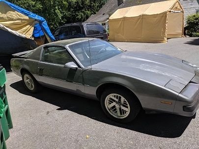

Here it is this past weekend. I have already removed the spoiler and back bumper.

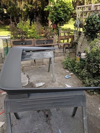

Next was to prep the Hawks aerowing spoiler, I scuffed it up with 220 grit and then mounted the tabs after a call to Steve to confirm where to mount them. There is a flat area on both sides, see below.
Once I mounted the metal tabs, on when the spoiler:

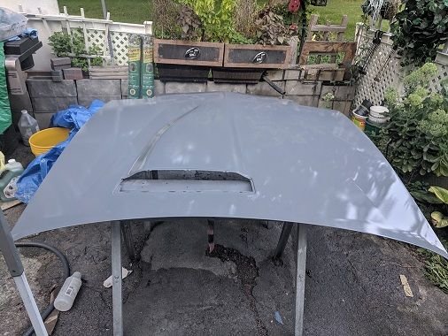

So the hood scoop had a rubber gasket. Any idea where i can get one or what I can use in its place?
I had this in my hood scoop, I have the original block of plate but would love to find a honeycomb one like this again!

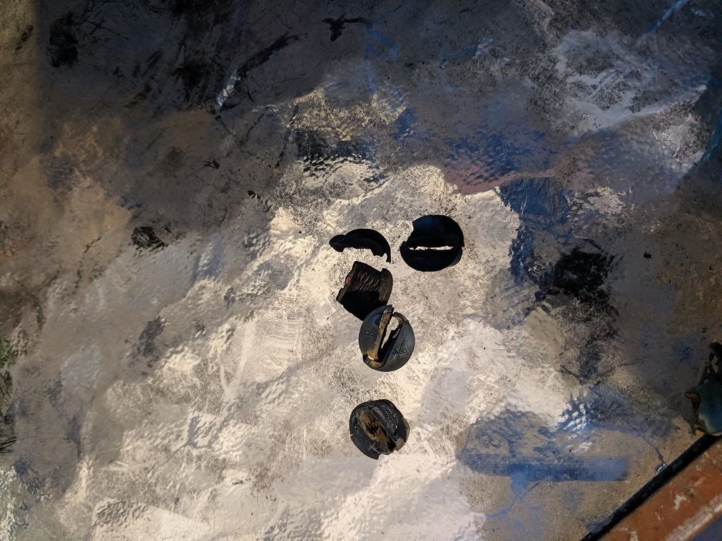

First what are these for?
they were inserted in the metal piece that is screwed into the front rubber bumper. I removed them and they are brittle. Not sure if I need them?
Where the red arrow is pointing too. They sit behind the front bumper turn signal housings, 2 on each side.

Hawks thirdgen spoiler getting ready for new home!

Those little black plugs are what the front turn signal indicators are screwed into.

Not in my case, they are just there. The turn signals are screwed into the metal. Just not sure what they do. thanks.

Rear deck just go shot with Eastwood polyester build
Hood just shot with the polyester build.
So working wit the polyester build from Eastwood. A bit challenging at first. Used a 2.0 tip. First batch I mixed, a little too much hardener, so it gelled up pretty quick. I called the product support yesterday and they confirmed I should use Acetone to thin it down a bit.
So today I added the Acetone, and BOOM! It worked! Came out great and nice heavy coverage. I am not doing the fenders with it. I have 2 new ones and just shot the epoxy coat on them. Need to bondo a tiny bit on one, small dings from shipping. Once these are sanded down I will shoot them, 2 fenders, headlight tops, rear third light housing, fornt/back bumpers and spoiler with the seal coat. Then on to 3 and 1 black paint from Eastwood!!
