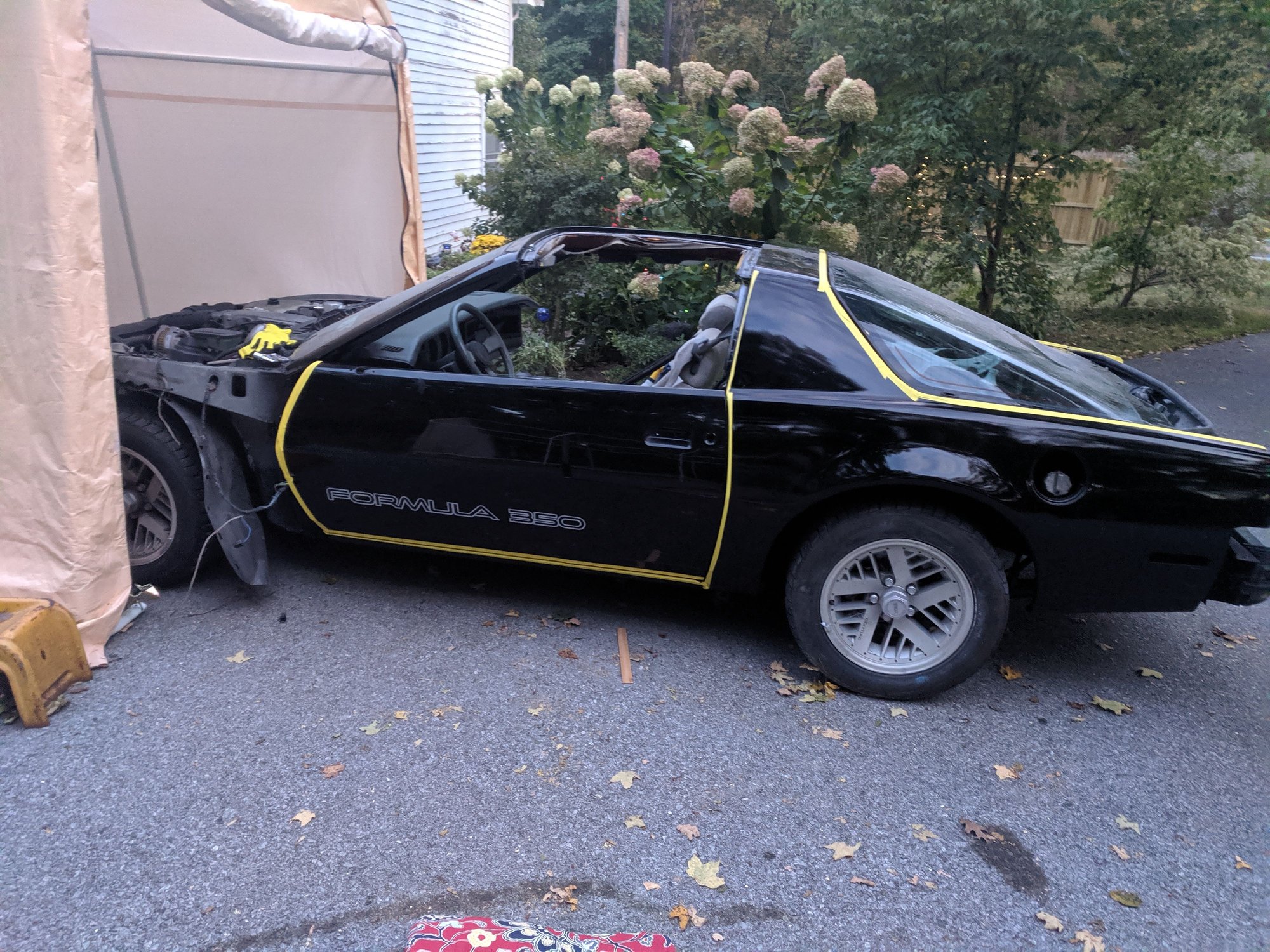

Well the building begins��
Some good and some frustrating..have a look..
The good..I hung a door by myself!
Bad...I can't get to align up and down. As soon as a tighten more than 1 bolt, it moves up.
A mistake...sanded through...arrghh
I re attached the t-bar with rivets after re wrapping it.

some updates, many frustrations. I am getting tired of it.
Well, adjusting the window and power motor I acidently tighted the adjustment bolts on this part and it snapped off.
So I taped off the edges for setting up the rear window Pulled it off today and I am SCREWED. I stared to wet sand and of course its going through to the primer. DAMN tape ate right into the paint and i waited a WEEK as instructed before taping. Not sure what I am going to do about this. I am running out of warm weather now.
I isntalled this in a rush and messed up a bit. The 4 screws that are part of the bracket are not lined up right. So I have loosen and adjust. Not sure if I am in the mood for all this any more this year.
I am considering moth balling this until spring. Too many screw ups and I am growing very angry over it. Mostly the stupid tape eating into the paint. The really gets me so ticked off.

Yikes......that tape issue is a major deal. How long did you leave it on there? Did it do it to the doors, too?
too long I guess. I few days. I didnt think that would happen. The doors are already buffed out. The tape did not thing to them, they are fine. Must be the paint must be sanded, cut and buffed. Cant tape it I obviously prior.
I have to sand it out. mask it off and shoot. Problem is weather now. The warm weather is done this week. Going into the 60s next weekend. My saving grace if there is any. Its single stage, so I can sand it, scuff it, then paint. Then sand it to blend it. Just a bunch of unessessary work I could have avoided. I am so angry over this right now.

Well I just spoke to Eastwood support. So I can scuff up the bad areas with 600 grit, mask it off and paint again. Then sand down and blend, more work but better than a repaint! Hope the weather gods give me some more warm weather the next couple of weeks.

I believe I'd tell them they need to reimburse you for the paint, labor, etc. And tell them to stick that paint in their rears!
Also, if it were me, I'd just scuff both rear quarters and roof and just respray the entire area. I wouldnt do a blend if you don't ABSOLUTELY have to. It's not that much more work to just spray the rest of the panels.....

Originally Posted by TTOP350
Sounds like solvents were still coming out of the paint, then when tape is put over them, the solvents go to work on the sticky goo and it makes a mess of the paint and goo. What kind of tape are you using?
Yellow masking tape. The tech said I did wait long enough but I guess I left it too long on the car. About 3 days, never again.
Well the thing is the car is just about put together, so yeah I am thinking of doing that but I have not sanded any part of the car that has been affected. So just mask, scuff and paint. The sanding will be all the same.
As far as getting a refund, its a hit or miss. Its not like its the whole car, and I did leave it on there too long, thats my fault.
Yellow masking tape
Now I am no painter, but I would have used the blue painter's tape. It removes after being left on for longer than you might have wished.
An old painter's trick for masking areas where you want the tape to come off easily is to stick the tape to your pants or shirt enough times to pick up some lint.
Then it won't stick as much.
Old Sep 30, 2019 | 11:38 PM
  #135
dagwood's Avatar
Top Answer: 1
Posts: 2,678
Likes: 1,267
From: In the paint booth!
Car: 1986 Camaro Drag Car
Engine: 383 on Ethanol
Transmission: Automatic
Re: My 1989 Formula 350 restore
Yellow masking tape
I'm a professional painter in a body shop. I use GREEN 3M masking tape, ONLY. The blue is probably ok for latex house paint, but sucks when used on cars.

I wonder if the tape it’s self is the problem. I’ve always read to use automotive grade masking tape. Different types of adhesives maybe?
Well supposedly yellow masking tape is automotive grade. D@mn stuff sticks to itself better than anything else. I am considering switching to blue but I thought that was even more sticky.
I have heard of the trick of using clothing to make it less sticky but forgot about that. Thankfully a scuffing, paint and wet sand fixes this as per Eastwood. Which I can attest to being I did it already on my door edges a few weeks ago. Comes out perfect.

I always use green 3m tape. I know when I delivered parts when I was younger all the body shops used it too.

Rough day today. Taping off around affected area still getting messed up. So I free handed most of it. Seems this Eastwood paint doesnt like tape even for a short period until is is wet sanded at least, first. Anyway Should be wet sanding it this week weather permitting. Hopefully back to together by next weekend and buff it out. Sorry no pics, cell still crashes, even when trying to take pics.
