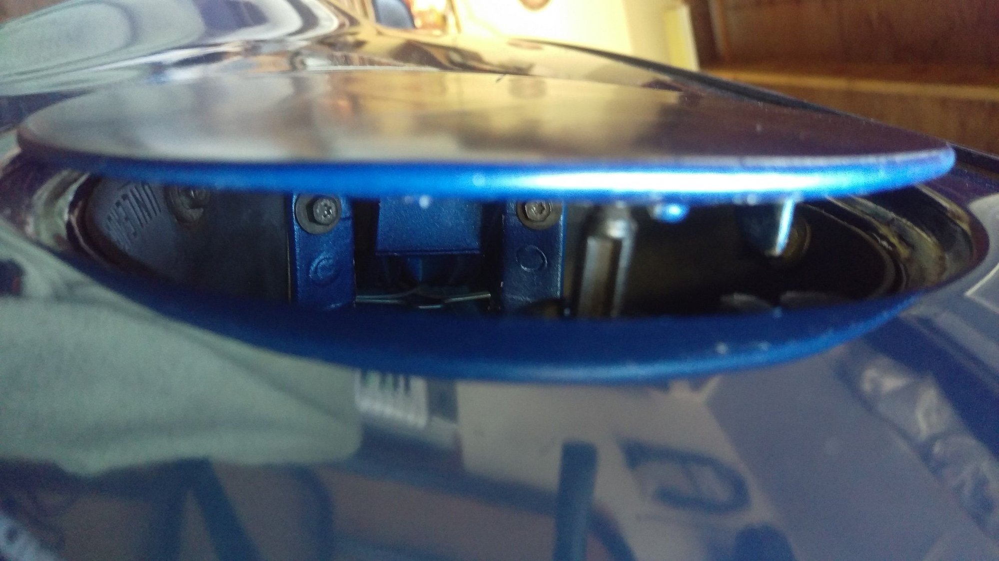

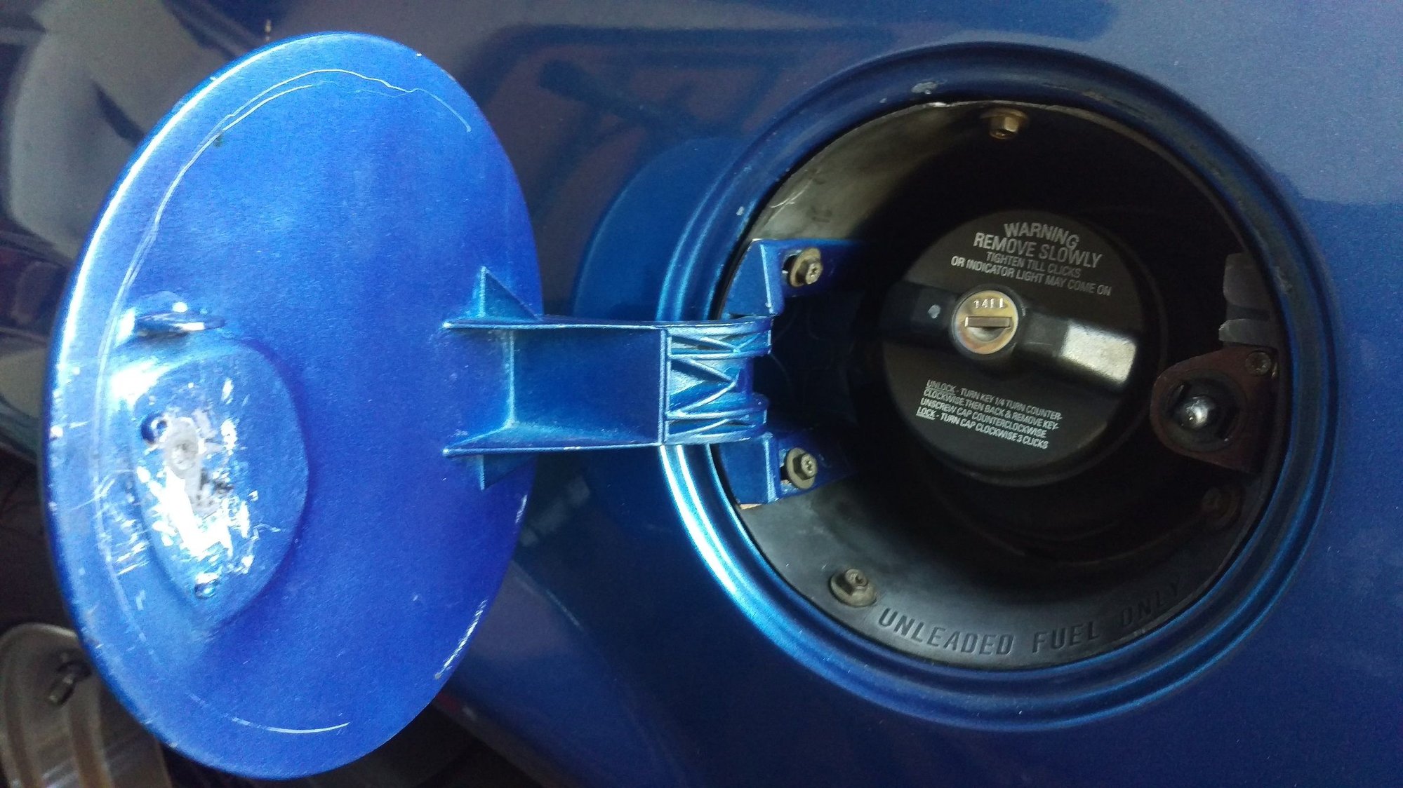

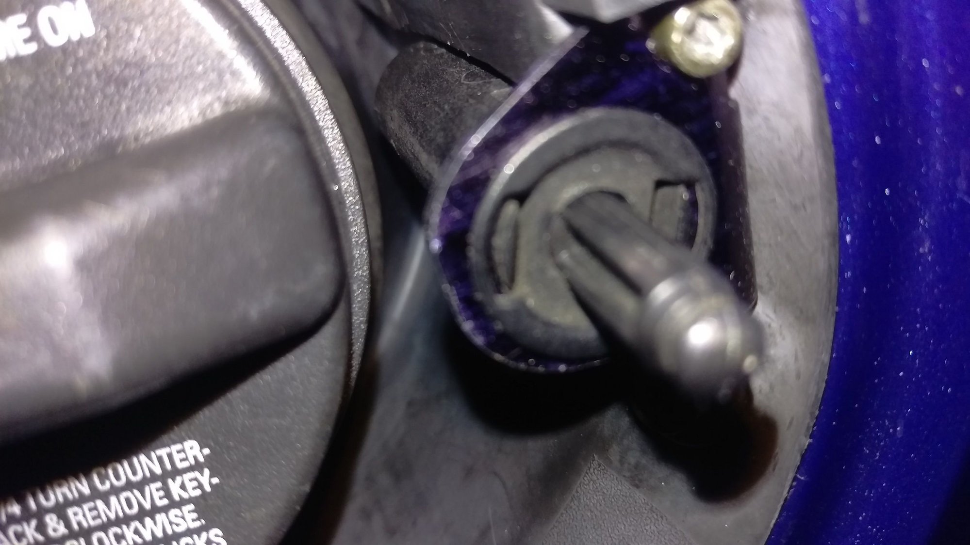

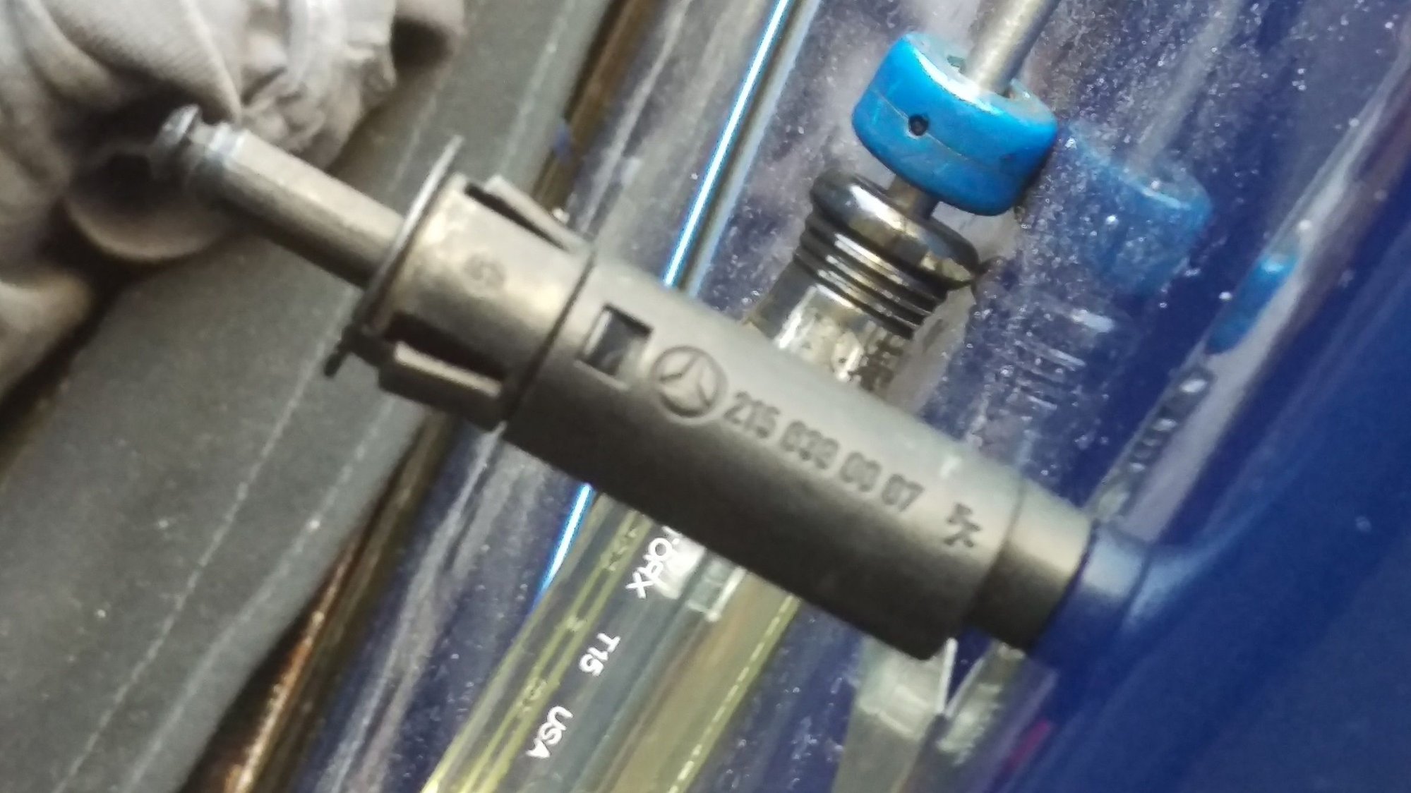

Or whatever its called.Had my lid left over from my 84, minus the cable release.So i got one of them click release thingys from some GM car at the JY.
Made a small bracket from aluminum to mount it.Using the old height adjuster, plus one other screw to secure it

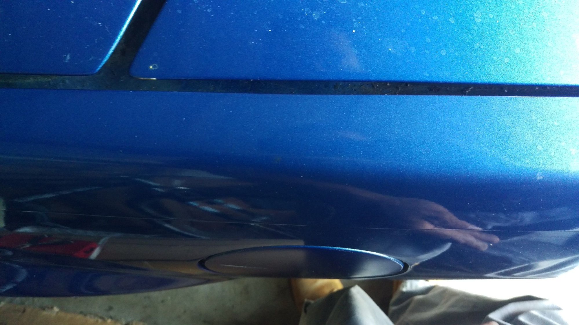

Not the best way to show it working, but!
All mounted up and working.
Got it to sit flush. There's more to it, but that's the jist of it.
