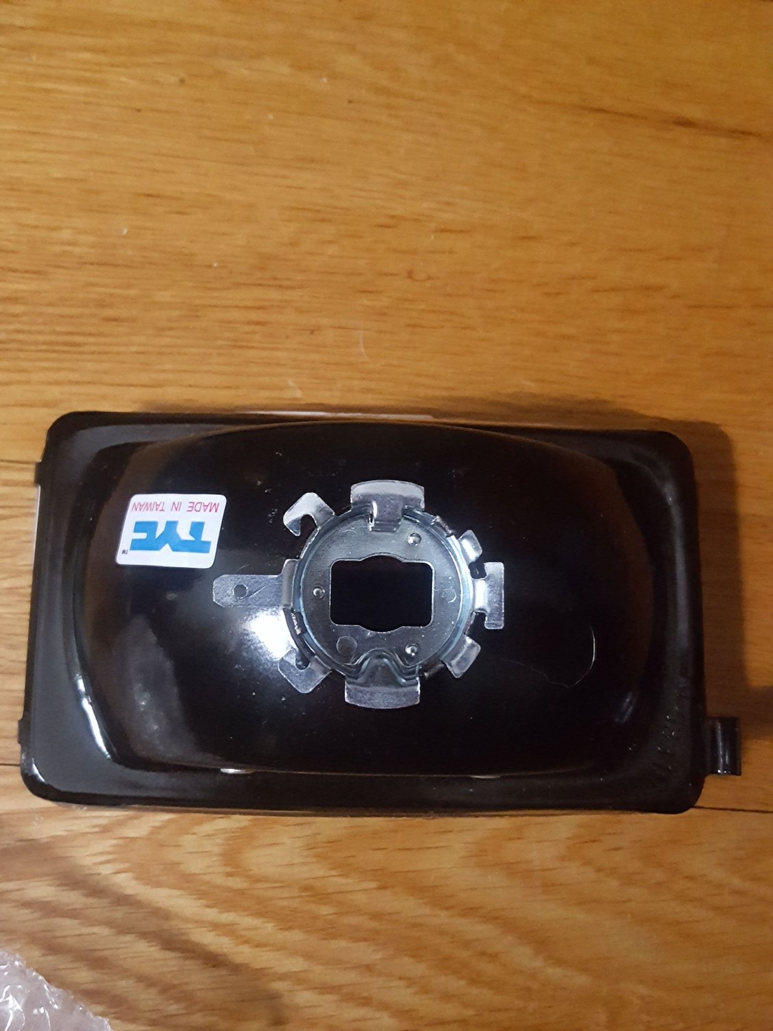

My car the fog light passenger
I got a new from rock auto and the old one pics look nothing like mine
it's a tyc brand housing

Rock auto sells just the lens and reflector/bulb socket, not the entire bracket and bucket.
You take the two screws out of the front of the bucket and the lens and reflector come out.

My new one the lens is glued on to the housing making it impossible to come apart
my stock on was what you just said
but it was rusted to **** for 30 years and it was cracked leaking water in there
not working

I guess I don't understand what you are asking. Why are you trying to take the reflector and lens apart ? The bulb loads from the back.

How do I attach the new housing on ??
it doeesnt have 2 bolts it has nothing

The plastic brackets being held on by the two screws hold the lens and reflector in place.

I'm telling you my new one is glued on factory
my stock ones are like what you just said
It's winter here
I just have to wait untill the snow melts before I can get it up on my ramps
I thought it would be easy today
But it wasn't
you want to see more pics if the new one
all of them on eBay are like that
I just have no instructions to how to put it on

I still am not understanding. Take the two screws out and the plastic brackets on the sides to remove the old lens and reflector. Put new lens/reflector in. Put plastic brackets back and tighten screws.
Whether or not the new lens and reflector are glued together has nothing to do with anything.

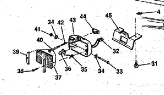

I swear they are putting stupid in the water lately.
Rock Auto sold you #37 in the diagram. For the love of God, figure it out.

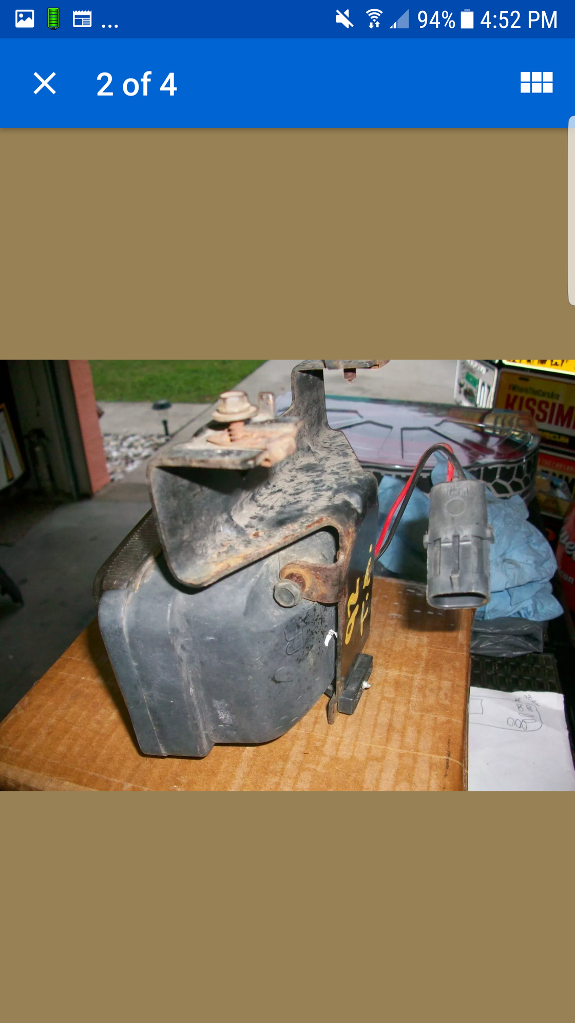

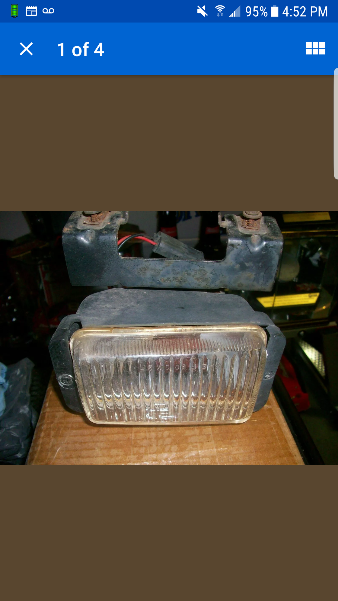

my stock one looks like this
and my rock auto one doesn't
that's what I'm saying
