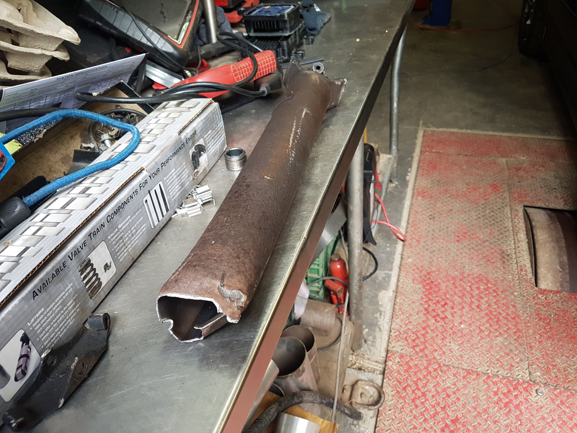

Well, I'm a bit quiet on this board, but I have an 87 T-Top T/A. I've done a lot of work to it, including replacing floors 2 years ago (and part of a sub frame, bottom of the a-pillars along the floor inside and out etc). I have an LS1/T56 swap, 4th gen axle with some goodies etc. I was at the dyno last week getting a tune done after a cam swap and long tubes, injectors etc and the stock drive shaft (the only thing stock left in the drive line of course) blew up in to 3 pieces. One put a fist sized hole right through the floor over the tail of the trans, it looks like no console damage. The other parts of the shaft pushed the torque arm to the drivers side floor, and split a big section of the floor longitudinally and even pulled it away from the big subframe extention in the rear (sort of like a big doubler that wraps around the back portion of the floor). It really, really has me bummed.
The drive shaft let go at approx 6000rpm in 4th gear on a pull, so it was spinning pretty good. Luckily a buddy showed up with a quality aftermarket one to finish the test day up... And it is now in my car. He saved my butt for sure.

As far as I can tell, it looks like the shaft initially broke at the yoke at the trans, and then when it rotated around it smashed halfway down the car and snapped there and then it just beat up the bottom of the car as the dyno slowed down. I at least got it on video! Told the guys at the shop before we started to tune that if the car is going to break I wanted it to break at the dyno instead of the street. I did put in heavy duty u-joints the week before, so I doubt it was a u-joint that caused it.
Not sure if I will put a driveshaft loop in the new car, new drive shaft is rated for 1200hp. But, I might fab one up.

Well, here is the pull when the Drive shaft let go:

Wow! That driveshaft twisted apart like a cardboard tube! A driveshaft safety loop probably wouldn't have prevented the damage, this time, but your new one is so much stronger, that the u-joints are surely the weakest link in your drivetrain now. On my T-56 in my '90 RS (Built LS-7) I kept breaking yokes (Transmission). I had a lot of little dents in my trans tunnel, but it got to where I could Carry spares to the track and have it changed out in time for my next run.
