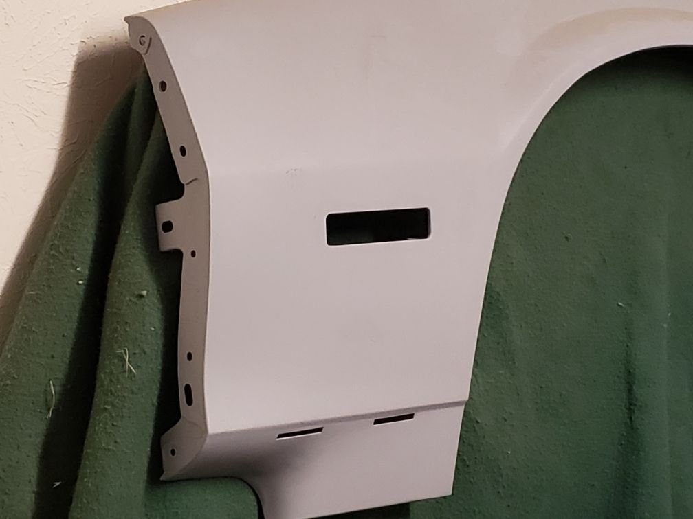

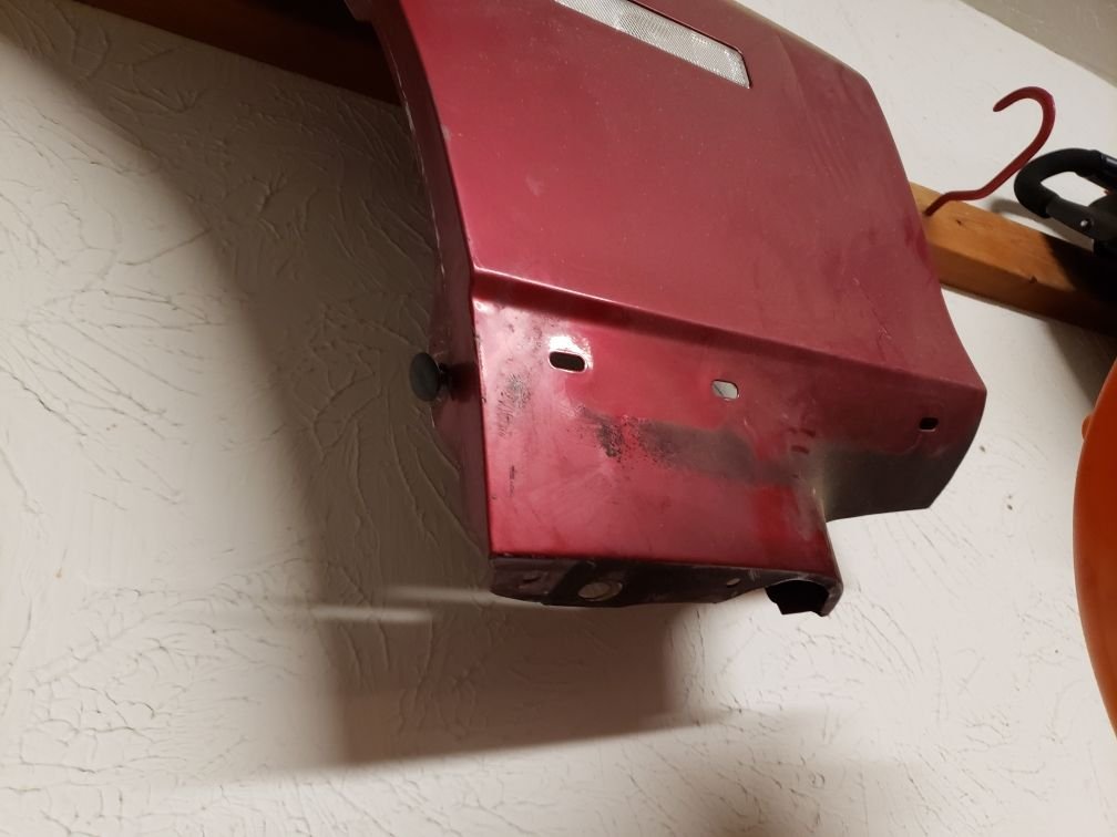

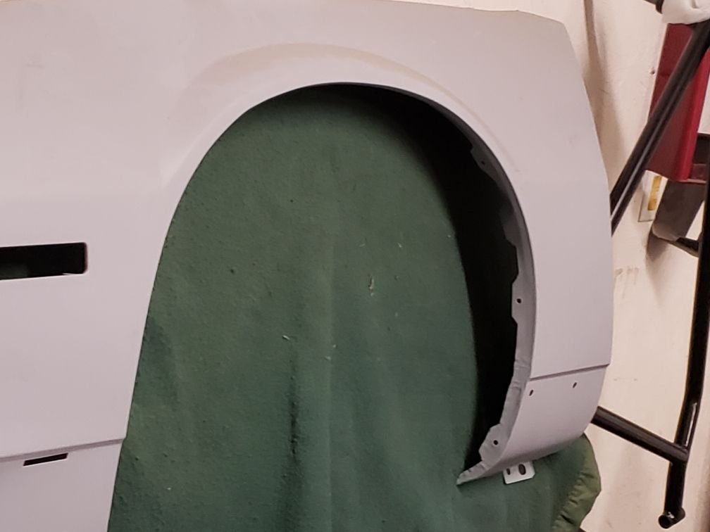

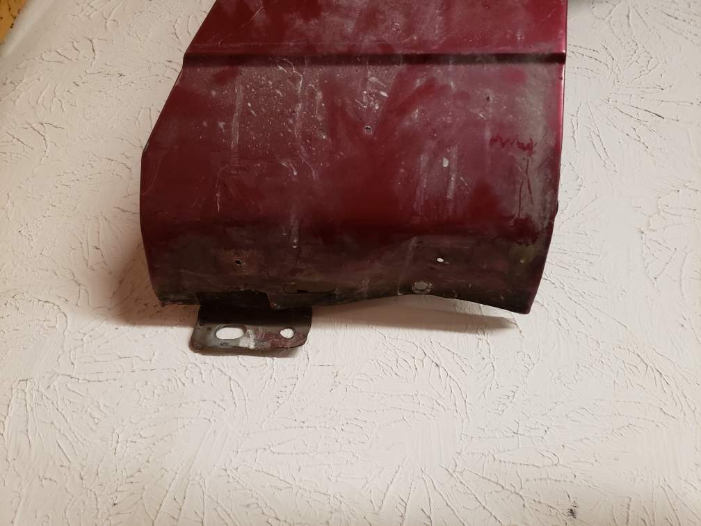

Hopefully this helps, and they are not the best pictures. The fender in primer is a 91/92 and the bent fender in red is 1990.
1990 rear
1990 Front
91/92 Front
91/92 Rear

PERFECT!
Thanks you very very much. I will reference these images as I correct my fenders.
I will post pics in my build thread when I get to it.
Thanks again!
