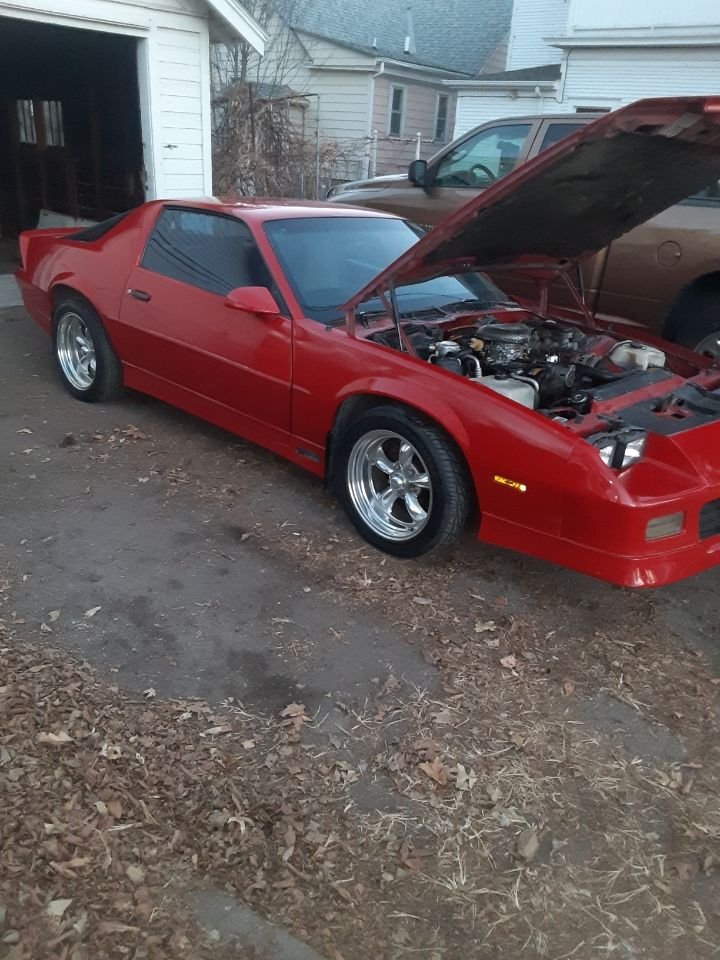

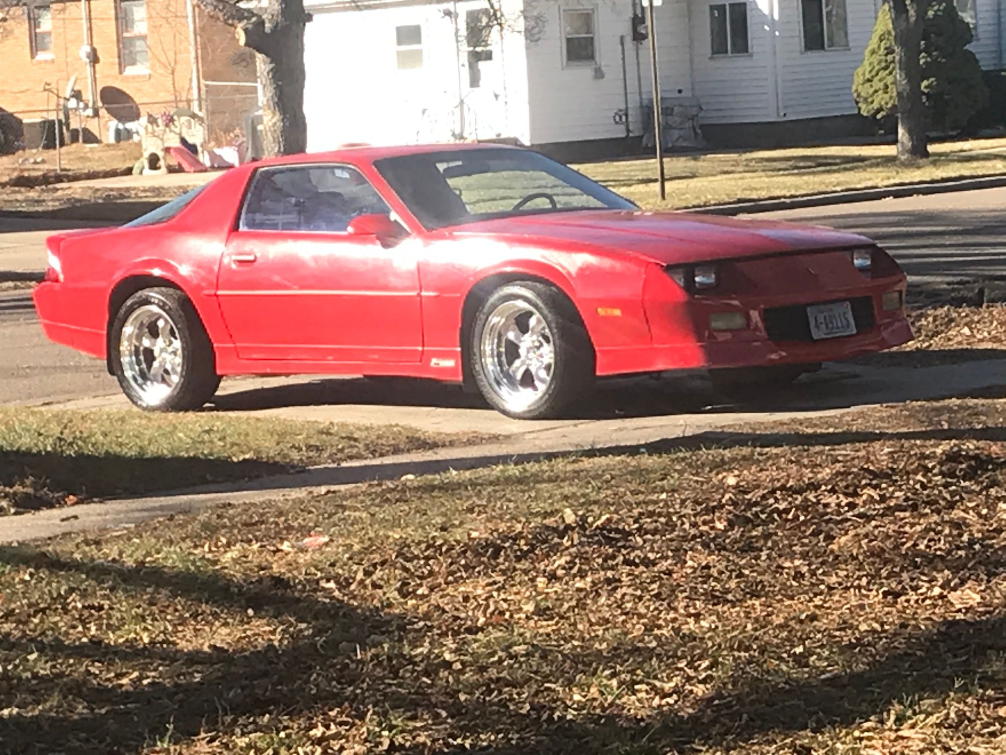

Is this rs or iroc
I have a 1989 camaro badges around the car say rs but I did a vin look up and it’s coming back as a iroc has lo3 engine and a t5 transmission the door handles say limited edition what’s just wondering what you guys thought

I'm going to go with RS. If it was an IROC it would have a hood with louvers and also fog lights. Plus it would be a lot of work to make an IROC look like an RS by putting the RS badging on the ground effects and changing out the hood, and usually it goes the other way. The LO3 was available in an IROC in '89, but 20k Irocs were produced that year vs 83k RS cars, so once again I'm leaning towards it being an RS.
