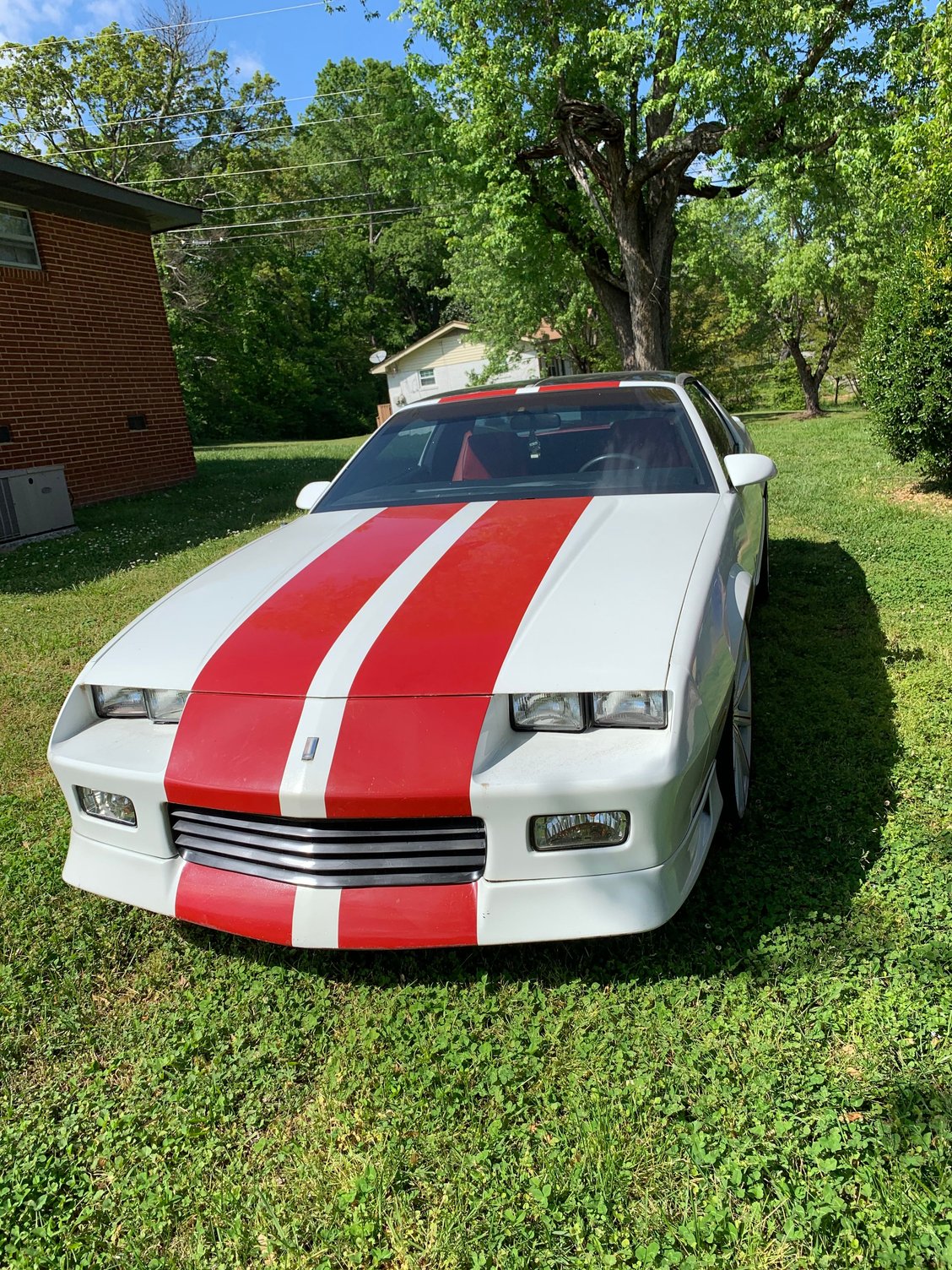

Hello all. My dream since i was 16 was to have a third gen Camaro. Just got this sweet baby today and couldn’t wait to take her tops off and gawk at her, disbelieving she’s really mine. The thing is, when i put the t tops back on, one of them is slightly wobbly. Should the glass have any give at all or did i put it back on wrong?
Also, thanks for letting me be a part of this awesome community

Welcome btw, nice car, more pics.

Cool lookin car, and welcome to TGO!
Like others have mentioned, the holes that the t-top pins lock into probably just need adjusted down a little bit. Removing the plastic trim that covers the front ones are a little tricky. Back ones are way easier. The seals have probably flattened over time and just need the pin keepers pulled down a little.
I'm also looking forward to some more pics!
