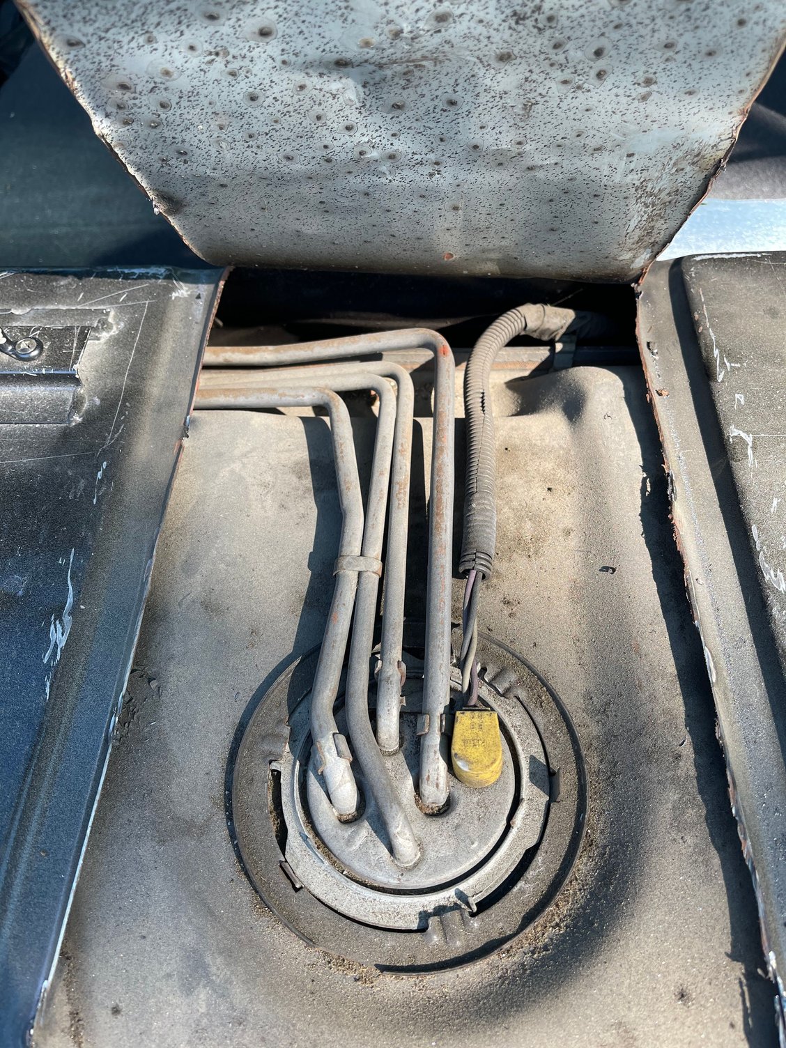

Fuel Pump "Access Hole" Hack Job
So…the fuel pump is failing in my ‘88 IROC-Z. Been reading the debate between whether to cut an access panel to be able to replace the fuel pump from up top, or do it the right way, and drop the exhaust and axle.
It dawned on me the car is 33 years old, maybe someone had cut a hole in the past…but I wasn’t prepared for what I found:
They basically cut an 18x8.5” on three sides, folded the remaining sheet metal back, didn’t seal ANYTHING, then tack welded two metal straps to keep the metal down.
So, this leads me to a few questions.
Since it’s already there, is this enough to allow me to go ahead and replace the pump from above?
How do I fix this disaster CORRECTLY? I’m not adverse, since it’s already hacked up to put a removable door SEALED in place…or have the metal fixed…but that’s likely expensive, and I’d rather avoid doing that right now…might be a better thing to have done when the car is repainted in a year or two.
Help!

Well, the one “positive” is the hole is so large, I shouldn’t have any issue pulling the fuel pump out from up top. I’m replacing the fuel sender at the same time, so if they’re hacked the lines, there should be plenty of room to put it back the way it was built….right?
The Nutserts sound like a good idea. I’m probably going to use that idea for making some sort of framing, so the metal doesn’t rattle back there.

I especially like the compression fitting you have on the outlet. Much more secure than a rubber hose, and a clamp.
I’m replacing everything in the tank except the lock ring…including the pulsator, and will probably make up a compression fitting for my outlet as well.
As far as the hack job goes, I’ll fabricate something that fits well, and seals, or a proper frame that secures the two pieces properly.
. Most likely, I’ll use Nutserts to secure it properly.

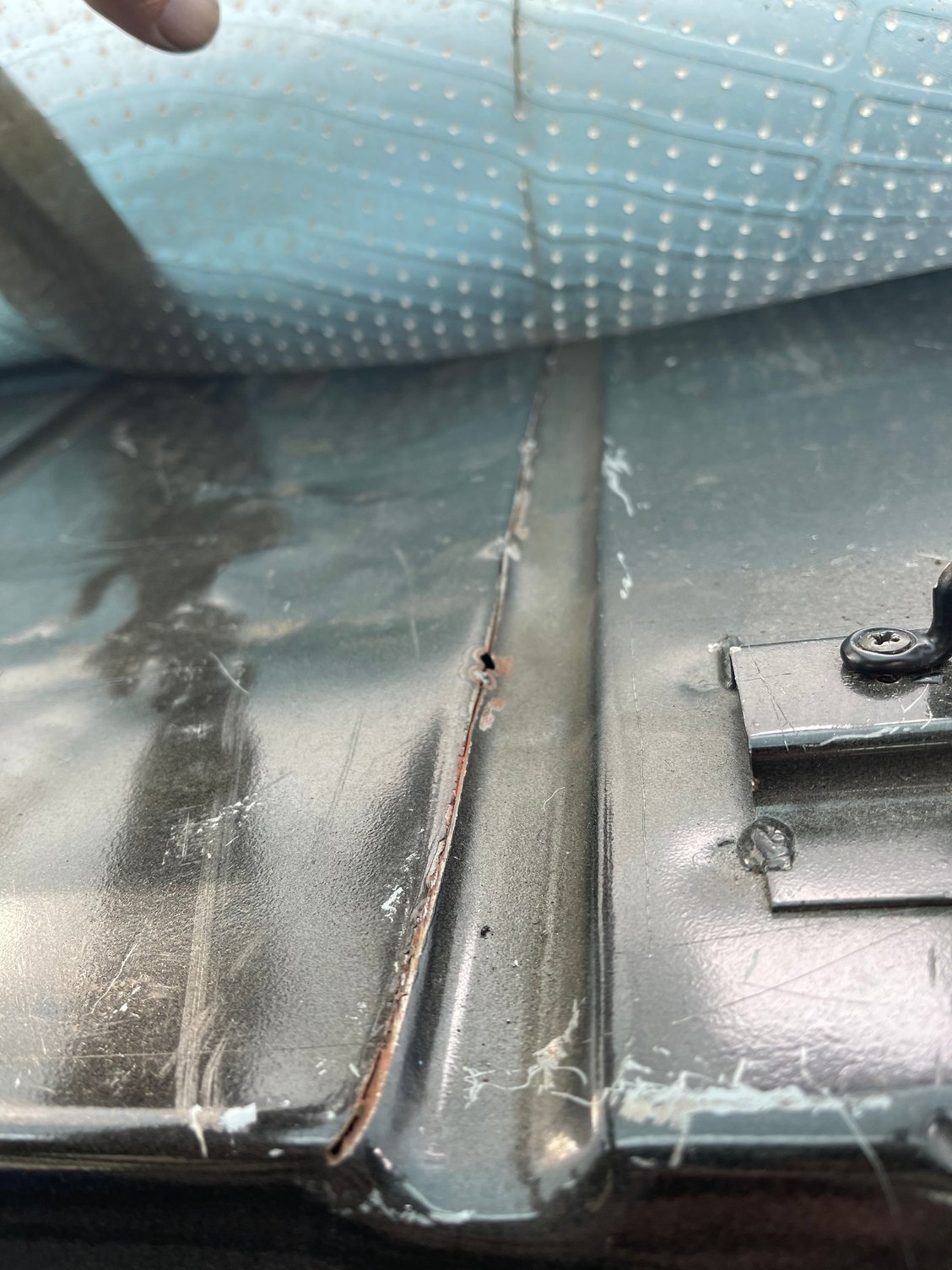

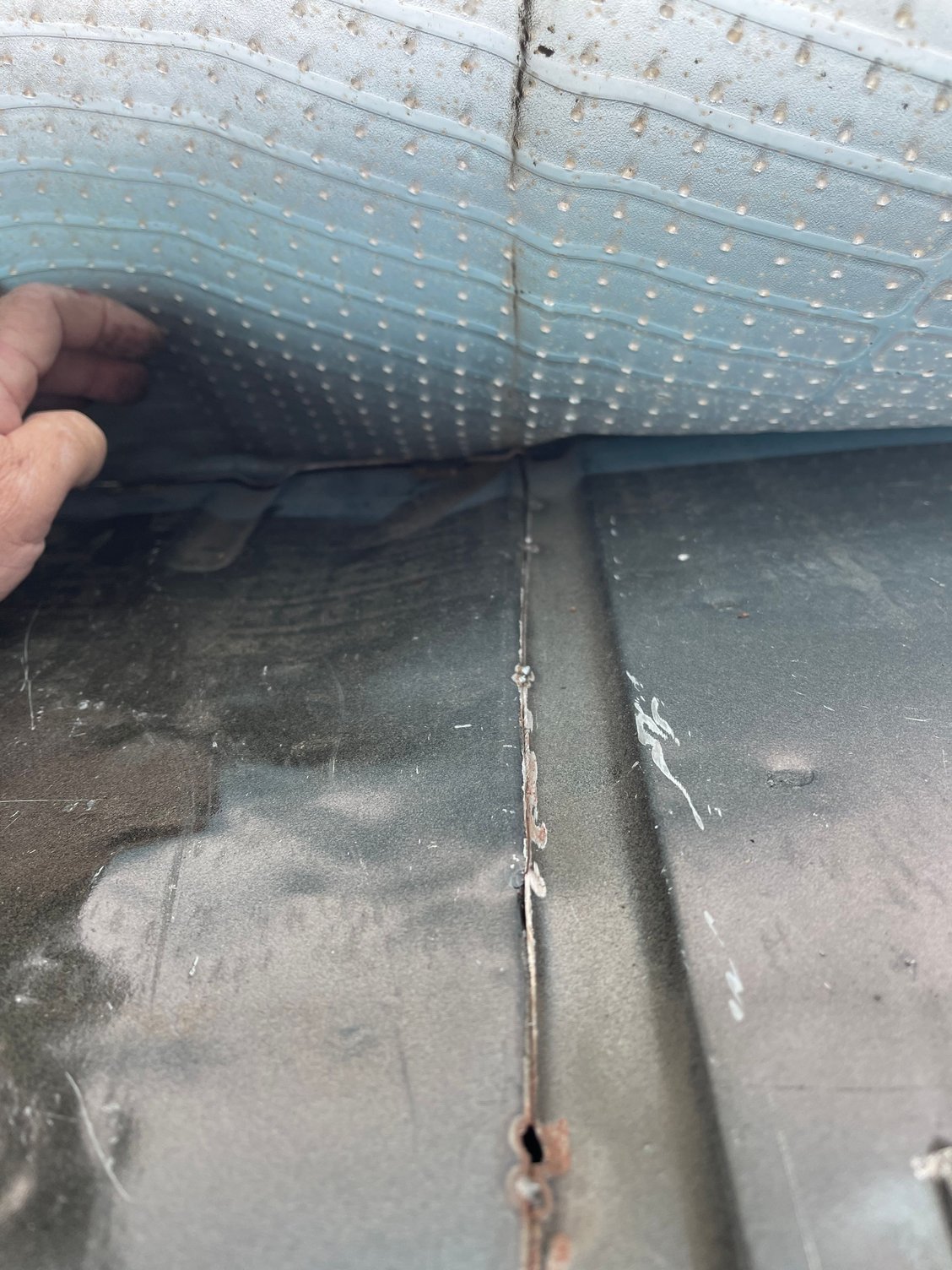

I’m actually surprised…
I used a Dremel with a cutting wheel to cut through the spot welds, to do the least possible damage to the surrounding metal.
Shocked to discover the lines haven’t been hacked up.

That is very surprising. I wonder if they cut the hole and could not figure it out. Or maybe later the tank was replaced and someone made it whole again

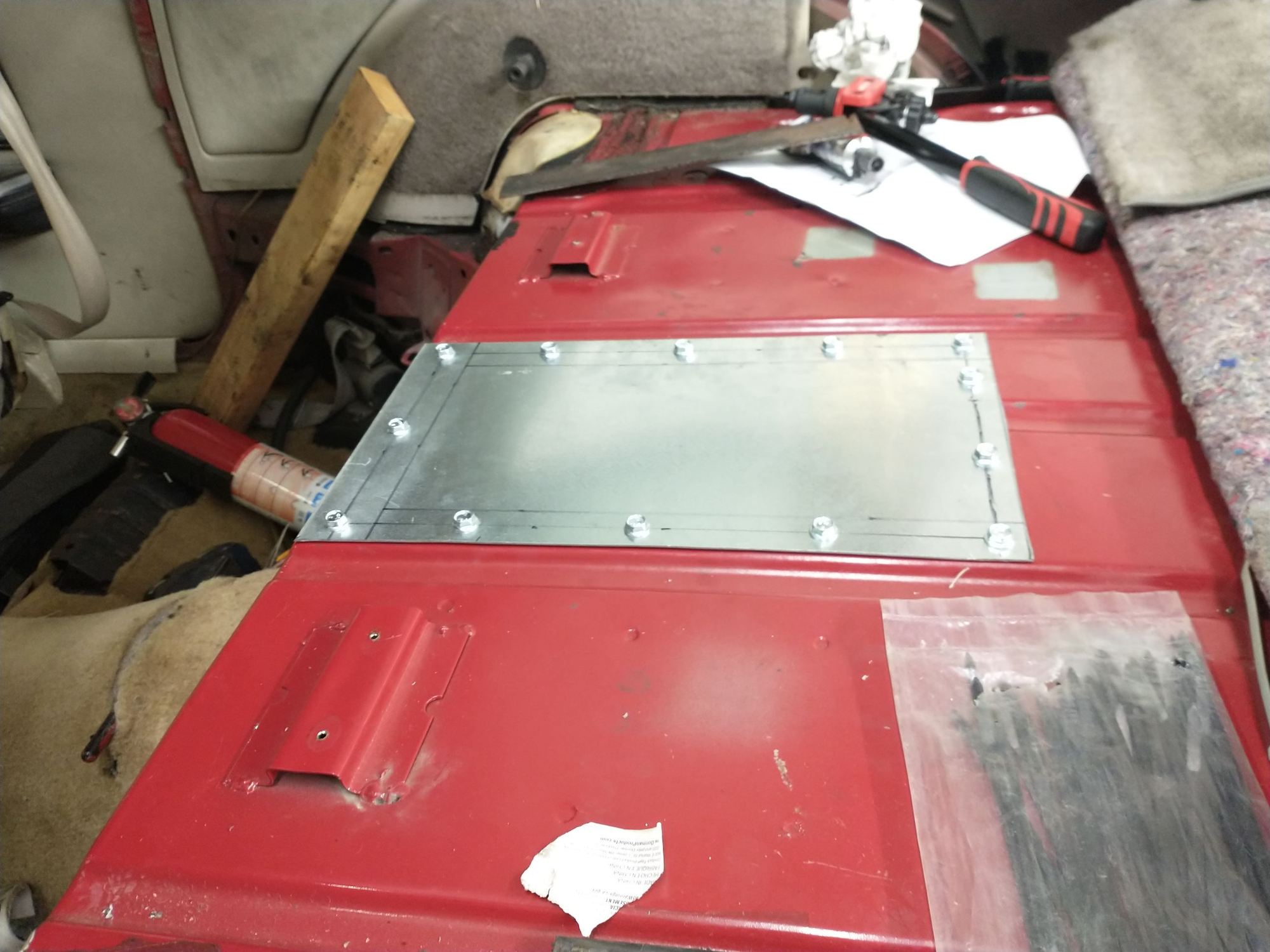

What are the dimensions of your cover plate?
I'm not sure. It's been covered with rear hatch carpet and is pretty hard for me to even feel under the carpet and jute backing.
