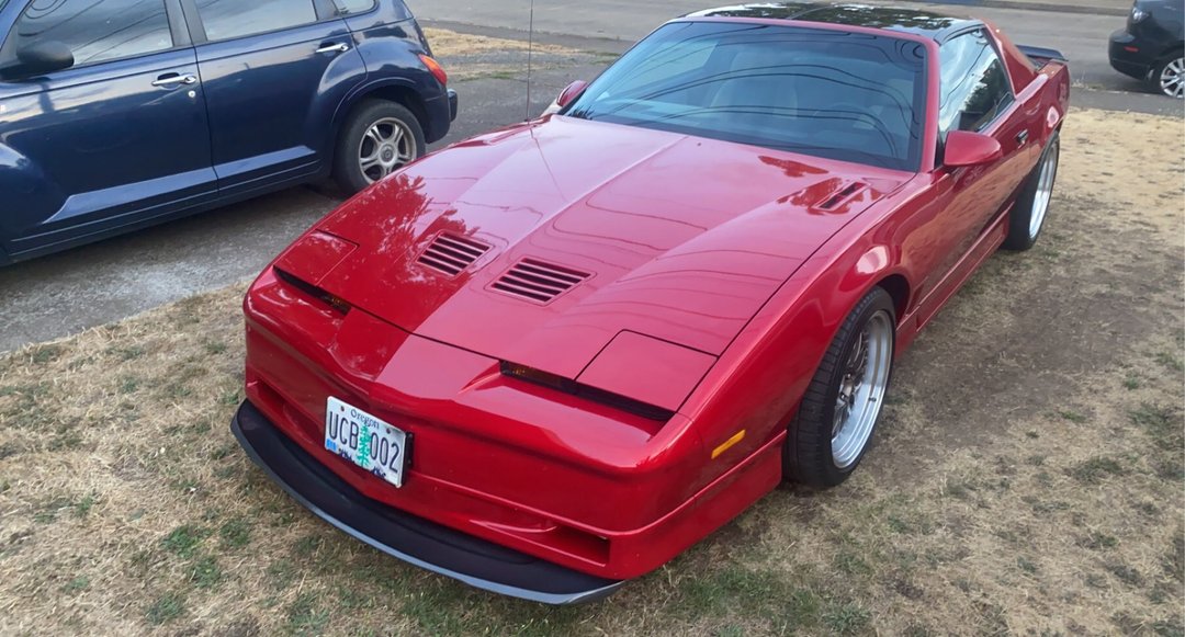

Point well made! Always looking for improvements to the lack of cooling with the grill-less aero package that came on my TA. I had the front grill inserts in for a while but did not care for the look and they never seemed to help with cooling. I have since repaired the stock air dam and added an additional 1.5-2" of plastic material to the stock dam. This and the removal of the hood gasket at the windshield has definitely helped with cooling temps down. The air seems to flow thru better. Was just trying to come up with something that did two things... assisted in the cooling and looked a bit more modern (those splitters on the new Camaro's, Challengers & Chargers really look sweet)

Thanks for the info... this probably works well for the Camaro as it has a different airflow setup than the Firebirds. On my '84 the uptake of air only comes directly off the roadway and is 16" back from the nose. The stock setup which was a single piece is a discontinued item and the superseded part GM 10118551 is 3 piece unit and almost non existent. I have checked all the GM part houses online and ordered it multiple times to receive a refund back because it is unavailable. I have seen it on eBay... but I am cautious about ordering. I was just hoping someone knew of a design for the 3rd gen Firebirds.
