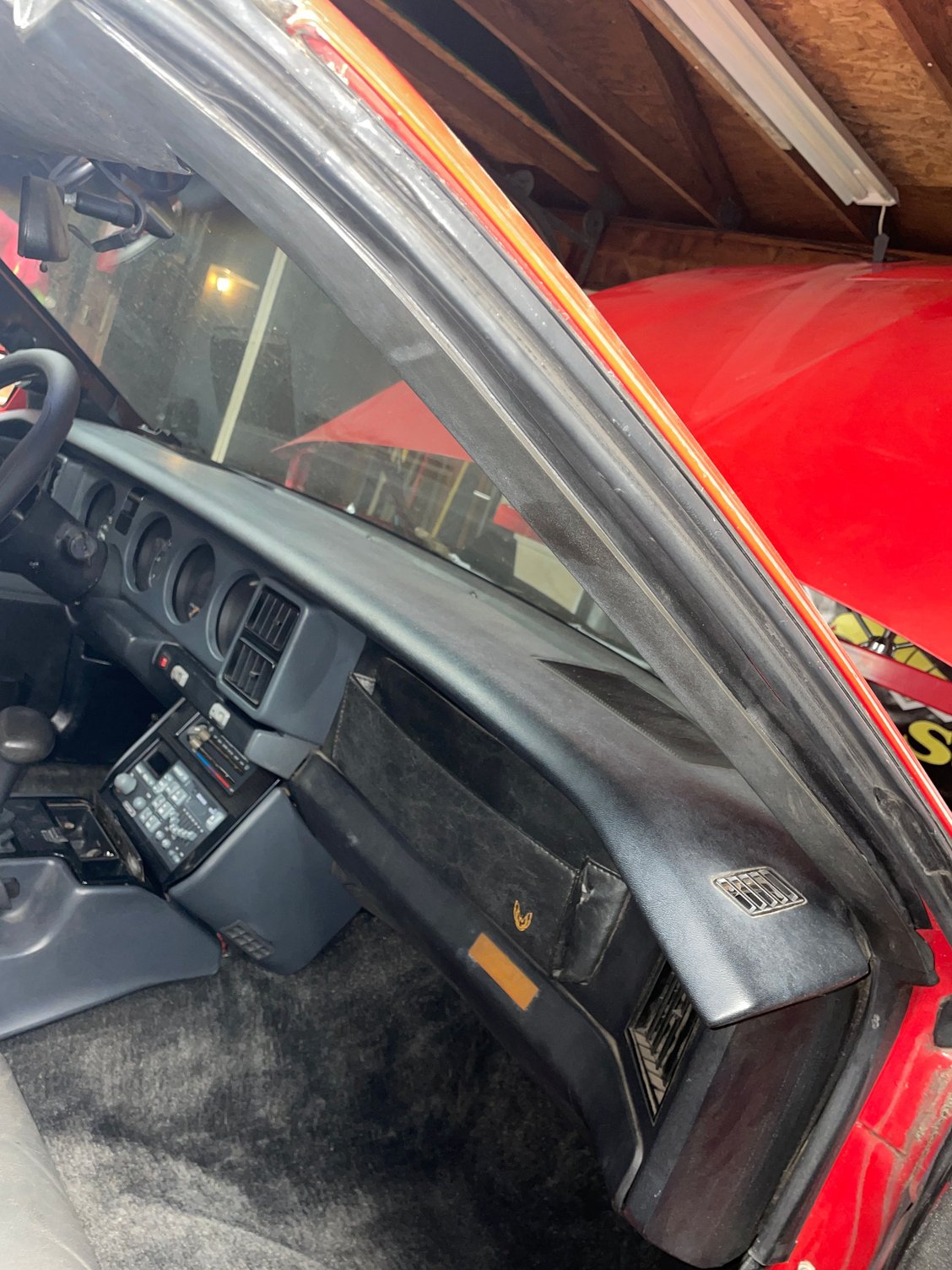

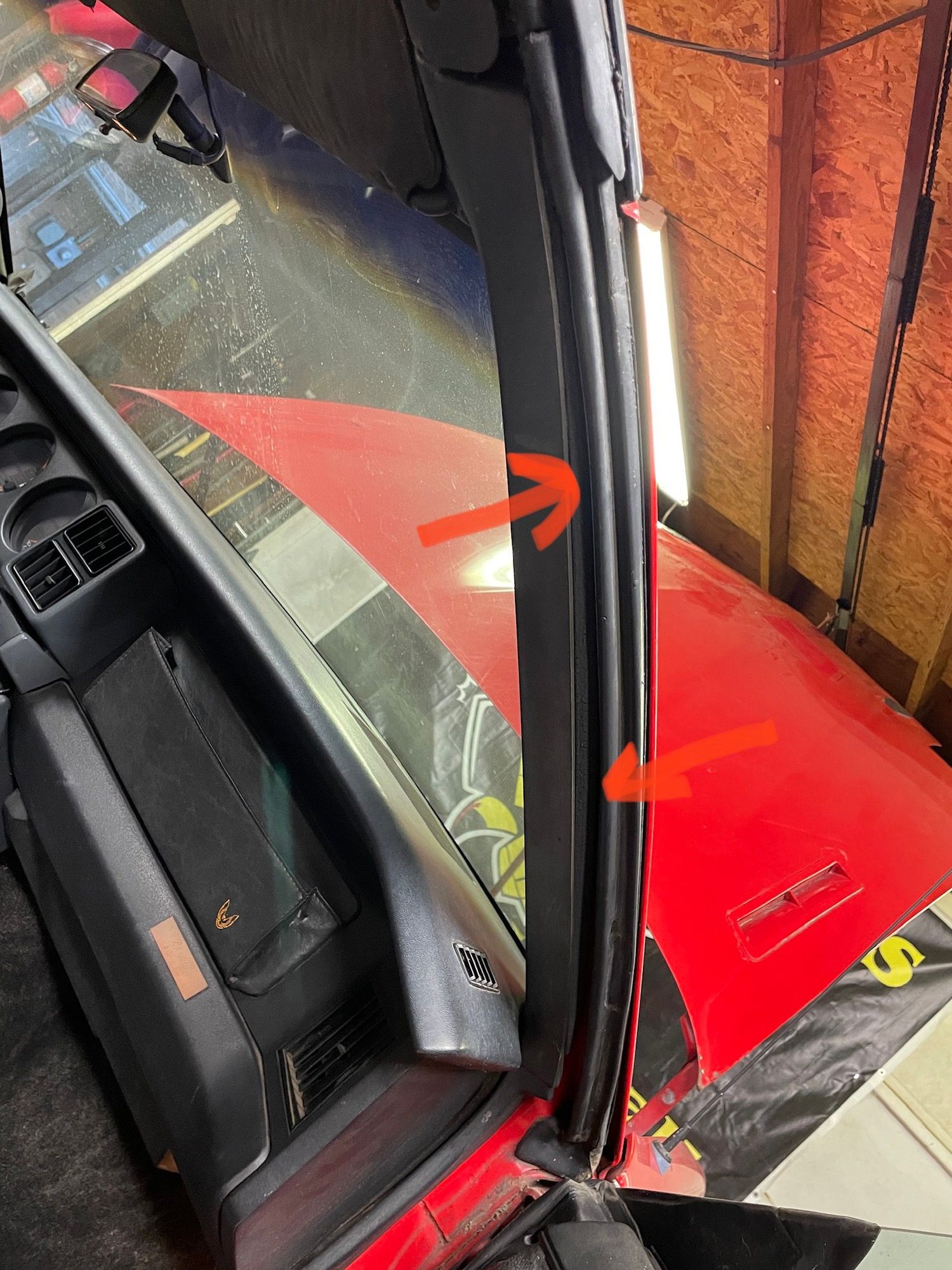

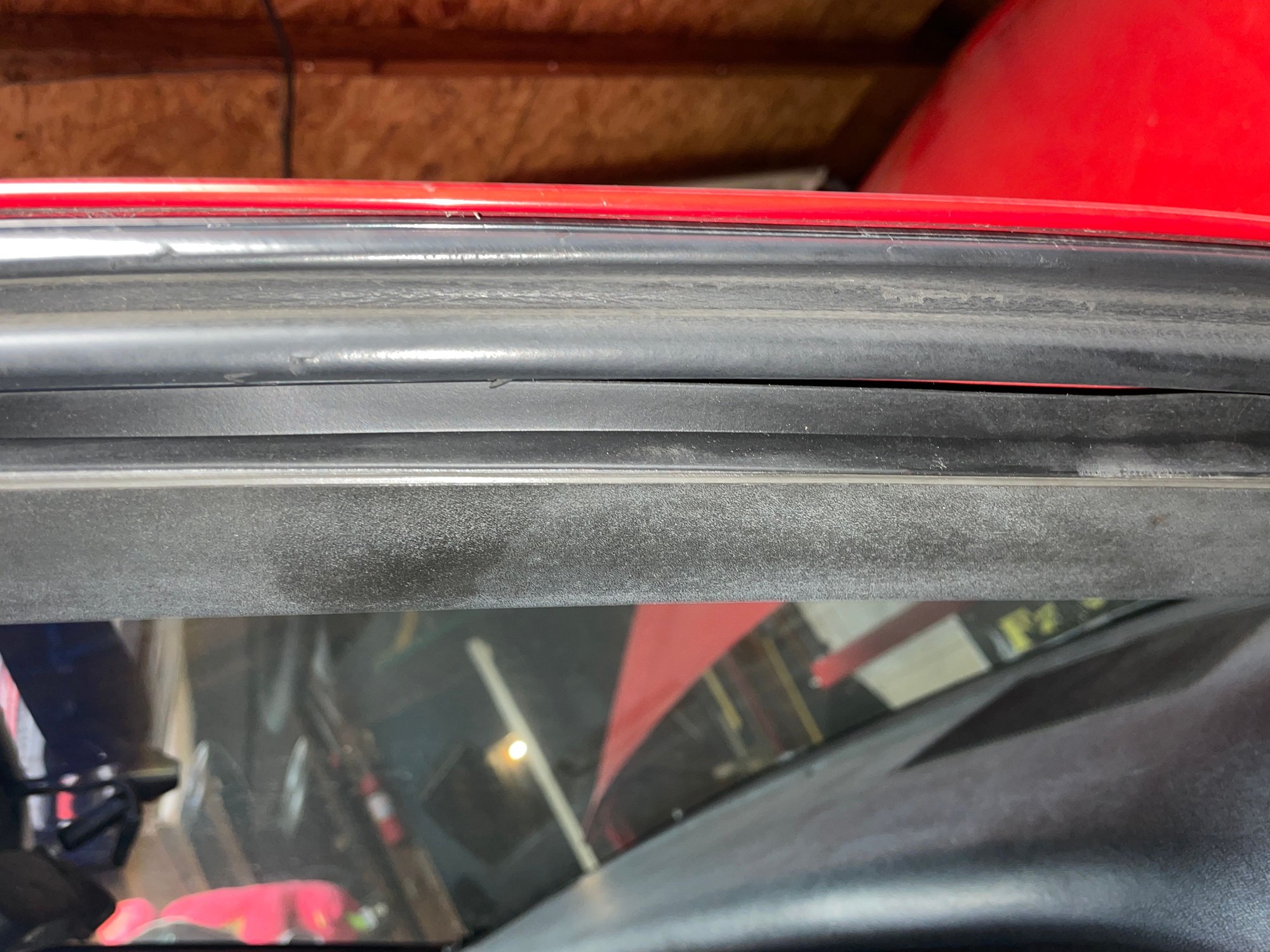

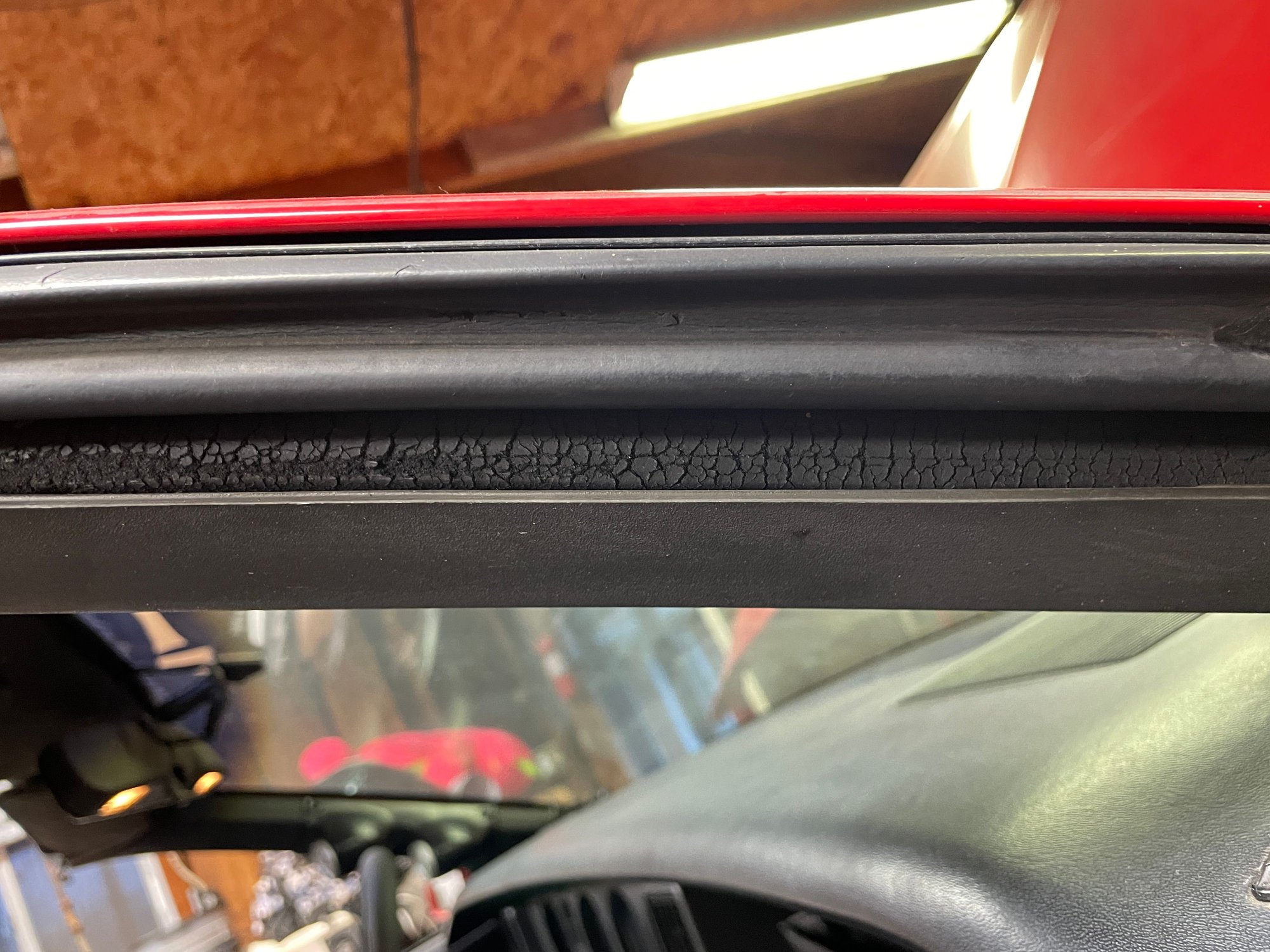

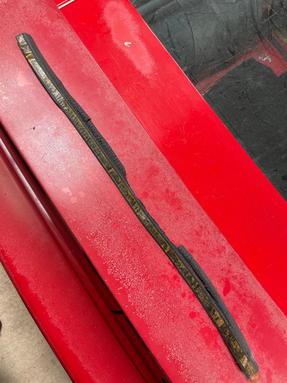

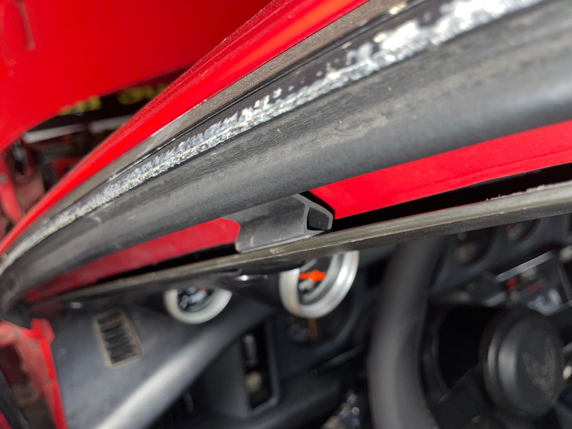

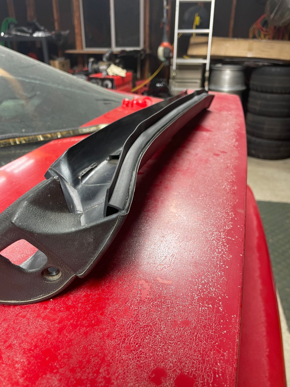

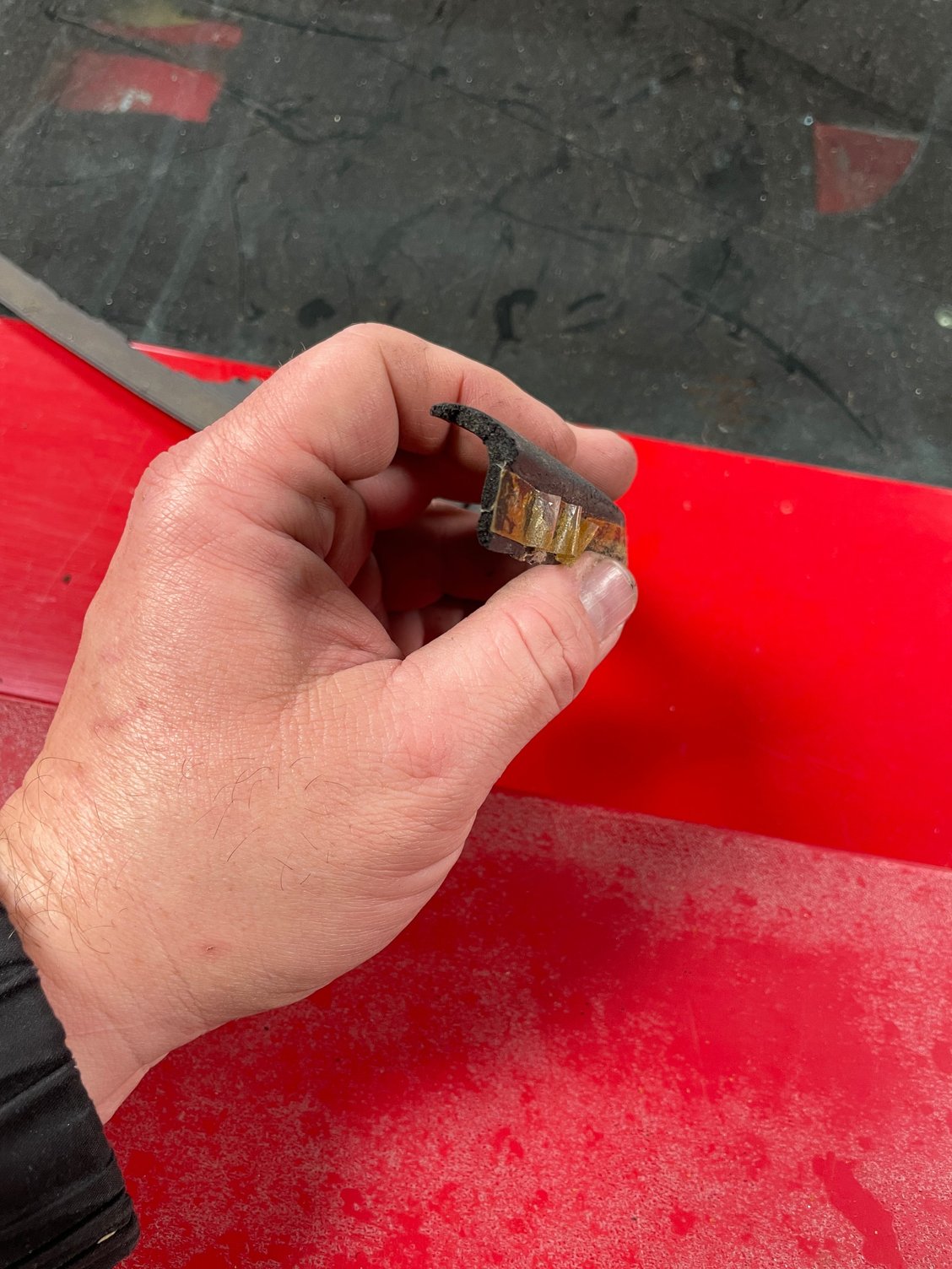

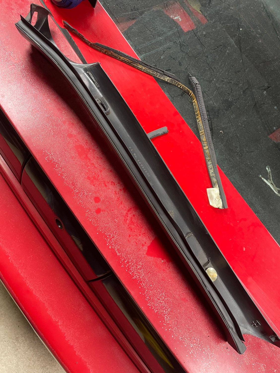

It’s the foam that is attach to the plastic A pillar cover, in between the plastic cover and the door from frame to window weather stripping.
Old Dec 18, 2021 | 04:02 PM
91banditt2's Avatar
Joined: Dec 2000
Posts: 2,341
Likes: 151
From: Cincinnati,Ohio
Car: 1991 BandittII Firebird
Engine: 5.7 HSR
Axle/Gears: 3.27 9 bolt

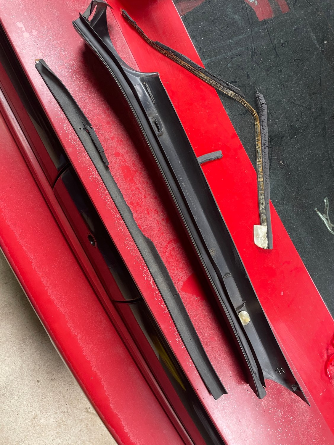

Re: T-Top A pillar cover weather stripping
Bottom with a thin double sided type tape
Top
Side profile
How does it even contact the window? It goes on the a pillar trim and faces the a-pillar not the window. Also the second link is the wrong one, not sure how that happened, but the adhesive is only half as wide.
Right at the very top of the window
Or does it, I’ll need to take another look with the window up
It does not. It fills the gap between the plastic trim and metal pillar.

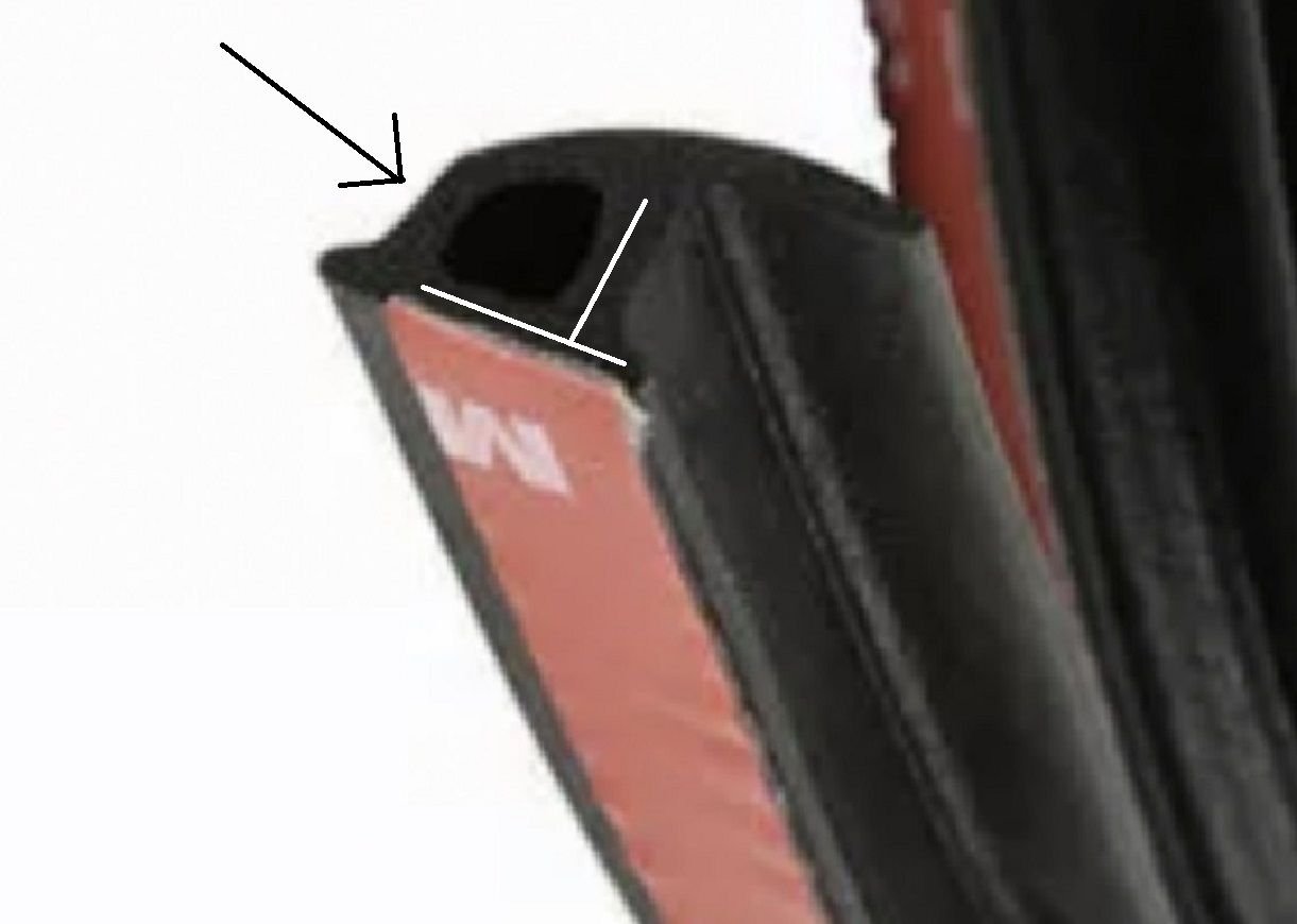

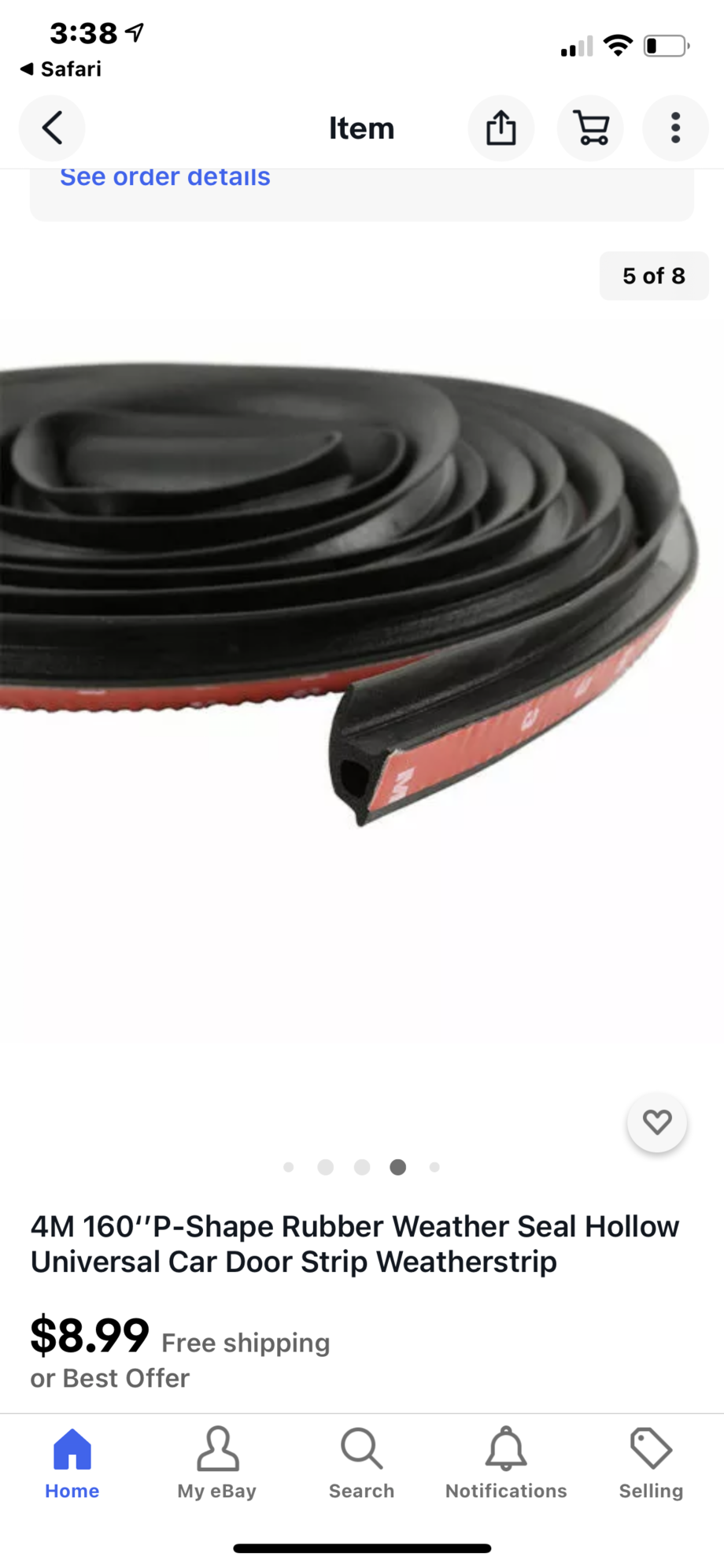

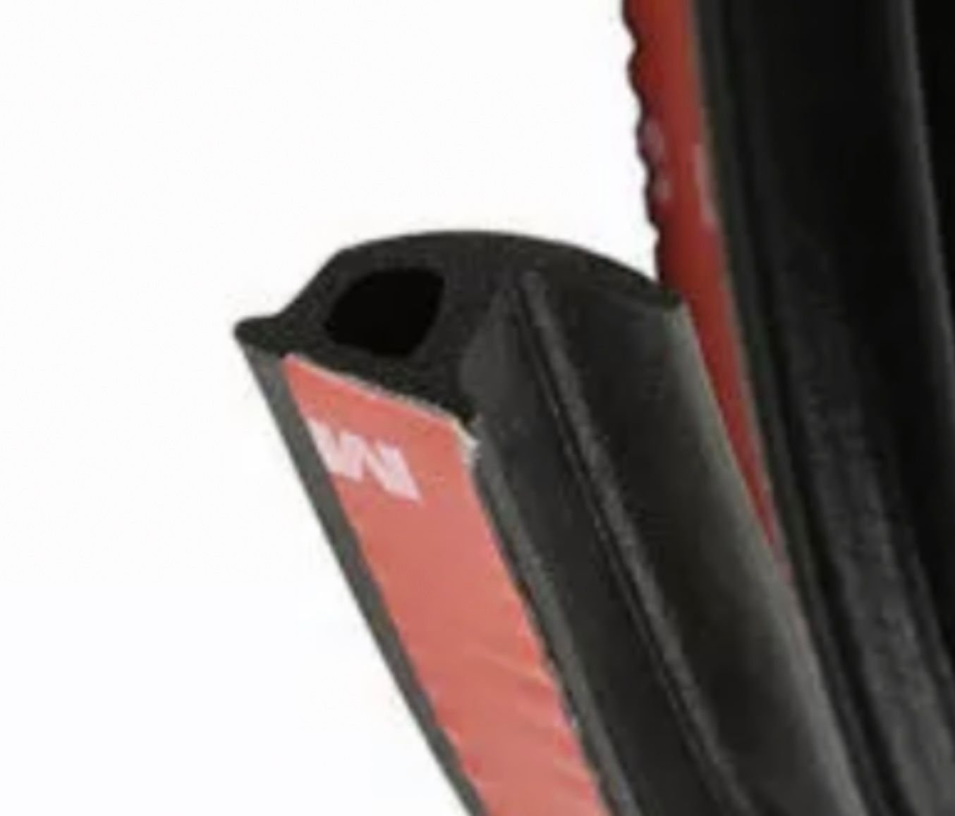

Looking at that pic, if you use the double sided tape to adhere that to the A pillar trim. The backside will face outward and the curved side will face the a-pillar.
Old Dec 27, 2021 | 03:15 PM
91banditt2's Avatar
Joined: Dec 2000
Posts: 2,341
Likes: 151
Engine: 5.7 HSR
sticking this side to the top this may work as long as it’s big enough/small enough to fill the space. The surface that this needs to stick too is sort of parallel with the door sills, at an angle of course.
Old Dec 27, 2021 | 05:04 PM
84 1LE's Avatar
Joined: Nov 2002
Posts: 6,664
Likes: 414
From: Oyth
Car: 89RS vert
Engine: Erod
Transmission: 4L65e
Axle/Gears: BW, 3.27
If the tape was by the arrow, it be much better. You could even cut away the section in white.
Old Dec 27, 2021 | 05:21 PM
91banditt2's Avatar
Joined: Dec 2000
Posts: 2,341
Likes: 151
Engine: 5.7 HSR

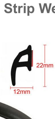

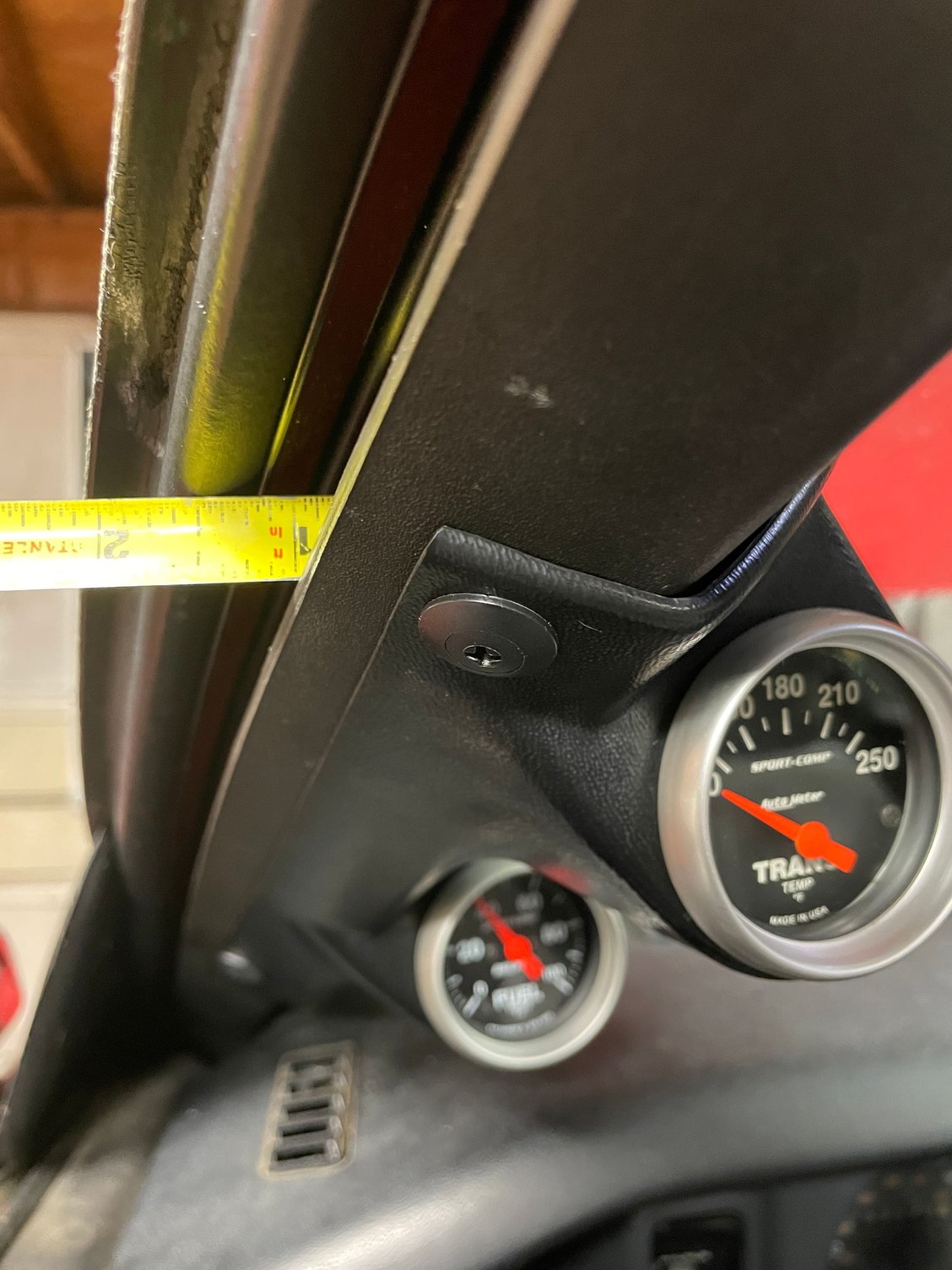

22mm = .866, the space between the edge of the A pillar cover and the actual A pillar is pretty consistent from top to bottom at approximately an 1”, so where the adhesive is I think/hope it’ll work
This in the middle top and bottom, towards the top it narrows a little under 1”.
yeah, its not a huge gap, i figured about 3/4 tops. That foam looks plenty wide. Post up when you get it on there.

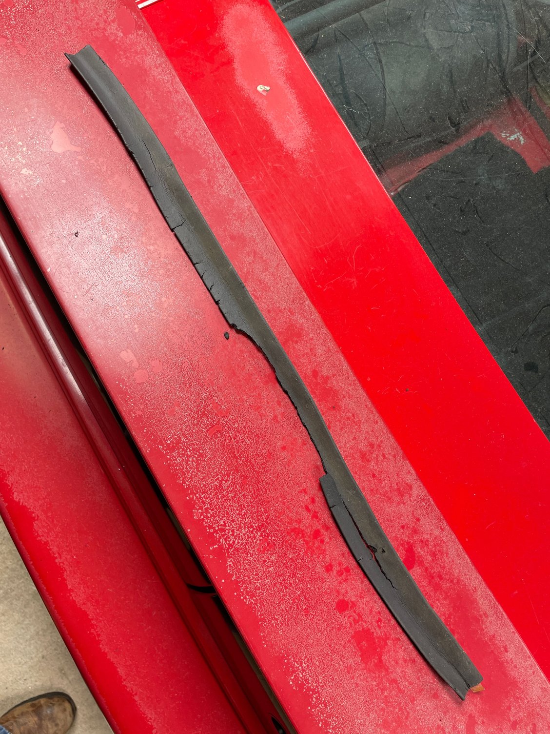

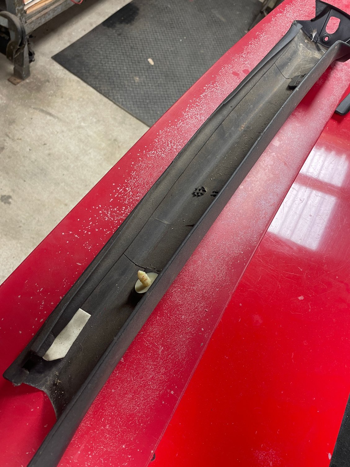

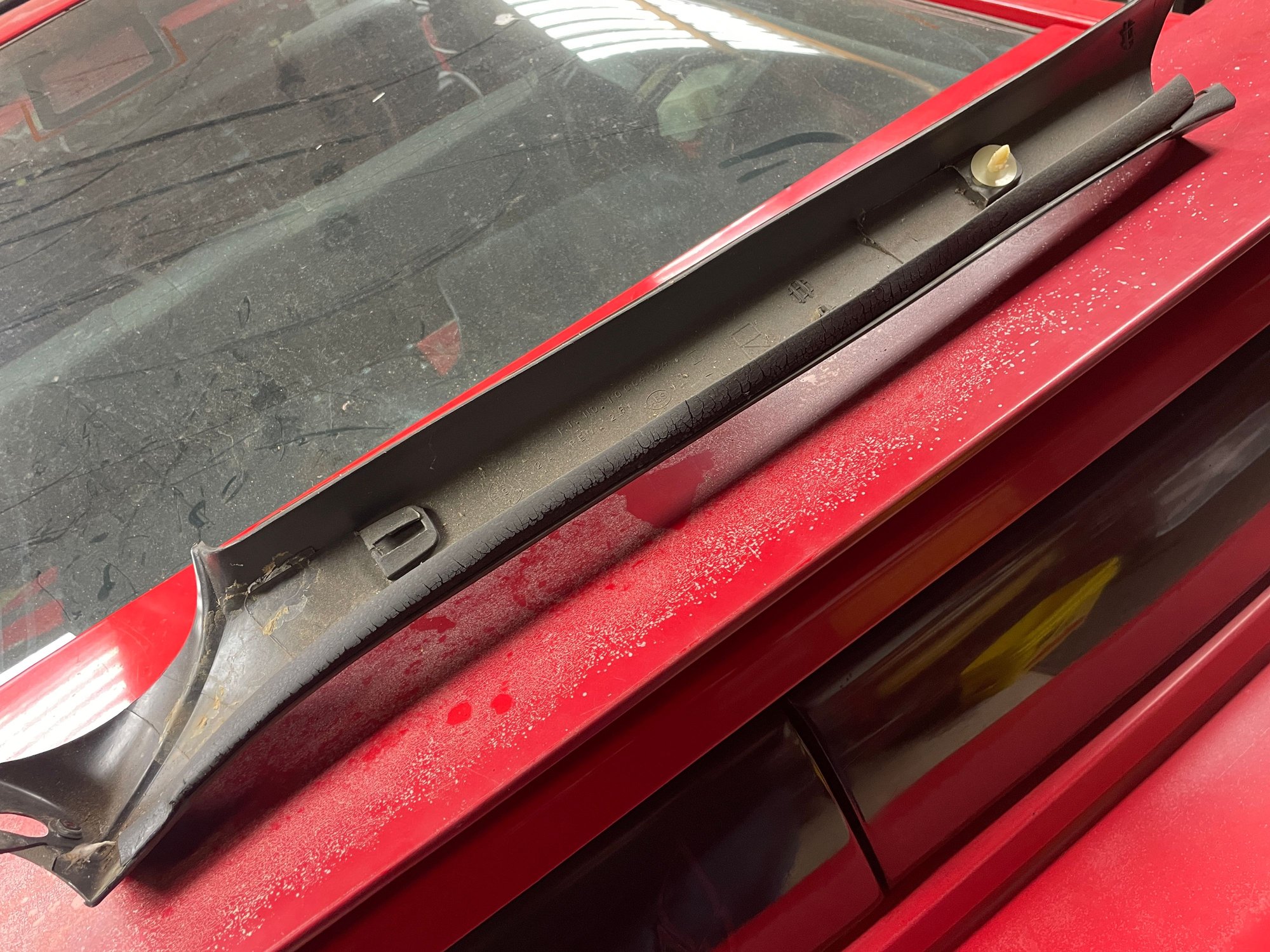

Update:
Finally got the weather stripping in and installed and I’m more than happy with the results, this weather stripping fills the gap really well.
I cut a short piece off to see how it’ll fit on the A pillar plastic cover.
Pass. Side with the old brittle cracked weather stripping
Old Jan 3, 2022 | 09:15 PM
DynoDave43's Avatar
Posts: 4,840
Likes: 921
From: MICHIGAN
Axle/Gears: 10 Bolt 2.73 Open
Until this last set of photos, I didn't really understand what you were doing, though I was following the thread with great interest.
Thanks for posting your results!

The angle on it takes a little getting used to, but it's definitely better looking. I'd like to get something flat-ish like the oe part.
