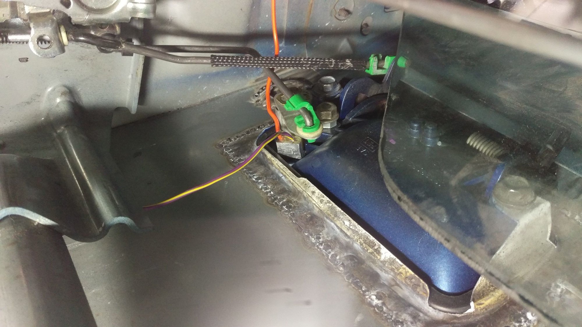

That part goes on the handle, the two little donut shaped one are for the latch itself. Most 3rd gens dont have the donut, but it can be used. I think its mostly to keep rattling away.
Anyway, the rod goes on the latch first, then on the door handle, that clip swings down and clips onto the rod. Nothing technically keeps the rod on the latch. Not stock handle, but the linkage is stock configuration.
