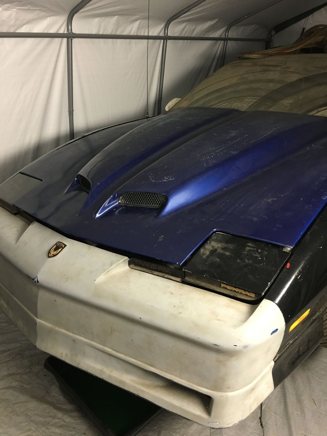

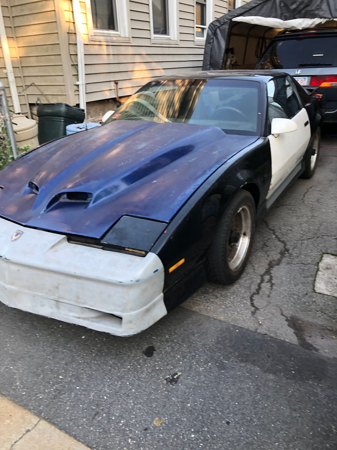

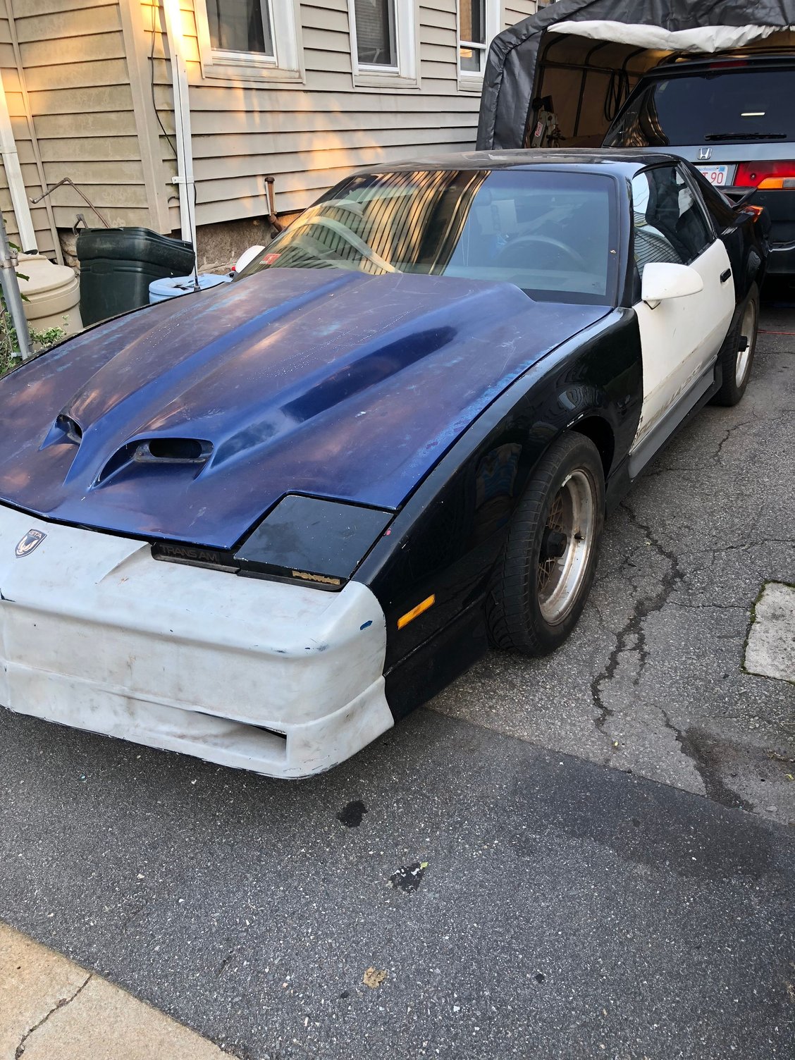

Ok everyone I been gone for a great while. I was in the fiero world lol I had a 3800sc 4 speed fiero that went amazing but enough of that im here to get back into the front engine rear wheel drive layout of the Pontiac world. I currently have a 88 gta trans am true Y84 car. I don’t have the original L98 with 700r4 anymore that dinosaur crap is gone. I do have a 4.8 LR4 I think that’s the code for it. I’m looking to do a whole restore on this car. Now I had this car back in 2012 and it’s been sitting in the ghetto garage for 10 years now clean floors, quarters, etc etc and it’s subframed connected already. I’m wondering where do I start from here with the body since it’s 3 different colors. Hood is a 98-02 ram air style hood that is blue, original doors were rotted but got a clean set off a 88 formula those are white power mirrors are hunter green. Where should I start on the body from here. I plan on making post in the LSX SWAP section on where to get that all situated. Thanks for reading and please any info will help

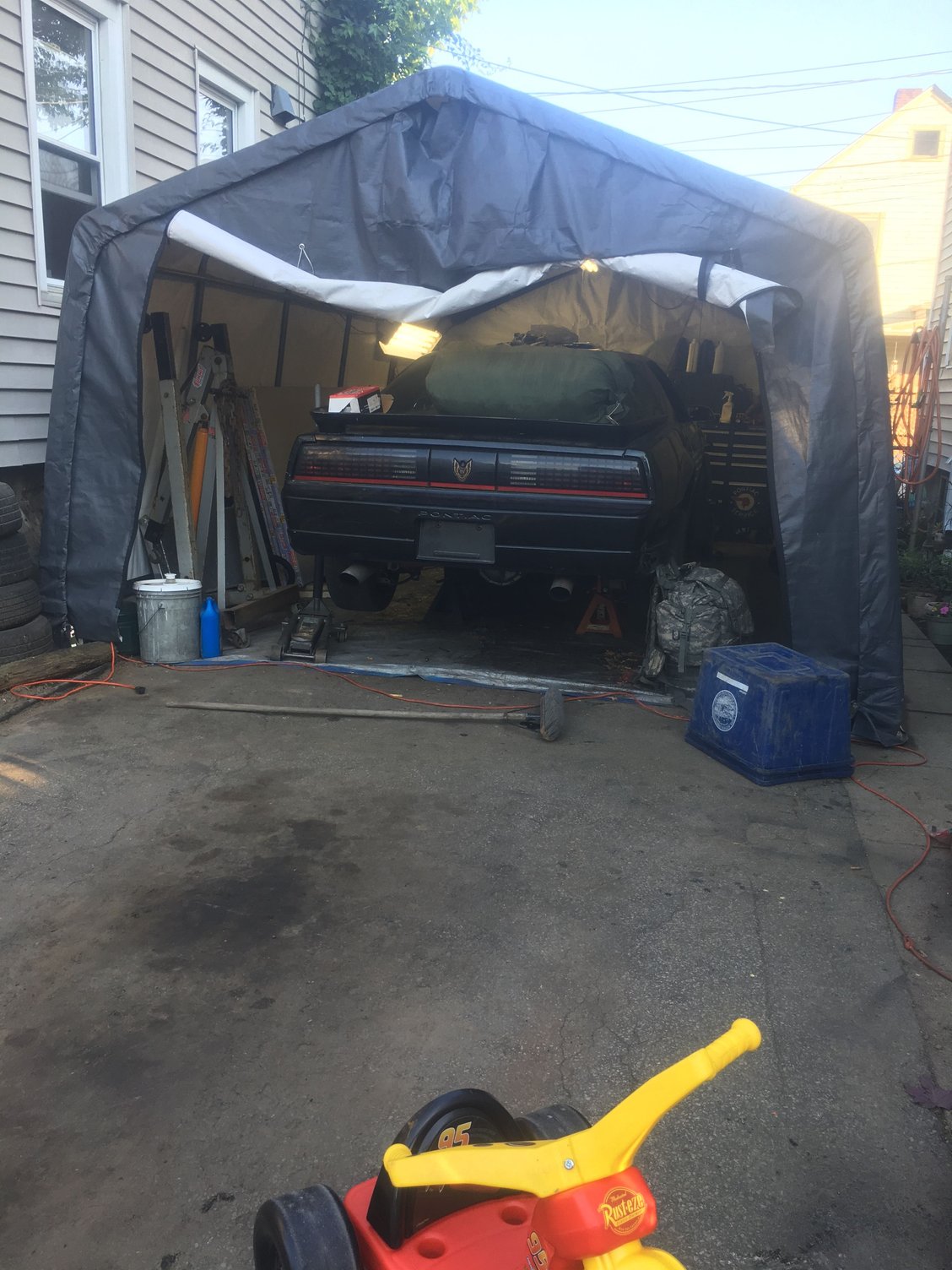

Good call on the black, but I'm a little partial...It does take a bit more prep, but well worth it in the end.
Good luck with the garage, looks like you have a solid plan. You're only POR15 over bare metal, or current rust, correct? It's not going to do you much good over existing paint. I'm not even sure it makes a great replacement for E-coat, if there is no rust to coat. That stuff is like a rock when it hardens. You may be better off with a wash primer/etch or epoxy over good bare steel.
BC/CC is a much better choice and more forgiving than single stage, and it's not that much more expensive in the grand scheme of things. You can make a single stage job look great, and modern urethane's will give you a nice finish for years...but you will still deal with oxidation, and work harder keeping it nice, over a BC/CC finish. (If it's not a daily driver, and will be stored in your new garage, that's much less of a concern, however)
Keep us posted, I'm sure it will turn out great.
