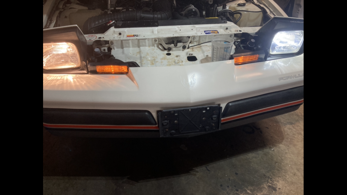

Started to work on a LED conversion for my headlights.
Used Hella H4 conversion bulbs and some 100 watt (50 watt each) LED H4's.from Amazon from Seallight. The Sylvania silverstar headlights are rated at I beleive 55 watts each so these draw slightly less power..... hope therws no issues!
I used the Seallight 9005 and 9006 on my Camry and they are excellent at night. the 9006 i use are rated at 20,000 lumens.
These H4s are rated at 18,000 Lumens

Passenger side is the stock halogen from i believe 1987. Its not a silverstar H6054.... I had those in my truck but they blew out within a few years......
Driver side is the new LED / Hella adapter
