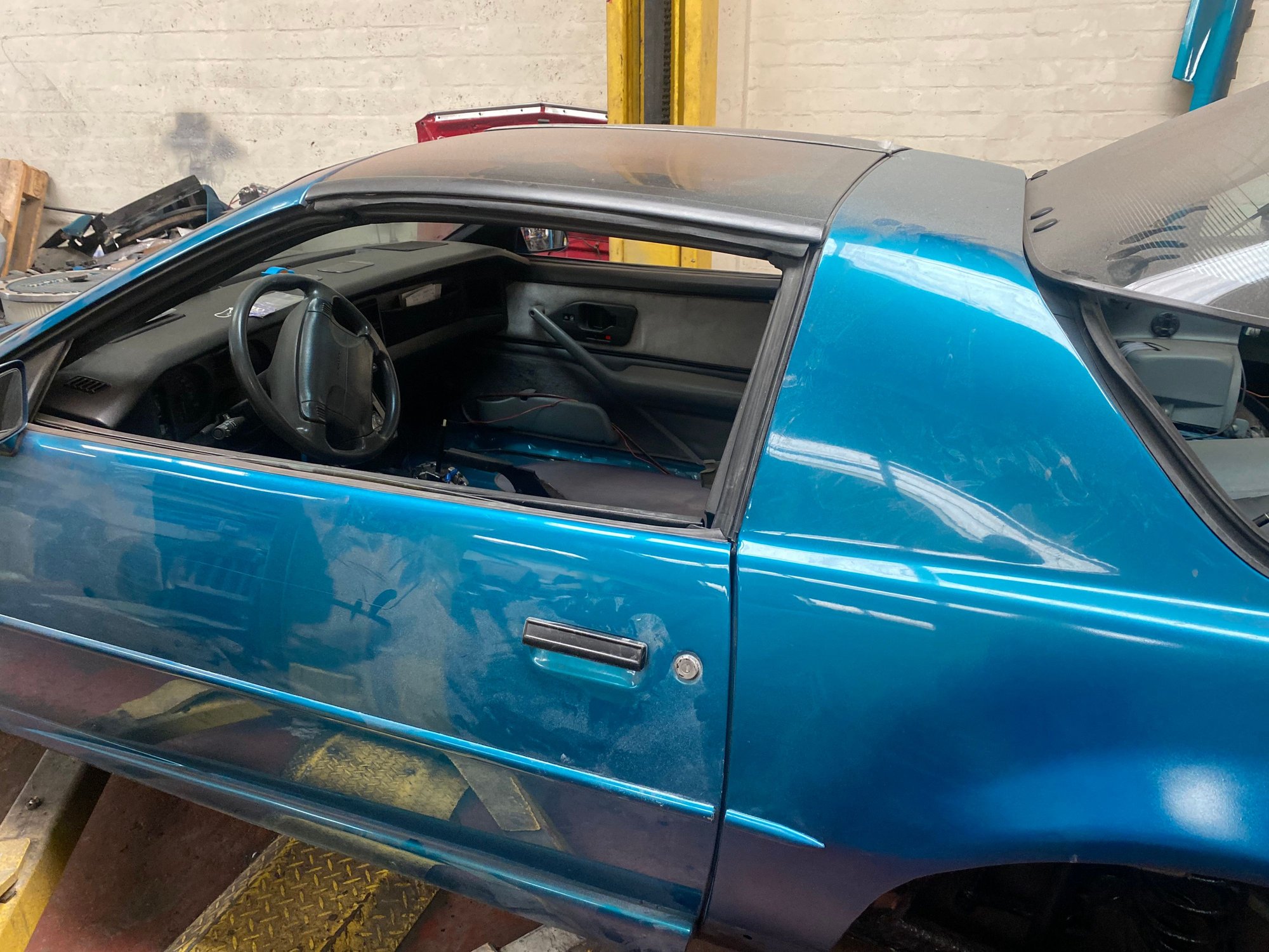

  1. What do you think (looking at the picture) that my car’s colour code is? Is it the ‘Dark Bright Teal Metallic’, is it the ‘Bright Aqua’, or is it the ‘Maui Blue’?

Your paint appears to be 37U or 9238....
So you bought the right color.
The RPO sticker in the center console should also say 37U.
You'd get a better match if you went to an auto body supply store and had them mix you up a quart. They won't custom mix it, but it will match better than that.
Also, the paint on your car is 30 years old, unless it's been painted at some time...

Looks like 37U Dark Aqua/Teal. Not an easy color to match even with professional paints and off the shelf spray cans are typically terrible for color matching. If you still have the RPO sticker either in the center console or on the inside of the locking compartment in the trunk, there will be a WA number on that which will tell the paint shop what color it is so they can mix it for you.
Some paint supply shops can do mixed paint into a spray can, but that's only economical for small repair areas. For what you are doing, you'd be better off spraying it out with a paint gun.
