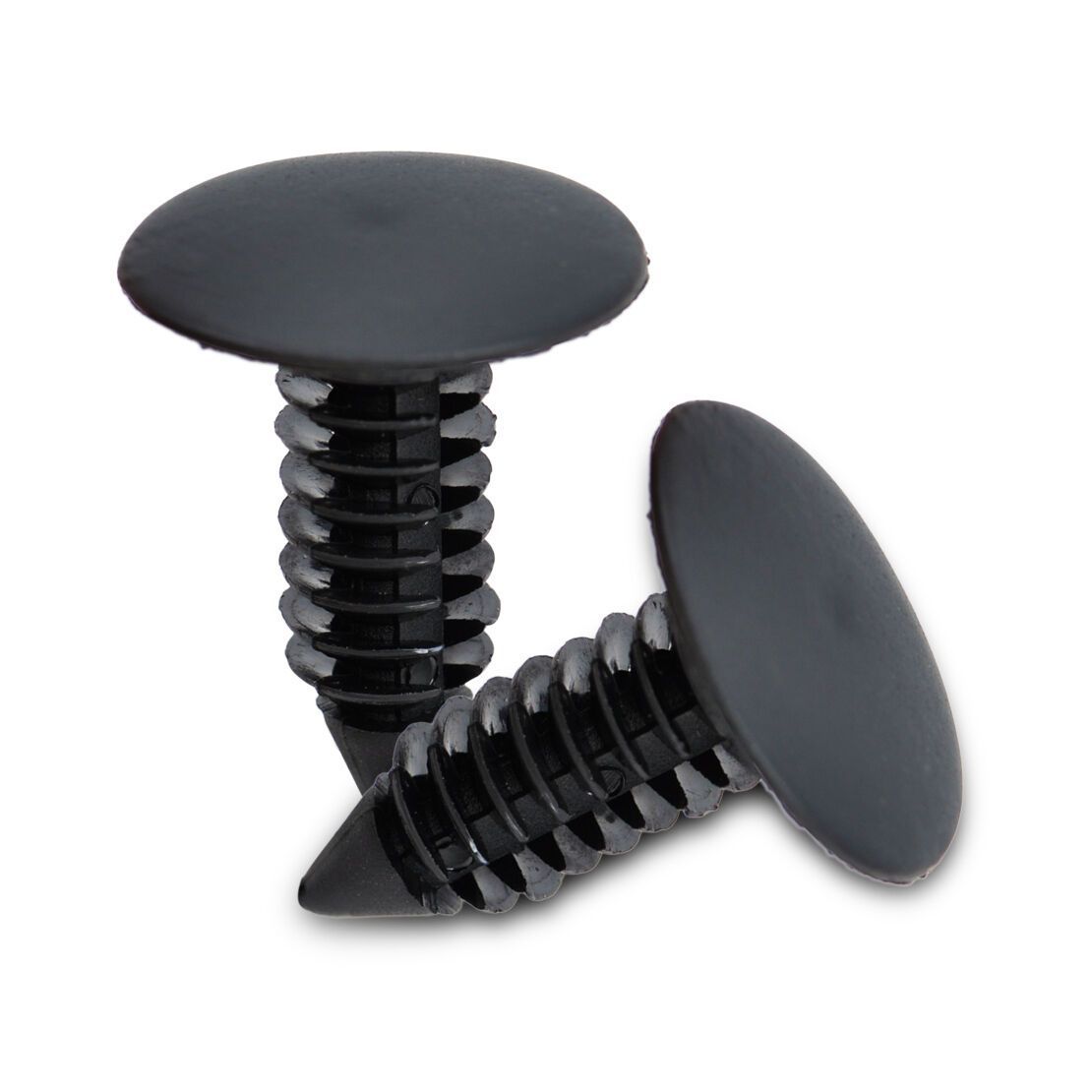

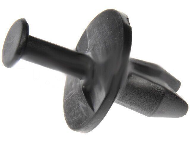

3rd gen camaro looking to know what clips where used from the factory. I've seen so many in these cars, working on 1992 hole is 6mm. I personally think the last style is the cleanest but you will bend the fender trying to removing because there are oversized where those christmas tree style the original clips?

My 87 and 89 had from the factory, a combo of the 3rd and 4th pic. The 4th type was used on the bottom closer to the ground while the rest was all the 3rd type of clip.....I changed it al lto the third because those are much easier to install and remove.

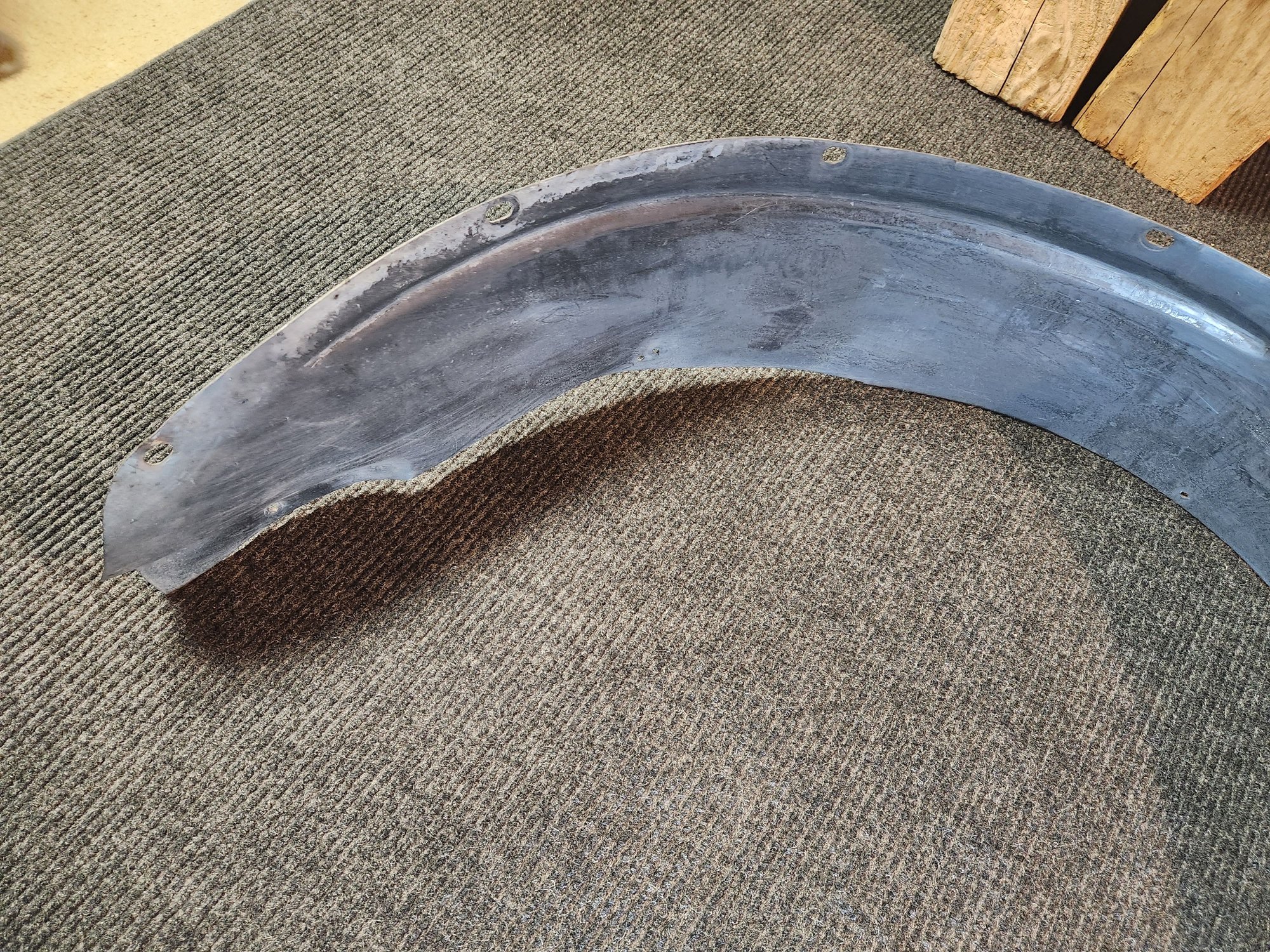

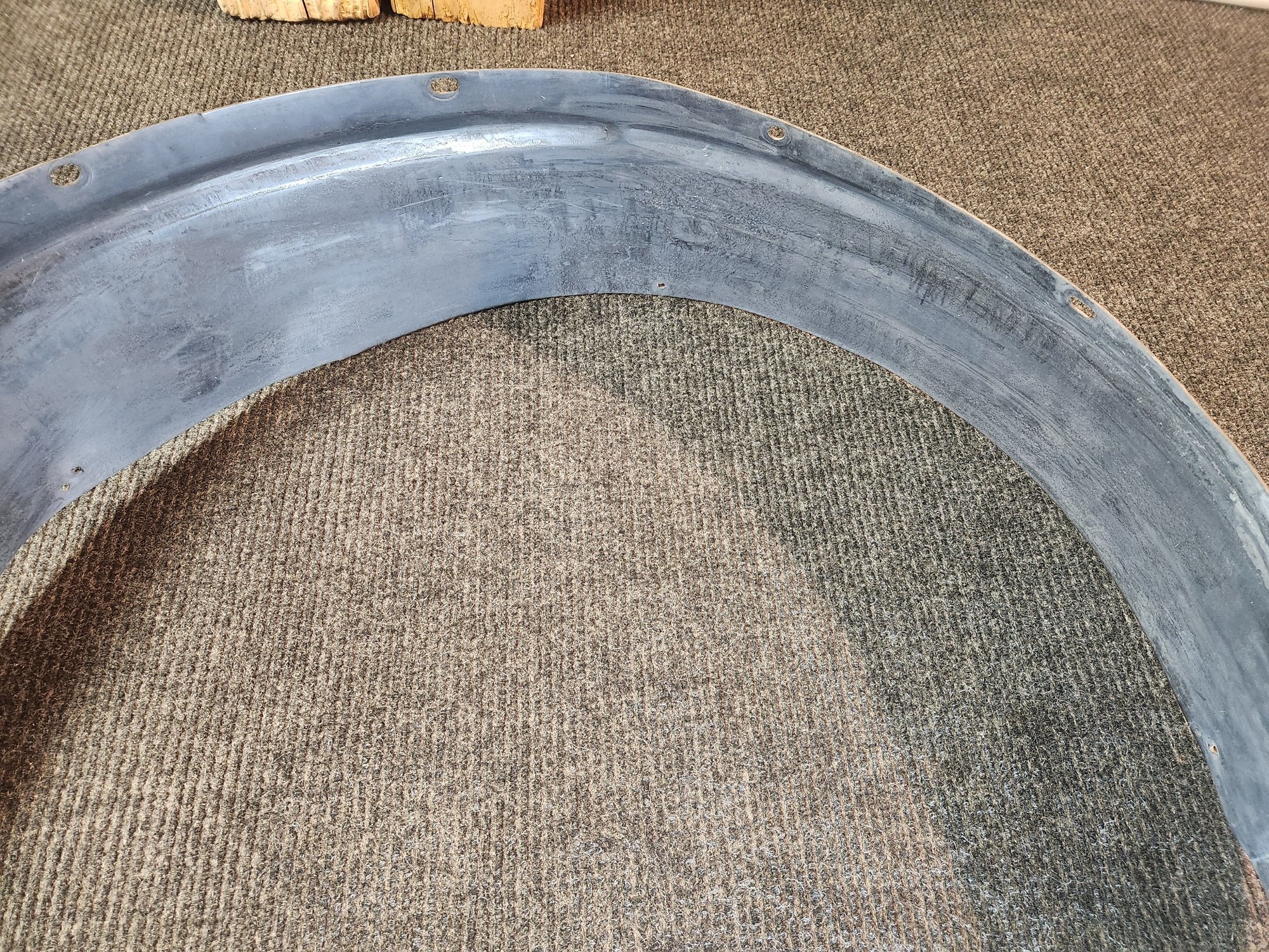

Originally Posted by BHR
I dont have any notches pretty sure the liner is original to the car
sorry for the old photos, 1992 liners. I also have a nos set just like them. You can see the notch on the front and rear about 4 screws up. From my understanding, it was for tire clearance.

Yes, camaro's differ from FB. The outer clips to fender are the same type as used on the plastic cover thats under the hood between the headlamps. Its a smaller version of the 3rd pictured in the first post. The inner holes on the liner used the same type 0f 7mm screws as used throughout the car inside/out.. Those srews had little rubber caps on the topside, so you wouldnt poke yourself when working near them.
