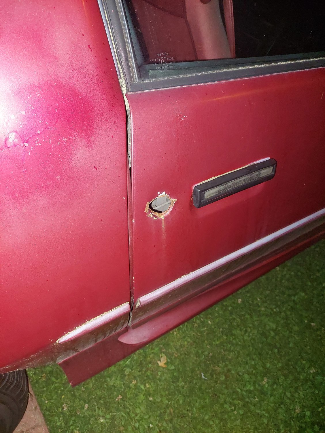

Door lock cylinder hole was destroyed when some Jacka$$ broke into my 91 Camaro RS. What options are there besides replacing door. I was going to delete the hole and use keyless entry.
Looks like someone used a screwdriver and a hammer.

A good body man can fix that.

1. You can kinda massage it to fit a nw lock cylinder
2. Body shop, they'll likely do the same as 1 but better than what most home mechanics can do
Requires more paint / work:
3, Cut out that section and weld a new section in place from a donor
4. Weld the hole shut / cover and do lock less / remote locks.
